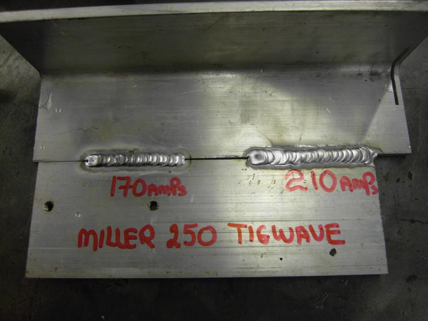

    I just tried my welder on 1/4 alum. plate did not clean just set to 210 amps and 170 amps it weld just fine see pic. I used a 210EXT at Everlast CA as a test and it welded 1/4 plate just fine something must be set wrong I have see the wires from the electric box have the wires wrong and different voltages and not a good ground or common not grounded right.
