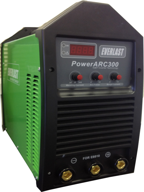

    didn't you just order the 300; i remember because you got it wrong that time too. p30 i think you referred to it as. now you have a 130. maybe you could take a moment to look at the machine, maybe a picture, so that we would all be on board with what machine you are actually on.
    He's got the PowerARC 300... We all make mistakes.

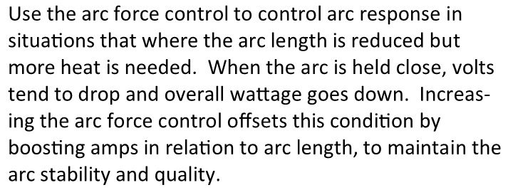

ID:	9089 Arc force from the manual>Click image for larger version.
Name:	arc force.jpg
ID:	9090 Source: http://www.everlastgenerators.com/do...ST-160-200.pdf
    that's true and i make plenty; he ordered the unit on new years day, a P30; we are now talking about a P130; but i think what he's really talking about is this.

    Since that is clarified...Pushing in, will boost the heat for you. A high spatter bead? What type of electrode are you running? Size? Amps? Likely if you are getting a high spatter bead, you are holding too long of an arc gap. Turn the heat down, keep a tight arc, and turn the arc force up (in general)

    Once the voltage drops below about 20 V (approximately) due to a short arc length, the arc force initiates and boosts the amps in relation to the amp setting of the machine. Burying the rod would actually increase the heat. But if you are trying to push in to cool the weld off, then you are welding too hot. YOU DO weld with the arc force activated a lot on an inverter. IF you are having a hard time with the arc force, then it is technique, or the amp setting you are using, because we have lots of guys with these that enjoy them without any problem. I've used them a lot as well. What were your settings and rod brand and size of the 6011? Are you stepping the rod or weaving?
