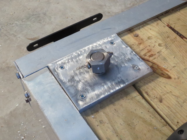

  1. Default new vice mount on truck / last three pics
    last three pics.

    Nice little project,,I have almost the same type of vise,,,very handy for positionng stuff so you can grind or weld ,,,much better that those old record type,,, I see you have a mag drill,,I'm about to spring for one myself,,,an MD 45 0- 350 rpm,,,not sure if that is the right speed range,,,but the price seems right and I like the varible speed idea cause I'm gonna use it for line boring some day..
