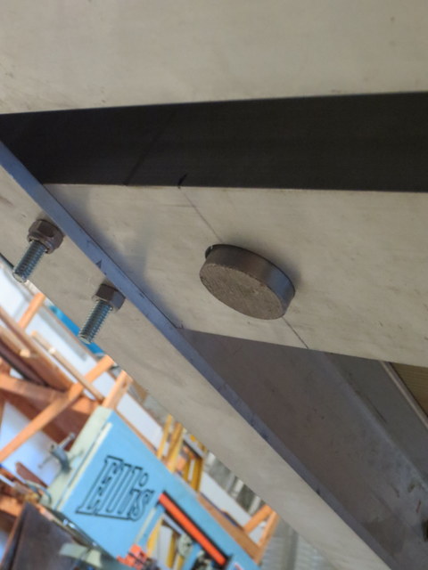

  1. Default new vice mount on truck / last three pics
    last three pics.

    Nice little project,,I have almost the same type of vise,,,very handy for positionng stuff so you can grind or weld ,,,much better that those old record type,,, I see you have a mag drill,,I'm about to spring for one myself,,,an MD 45 0- 350 rpm,,,not sure if that is the right speed range,,,but the price seems right and I like the varible speed idea cause I'm gonna use it for line boring some day..

    the milwaukee has eleven inches of travel. this can be important. it will also take a two inch cutter. if you notice in the photo i am cheating with the short cutter chucked up in the chuck. i had to put that one inch plate underneath it and also drill a 7/32 pilot hold in my piece first so that the centering point would be able to move down through the part while i was cutting. chucking up the cutter like this is definitely not recommended but you know how that goes.
