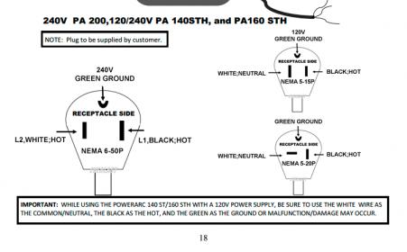

    Errors:
    Page 15: "The foot pedal allows full range of amp operation and the panel AMP knob is not overridden when connected."
    The word not should be removed as the panel amp knob is overridden by the pedal. Or the word overridden could be changed to functional. I suspect someone was thinking along those lines and just got things transposed. Pick one.
    While the plug on page 19 is specified, on page 18 the drawing attempts to use one diagram for both 120V and 220V wiring and labels the plug 30-50 amp. The drawing is clearly a NEMA 6-50 and that is a very different plug from either a 5-30 or a 6-30. Several people have been confused about blade widths and which is the neutral blade. This is somewhat understandable because of the diagram, and the standard convention of swapping wide and narrow sides between 120 and 240 volt plugs. Perhaps it would be better to split this into two diagrams, one for 120V and one for 240V. Then you can show the proper plugs. NEMA 6-30 is so uncommon I would not even bring it up. Although it would be a great choice for some of these machines, anyone that would select it will probably know how to use it. I would say the two plugs to diagram are the 6-50 which is shown and a 5-15 / 5-20 for the 120V side. I think this would handle over 90% of users. While the 5-20 is the preferred plug, the 5-15 is so common and can be used in 5-20 outlets, that I think it has to be included. Here is an example of all three.

    Of course it sounds like some of this will be moot if all the new welders are going to ship with plugs installed, and adapters included for dual voltage models. That in itself should be cause for an update of the manual, though.

    The manual will be updated for specification changes/additions coming on the PowerArcs in the next 6 weeks or so. The error with the word "not" had already been corrected in the master copy. But a 6-30 is NOT uncommon as nearly every single 6-50 amp plug comes this way with a 6-30 sideways slot and additional blade for adaptation, so the 30-50 amp is correct as that was cited directly from the packaging of the plug. But I don't see a work in progress here. One error, and one need for clarification. The way you put it, it sounded as it was not very reliable and needed a lot of work.
    Edit: Changing to "not functional", would not necessarily improve the meaning. In fact it makes it sound like there will be no amp control at all. In an effort to be concise and work with limited space, the "overridden" would be correct. When anything "overrides" it takes control.
