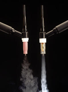

    This picture shows the only difference Click image for larger version.
ID:	9022 (gas lens is on the right).
    Less turbulence gives better coverage and lets you reduce gas flow in normal use.

    So it would actually benefit me to change over to a gas lens setup in order to possibly save shielding gas (as well as gain the other benefits), or is the gas flow reduction really minimal? I noticed that the cost of the gas lens parts are quite a bit more than the "normal" torch parts, and there's no sense in spending money (I don't have) on things (I don't need). Are gas nozzle sizes equivalent between regular gas nozzles and nozzles for gas lens applications? In other words, if I use a regular #6 cup and swap over to a gas lens setup, would I use the same size #6 (with all other things being equal)? Sorry for the dumb questions (hey, someone has to ask them!). My curiosity is running wild right now and all these questions are coming to mind. Thank you for posting the photo, it shows the obvious difference between both gas nozzles. I seem to respond to visuals better than text.
    You can usually reduce gas flow by 1 or 2 lpm on a #5 cup.
    CK says up to 40% but in my opinion, real world every day use is around 20%

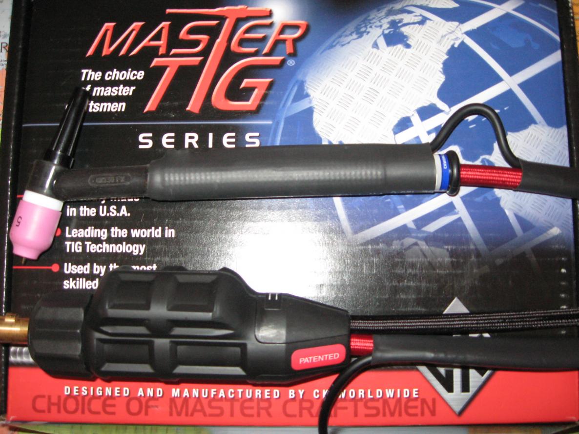

    I like the CK torches and wedge collets but I use generic gas lens parts.
    Gas lens parts are pretty cheap at http://www.weldingcity.com/
    Here's a pic of my CK130 with a generic gas lens and #5 cup Click image for larger version.

    Thank you for the link, and the video Zoama! I'm still learning the basics of sizing torch parts for TIG, but I plan to order some various gas lens parts for my torch in the next few days. I will have to play with the gas flow when I switch to a gas lens. Not to get off topic, but how do you like that CK130 over the standard Everlast torch? I noticed you have the stubby cup, which I intend to get as well. I didn't realize my torch uses standard components that can be bought almost anywhere, so now I can order stuff online!
    The CK130 is a smaller size 9 (ck 2 series) torch that can only be used up to 150 amp AC or DC @ 60% duty cycle. The front end parts are regular size for that torch. I use it for everything in that power range because it's small, light and the superflex cable is limp like cooked spaghetti.
    Here's a link to familiarize yourself with torch sizes http://www.youtube.com/watch?v=ZNjhCZRfLio To my knowledge, CK is the only company that rates their torches at 100% duty cycle.
