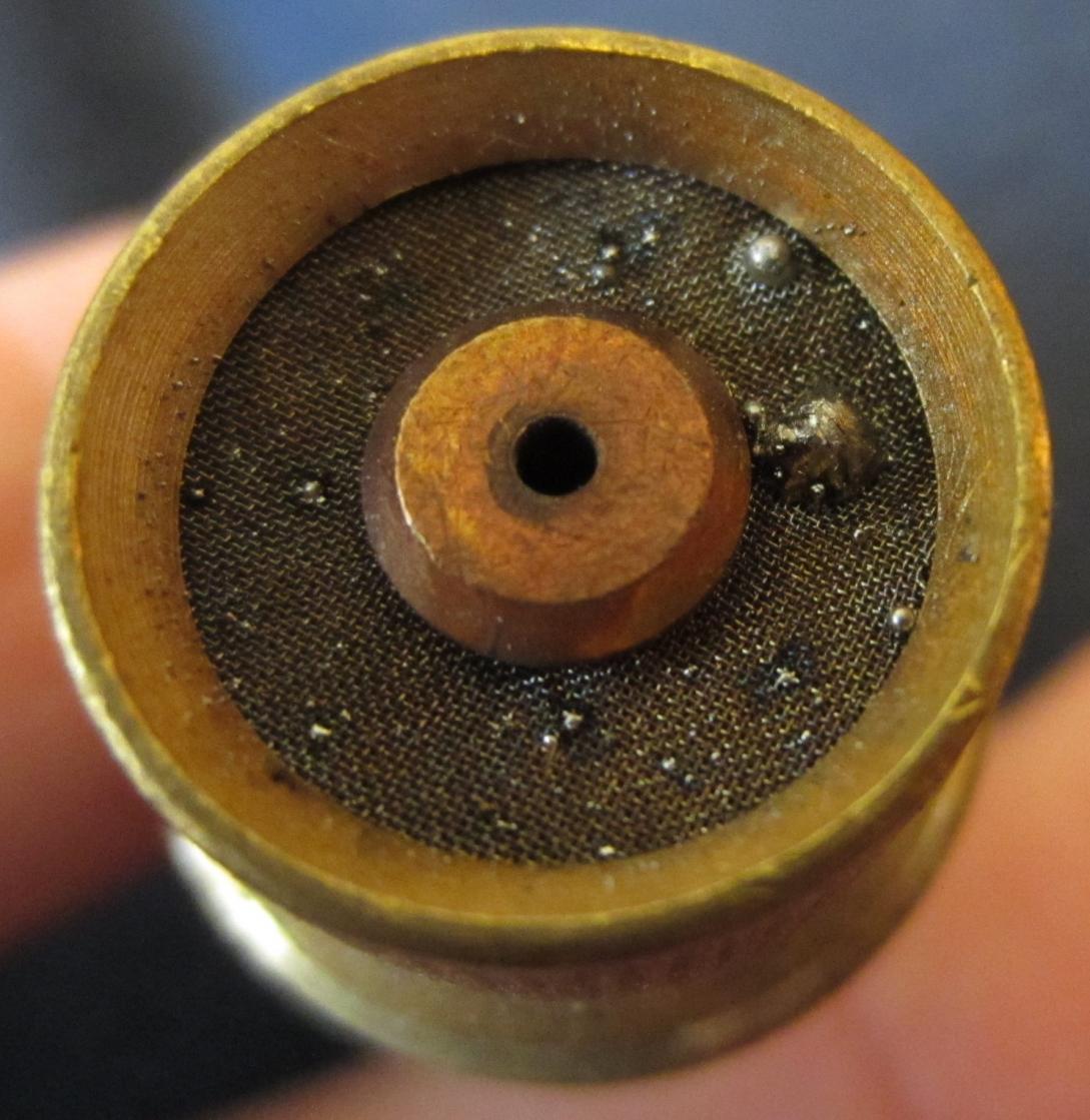

    One item that seems to come up a lot is the use of a gas lens. I think I understand what they do (ensure laminar flow out of the torch), but I'm curious if there is any downside to using one?

    No downside and the cost is insignificant.
    The only downside is that they are larger in diameter, so they won't fit in real tight places. Sometimes this can be offset by their capacity for greater tungsten stickout, and sometimes not.

    Easier to clog up then normal collet bodies I think.

    I should have rephrased that a little better. If you get any spatter from contamination, it is easier to cause turbulence because the hole in the lens are a lot finer. If you dont get spatter then there is noting to worry about with it.

    Visibility can be blocked by the larger diameter gas lens...

    Yes - there are downsides to a gas lens:
    http://www.everlastgenerators.com/fo...7233#post37233

    At $1.79 I wouldn't worry about it. http://www.weldingcity.com/tig-consu...llet-body.html
