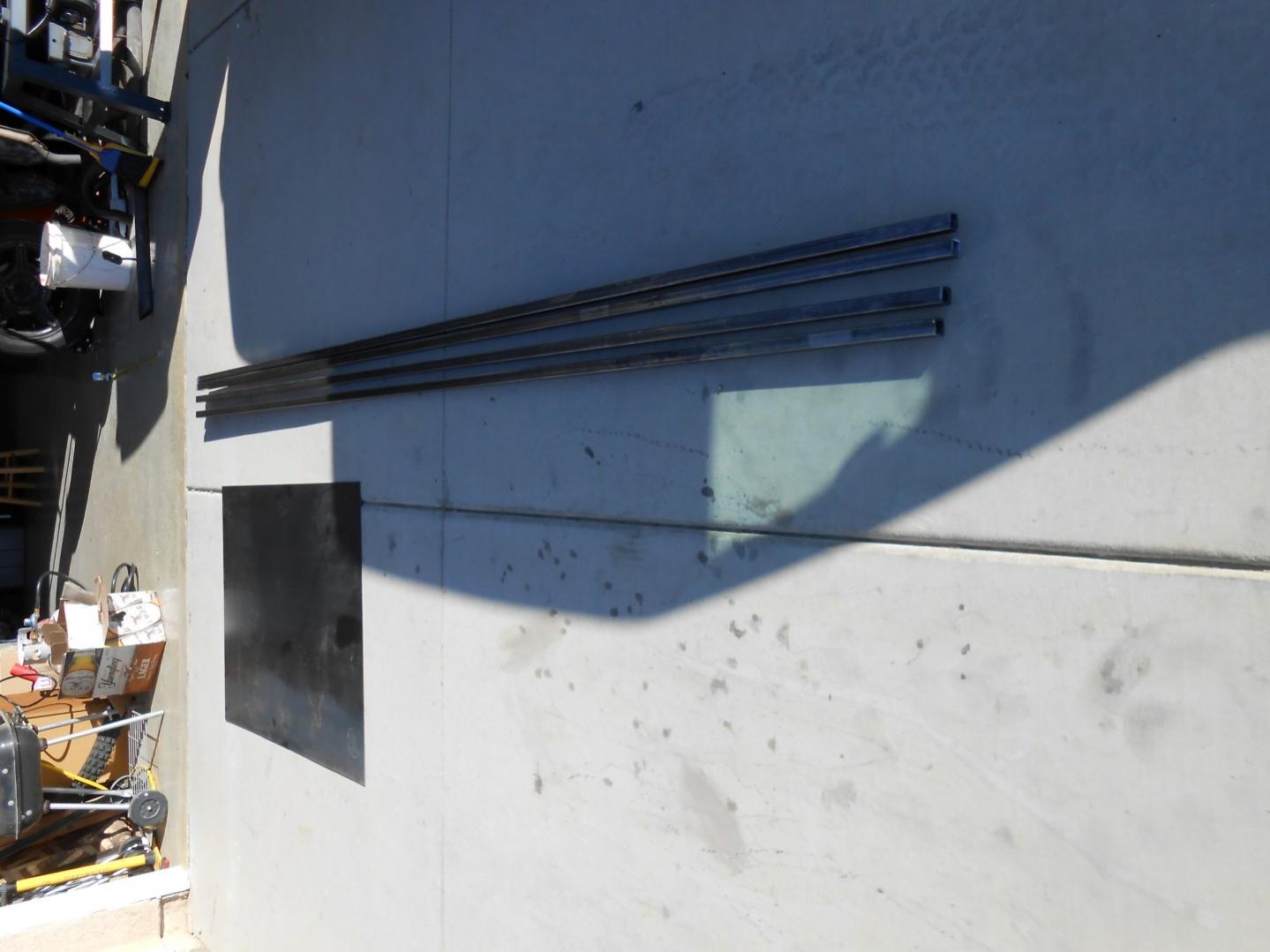

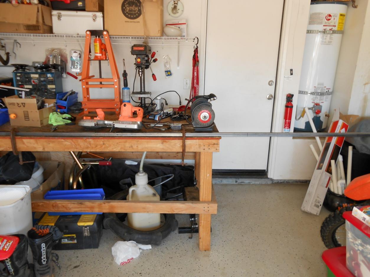

    Since I got some awesome X-mas presents I figured it was time to make myself somewhere nice to weld. I have a few wooden work benches in the garage, but I only have a small 12"x24" plate to weld on. Went to the metal supply store today and spent 62 dollars for 2 20' lengths of 1x1x.095 square tubing and a precut piece of 14 gauge steel that was 33.5"x44". I figured that was close enough to what I wanted that I wouldn't even have to cut it. I had to stop for the night because my eyes are getting tired and once they get tired I go cross-eyed and can't judge depth anymore.
    Raw Materials: They cut the 20' lengths in half for me for free, just to make it easier for me to get home.

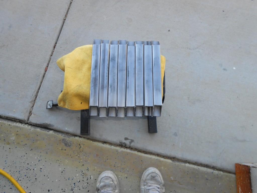

    This was my setup for cutting the lengths I need. I used a harbor freight portable bandsaw that someone gave to me a few years ago. I ordered 3 brand new blades for it during my last order, and with a new blade on there, it cut through this tube like butter.

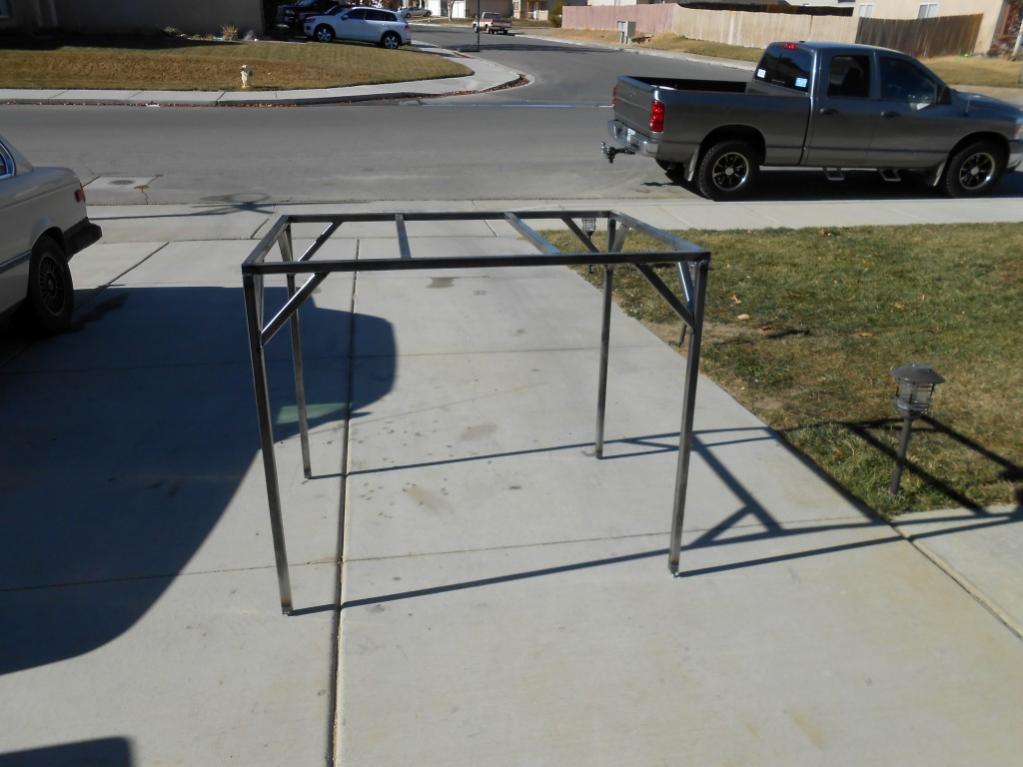

    This is everything cut to length and layed out to make sure it fits. The four tubes up top are my legs. I ended up cutting two of the tubes to 41.5" instead of 44.5" like I was supposed to. Luckily I always cut the longest pieces first and I realized this before I cut the shorter ones. I just hacked them down to 31.5" and used them as the middle of the table supports, only wasted about 2 feet of material, but I'll turn those into gussets tomorrow.
Name:	DSCN0186 (Large).jpg

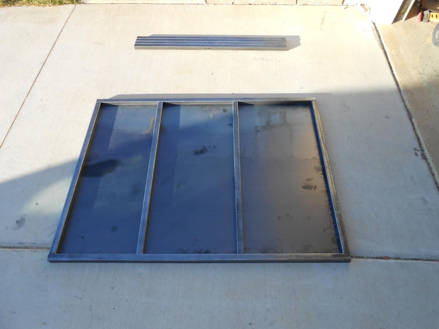

    Squared up and ready to tack together.

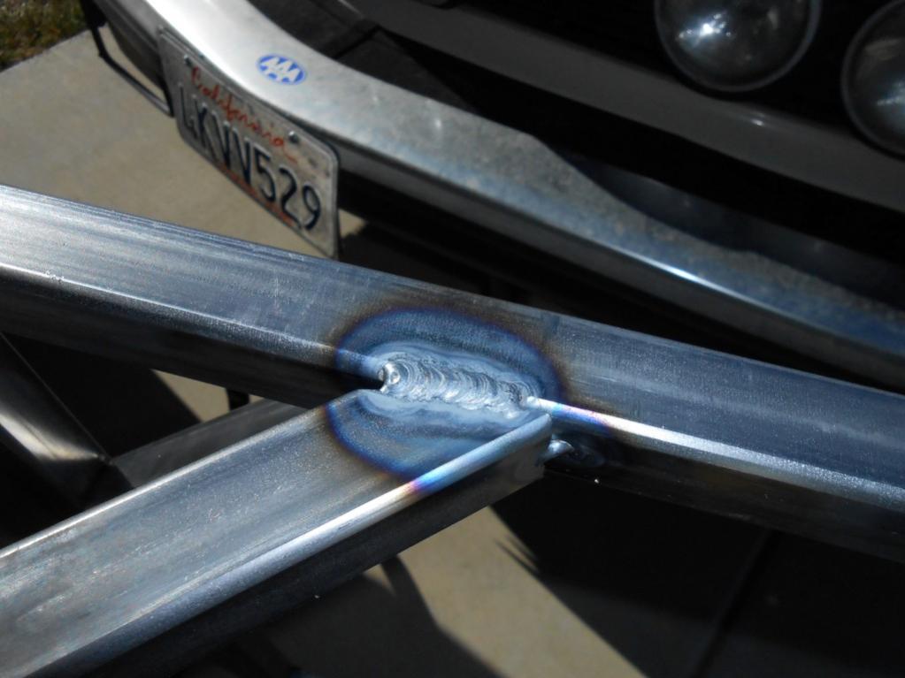

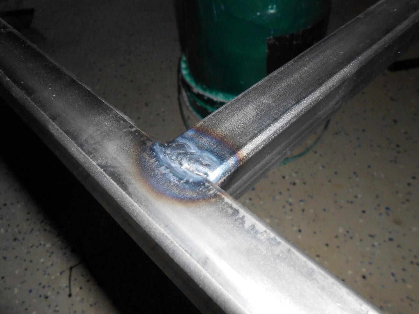

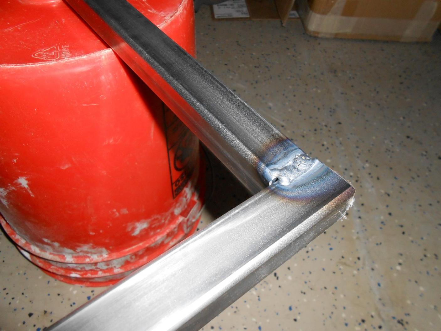

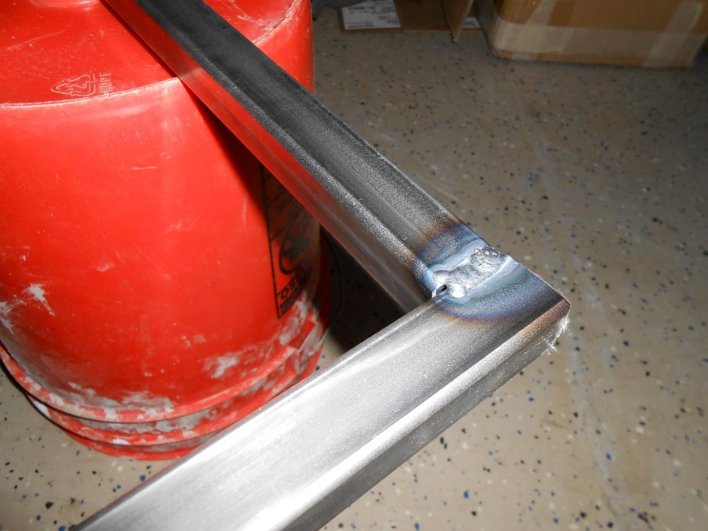

    My first welds on the project. 1/16 gold tungsten, 1/16 general purpose filler, #5 cup, 95 amps using the torch switch.

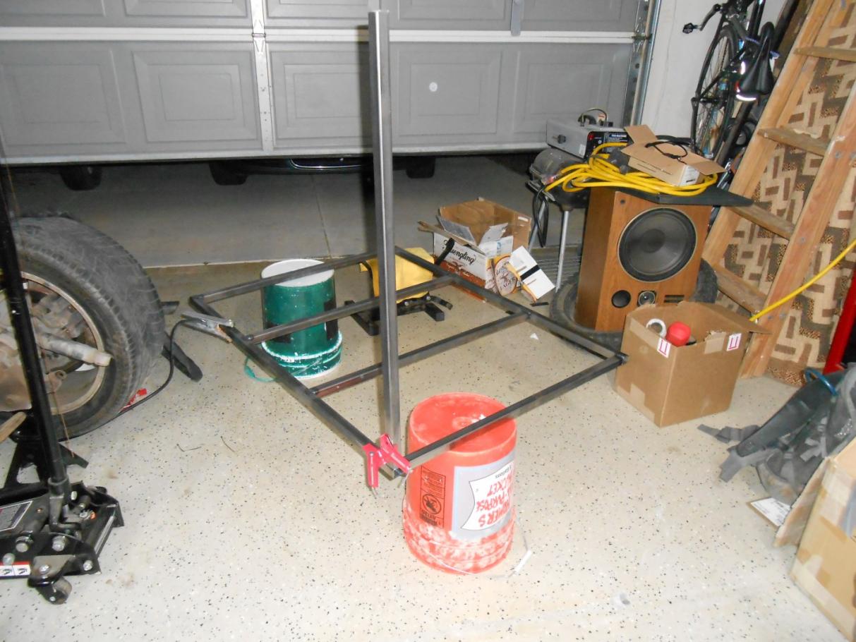

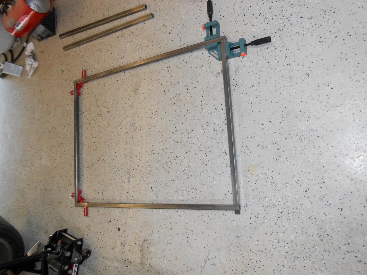

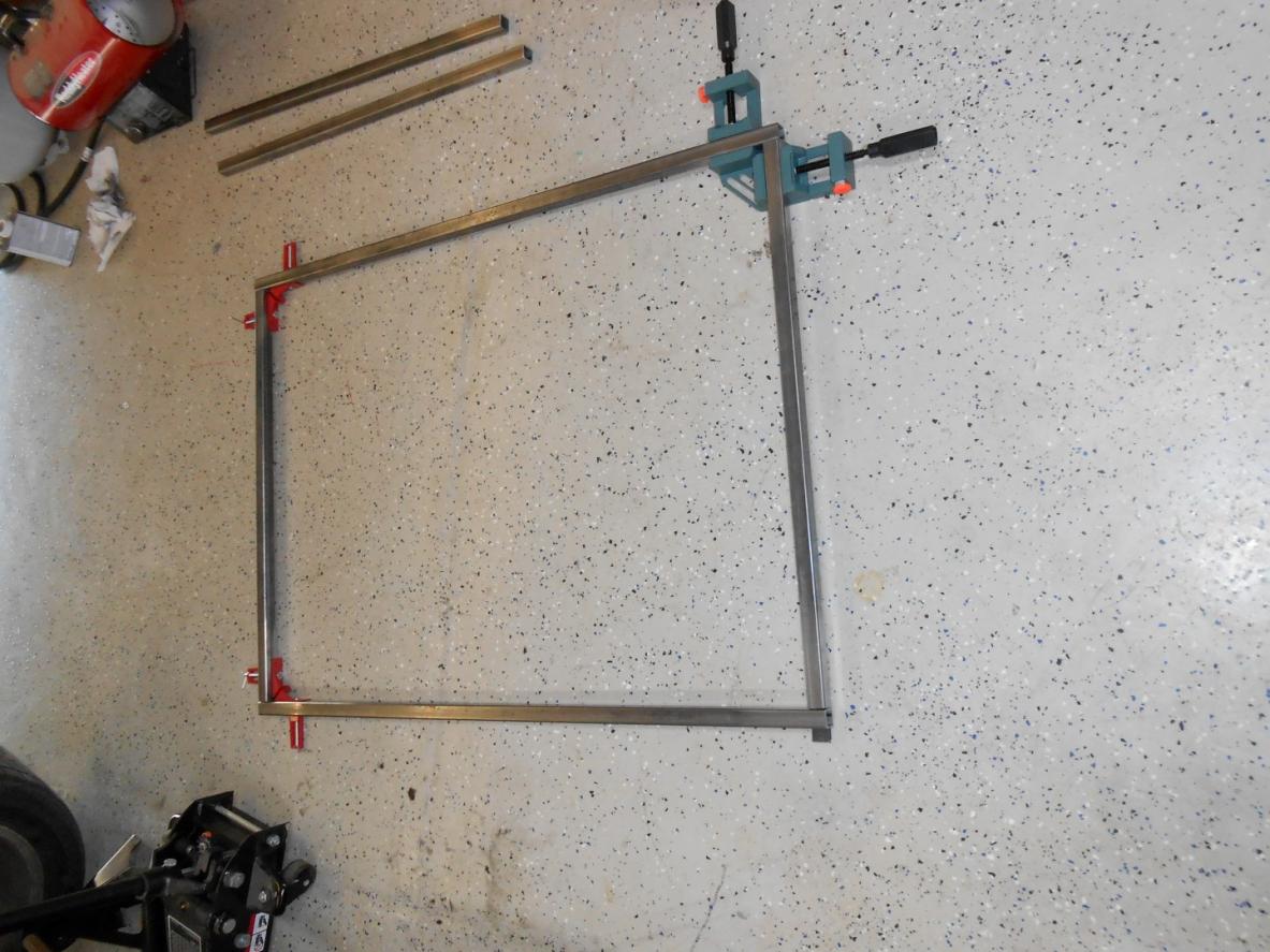

    My best attempt at trying to square up the legs. Do they sell 3-way clamps to make this easier?

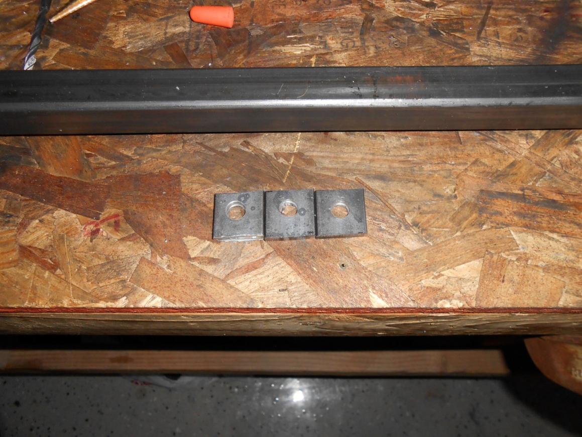

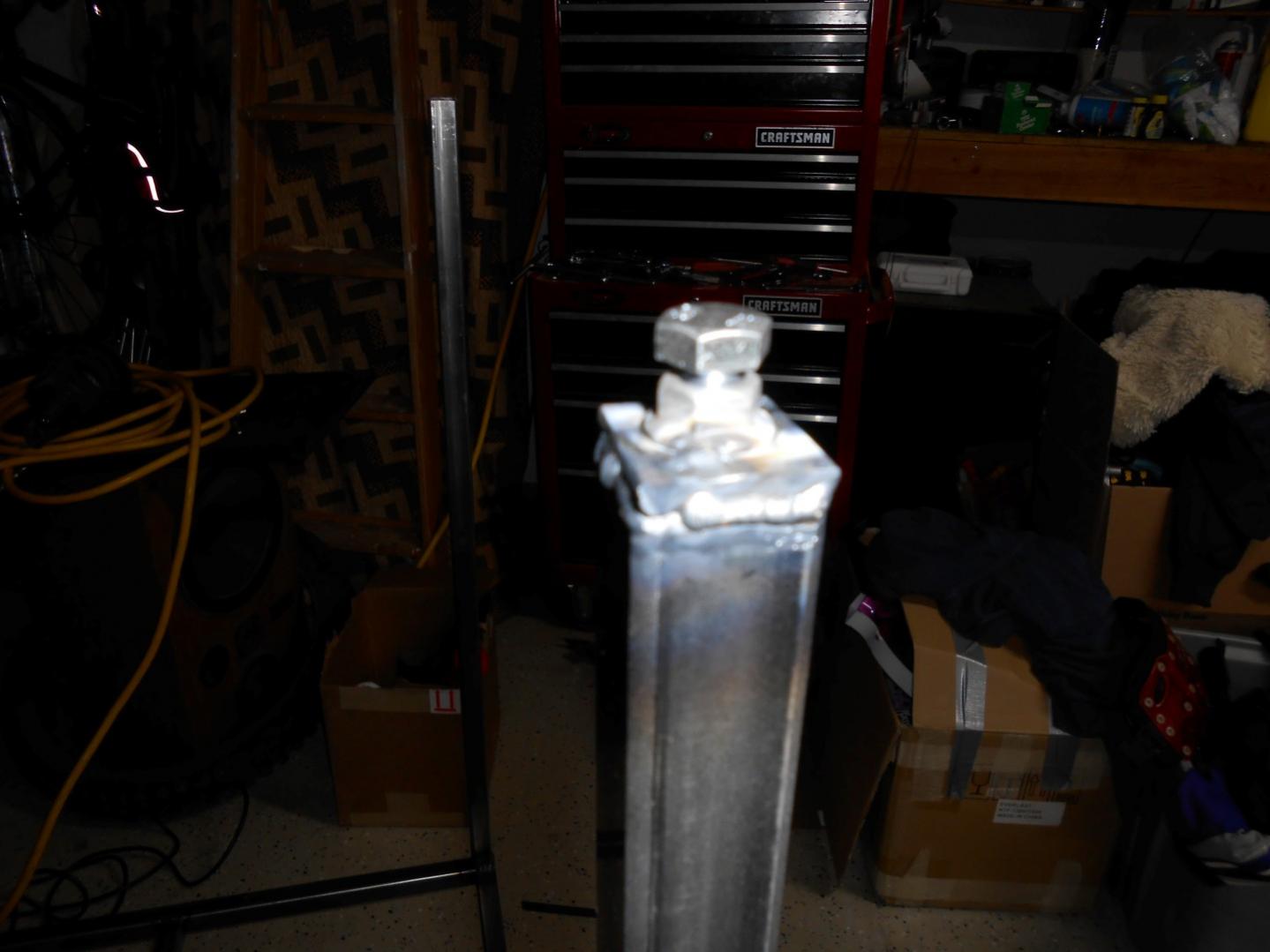

    I had some 1" stock laying around so I cut 4 pieces and drilled them out. Got one nut tacked onto the leg before my eyes went stupid. Going to put a bolt there here with a lock nut on it, that way I can easily level the table and accomodate my uneven garage floor.

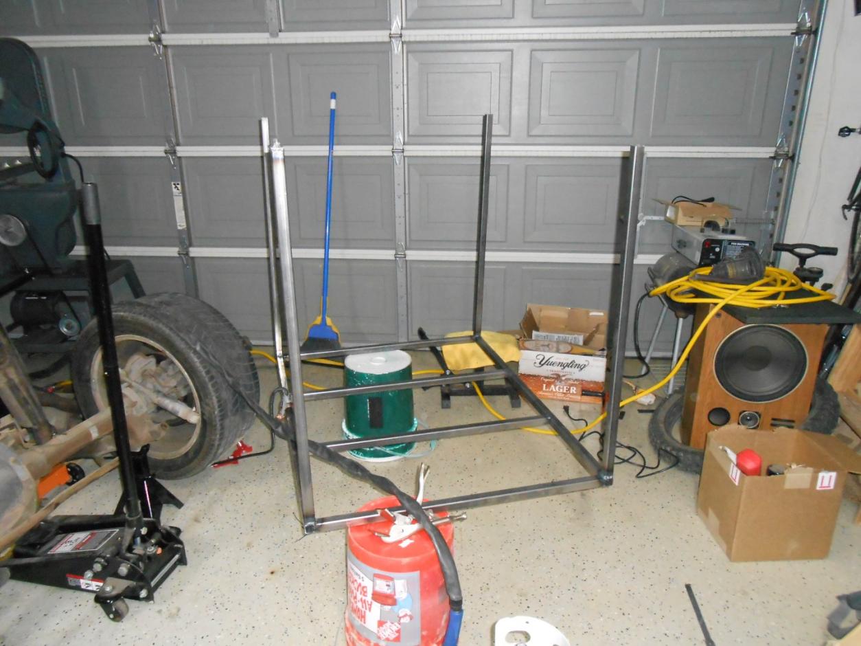

    This is the how the table stands right now.
Name:	DSCN0199 (Large).jpg
    Tomorrow I'm going to cut some 45 degree gussets for the legs and add some various other odds and ends that I won't devulge until I'm done. I debated putting a full frame around the middle of the legs, but I need the storage space underneath and don't want to fight a bar that limits access. The 45 degree gussets won't be as strong, but will work fine.

    Powertig 185
    85 amps may be better for you with the switch and you can use 3/32 tungsten for just about everything thick or thin. As for squaring, if the ends of the tube are cut square I'd just put it against the other piece and weld it. Get yourself a combination square http://www.sears.com/craftsman-16-in...81000P?prdNo=1 they come with a handy scribe for marking metal. You could also use stud mount castors on the legs that will screw right into a welded on nut and still be able to level your table. Ebay is a good source... I think I paid 4 or 5 dollars each for 5" total lock stud mount castors with a 300 lb weight rating.
    Yes. They aren't cheap, but if you do this a lot, they are a joy to use.
    http://www.weldingtipsandtricks.com/...ion-tools.html
    As a DIY project , you could add that feature to the clamps you are using, if you want.
    Sounds like you were good this year and Santa took notice! I don't know what you're storing underneath the table, but did you consider making a framed shelf to support the legs, but adding some steel dowels (or tabs and bolts) on the backside that would act as hinges (allowing you to fold the shelf down for room underneath)? Just a thought. Remove a couple of pins or bolts, then pivot the shelf down between the back legs (out of the way). Or what about boxing the sides and back of the table legs near the bottom, but leaving the front unbraced?
    For what it's worth, I use a pair of welding magnets to square legs on projects, one 90 degree magnet on one side of the leg, one on the other side rotated 90 degrees. Three way clamps can be pricey and I'm not sure that the cheap ones are worth the (cheap) cost. If I'm welding thin wall tubing, I cut the ends square with my (used and abused) Wiss airplane snips, but you certainly can't cut anything past 16ga. with those! Your table looks good Agent. I like the idea of putting things on casters too...every tool I own (practically) is on wheels for easy moving!

    I missed the part about your floor being uneven, so my idea wouldn't work well unless you setup each leg individually, or created one heck of a flat (level) table top for your welding table. I never really counted on any devices to square frames or boxes that I built, but they do help immensely while tacking. After the tacking is done, I simply pull my tape measure out and start measuring diagonals. It's surprising to me how out of square things can become if you allow even the slightest gap (or dirt/metal shavings) between the fixture and your workpieces.

    At 150 bucks each I can't see spending that for maybe one or two tables a year. It doesn't really matter to me if the legs are perfectly square. As long as it doesn't wobble I'm ok and the bolts should take care of that. I need to get some caster for my bandsaw because it always seems to be in the way, so maybe I'll order a bunch and put the table on casters as well. For now though, the bolts will work and hopefully I don't have to move it too much. I was at harbor freight the other day to get those little 90 degree clamps and completely forgot to pick up magnets. I'll have to go back and get some next week.

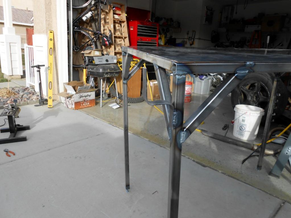

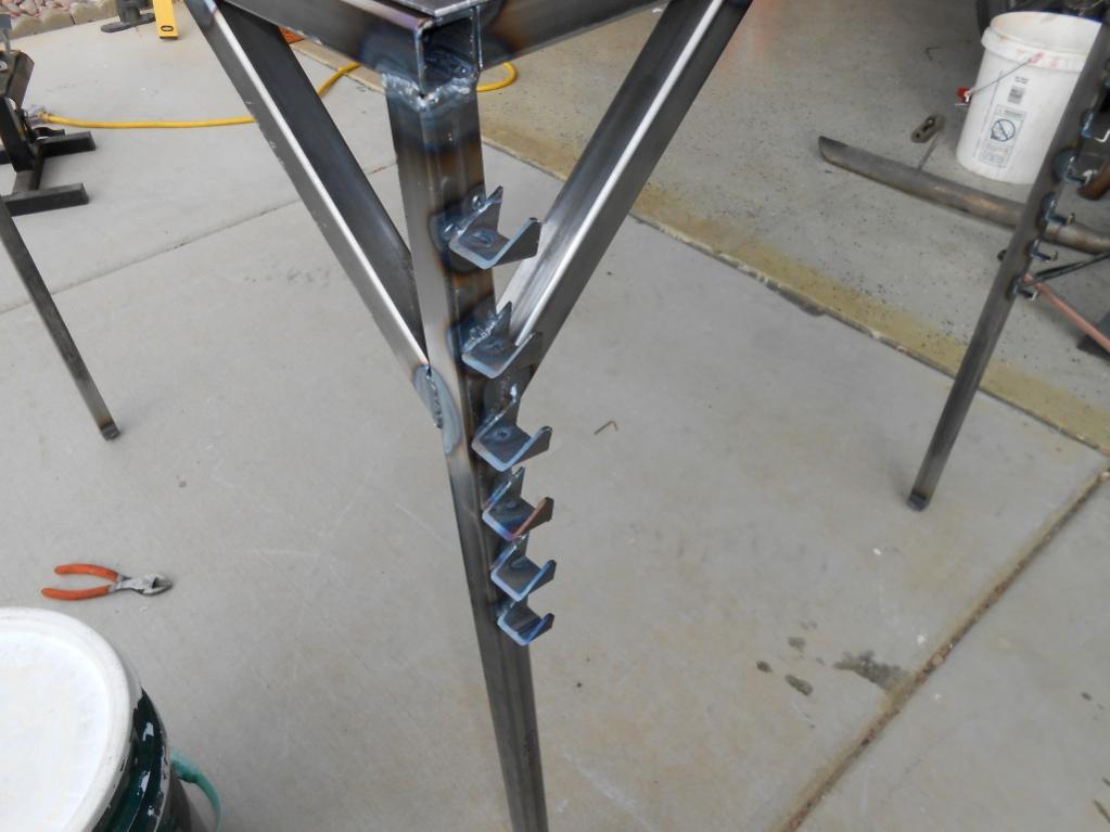

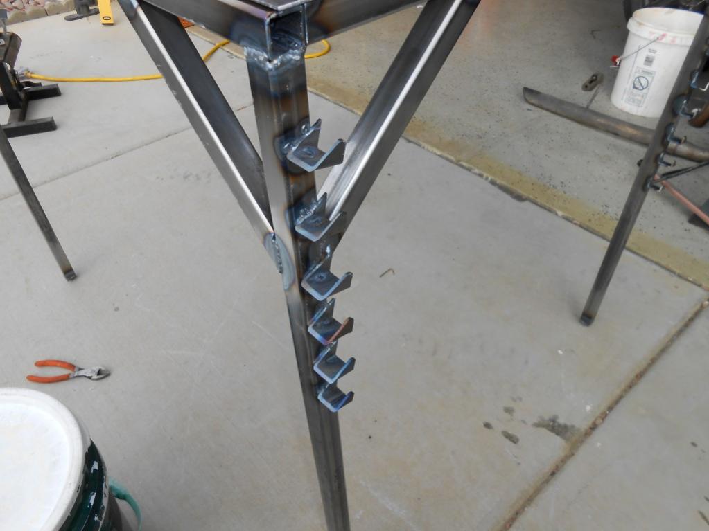

    Cut my gussets down to size. Used my bandsaw and just marked 45 degrees to cut by hand. Got close on most of them.
Name:	DSCN0200 (Medium).jpg
    Everything all tacked together.
Name:	DSCN0201 (Medium).jpg

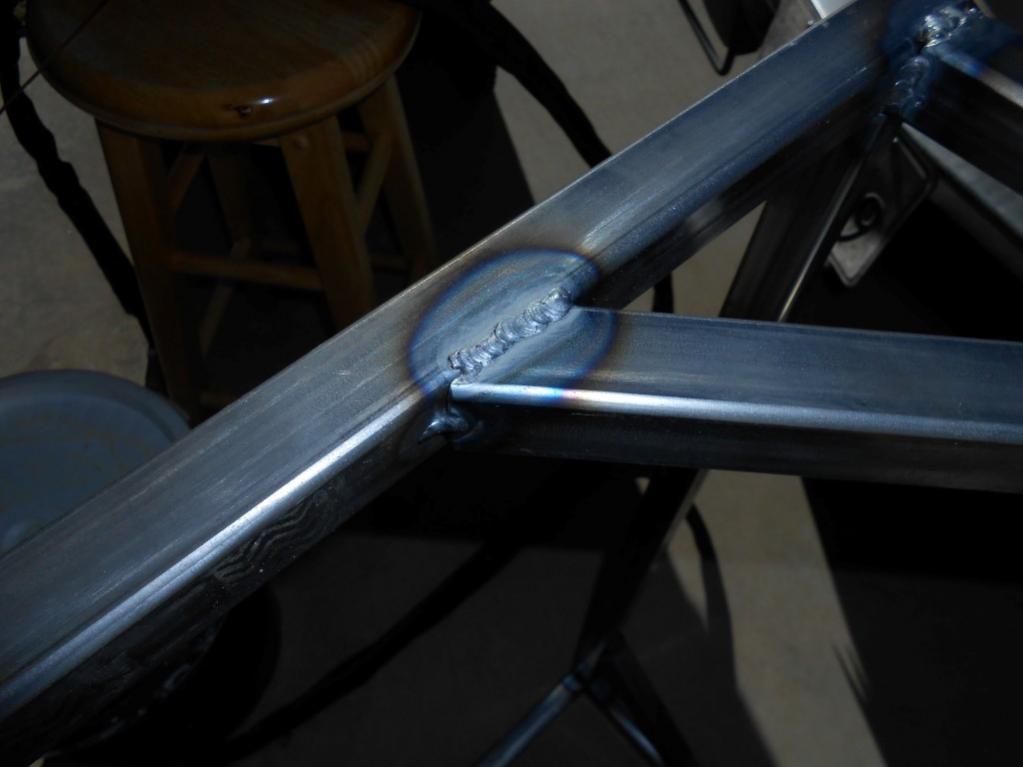

    Switched to 3/32" gold tungsten, 3/32 general purpose filler, #7 cup, 95 amps on the torch switch. I went bigger because the gussets had some 1/8-1/4" gaps I had to fill. Didn't come out too bad.

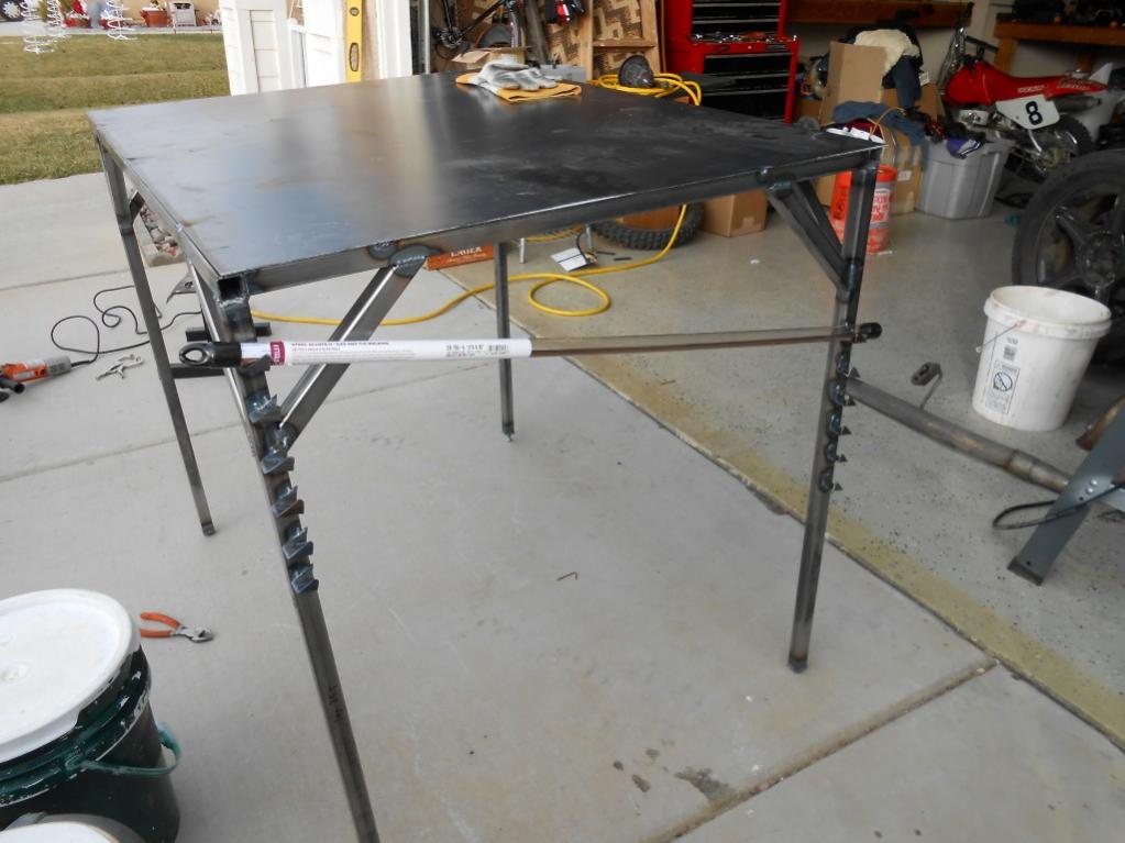

    I had all those left over 45 degree pieces from hacking out the gussets, so I rounded one corner on each and tacked them to the right side of the table. A one pound tube of filler fits perfectly in each one, for a total of 6 pounds of storage. I can always add more later if needed, but I doubt it.

    On the other side I bent some more of that one inch flat stock I had laying around and will use it to hang the cables and torch on when not in use.

    Thats about it. I'll post a few more pictures once I get it all in place. I sprayed it with a little coat of silver paint just to help prevent rust on the legs and underside. Left the top as a bare surface.

    It's too bad that table doesn't fold up for easier storage. I like how you used every last scrap of metal though! Do you MIG weld more often than TIG? It might be a good idea to get a piece of (dirt cheap) 24 gauge galvanized sheet metal bent up at a local HVAC shop to cover your nice table top when MIG welding. I messed up a nice table top at work years ago while MIG welding (dingle berries EVERYWHERE!), and from that point forward I had to use the DA to smooth out the top surface after MIG welding. Of course that always promoted rust during the cold weather as the table was outside under an awning. It's impossible to stop surface rust when leaving a welding table outside, even when it's covered up and under an awning!
    Nice job, I still need to make a nice table sometime down the road. I assume the tubes on the front are for your rods? If so that is a good idea. I also like the idea of welding on the nuts that will assist in leveling the table. The covering sheet for MIG seems like a good idea also.
    I don't do a whole lot of mig welding unless its repair work and normally doesn't fit on a table. This table will be used almost entirely for TIG welding. Luckily for me, we average about 5% humidity around here year round, so surface rust isn't a huge concern for me, even if I left it outside uncovered. As far as using scraps, why waste metal if you don't have to? I could have made a much nicer looking holder for the rod, but it would have cost a few bucks in steel to do it. As long as its functional, I don't really care about how good it looks.
