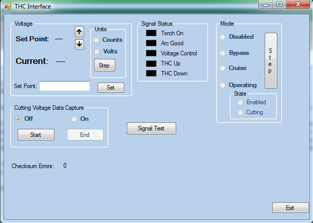

    Hi,
    Im sorry I didn't even realize that I've got answer from emptynester as the forum didn't send me notification of new post/reply. I don't know why it was set.
    First of all thanks for the answer but I have further questions if you don't mind.
    Here is a screenshot of the windows program but I couldn't figure out where I can set up the pierce delay and pierce height. Where and how should I set it up if I can't in the windows interface?
    Unfortunately there is not much of this windows control program in the user manual.
    Many thanks
  10. #130
    Pierce height and delay are typically set directly in the g code sent to the control. The settings should be in your CAM software, or can be done with hand written g code. The THC does not take over control until the OK to move signal is set. Also your control may do a touch off to calibrate pierce height before each pierce. LinuxCNC can use an m code for that, and I believe Mach does as well via the touch probe input and G31. That really helps to get things in the ball park if you have material that isn't very flat, or you change thickness of material.
