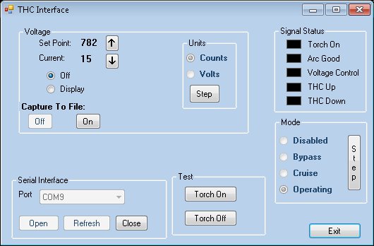

    Default Like Some Feedback
    I've finished building the Rev B board. The initial testing has been on the serial port. With the old hardware, it would only go 38,400 baud. With the new design it will do 115,200 (I haven't tried faster). I still have to finish testing the rest of the functionality (but there were no other functional changes).
    I started looking into what it would take to integrate the THC right into Mach3 with a plug-in. Seems do-able, but more work than I'd like to do right now. But for easier testing I've been updating my Windows interface app to allow control and monitoring of the THC.
    I've found that with the THC below the table (between the PP50 and my motor controllers), it's not convenient to access it, or even see it, while cutting.
    Dropping support for the LCD would cut the cost by about $20 to $25 (cost would be about $20 for Arduino Mega, $2 for relay, $5 for USB to serial, $10 for THC shield PCB, $15 to $20 for THC shield parts, $10 for a wall wart - so about $60 total). It may also improve the performance of the THC and allow you to just watch the screen w/ Mach and the control app.
    While it needs more work, it currently looks like:
    HERE'S THE QUESTION:
    For those with any interest in this project, would you prefer a THC with it's own LCD and push-button interface, or a PC software interface app?
    Just starting in Aug '10
    Hobart Handler 187
  5. #65
    I have interest..not sure that I will ever proceed with building a table or not though.
    I'd say the software interface is fine. Maybe an LED on the box to show it is in fact on and / or arc ok, if that is doable. Even that may not be of much benefit really.
    The motion controller is solely PC based through Mach 3, I don;t see any issues with the THC having only a PC interface as well.
  6. #66
    From what you say having the display is not the much more money and I seems simpler to look at the Arduino display for voltage reading and making changes there. I would rather have the LCD and not the Mach3 screen with another page to look at. The movement of the Z axis display of Mach3 will show what’s going on there.
    My 2 cents

  7. #67
    My 2 cents
    Tom
    Tom,
    I'd like to understand how you use it. If the control of the THC was on the "default" Mach screen - would that make a difference?
    I've found the Mach screens are overwhelming. So I was thinking about doing a custom screen with just the stuff I care about. Then later, including the THC control interface on the "simplified" screen. (Right now the interface is in its own application, but that sucks because Mach takes up the whole screen and you keep having to put one in front of the other.)
    I like the idea of the stand-alone display. But then placement of the controller becomes important. So, while it was handy while I was developing the software, I've found that it's not convenient for me when I'm using the table. But, after all this work, I'd like to end up having a system that would work well for others.
    Thanks,
    Rege

  8. #68
    HI Empty
    I was under the impression that the voltage control would be on the arduino screen and adjustment could be make independent of the Mach 3 control. I though that Mach 3 controlled the Z axis up/down due to the changing voltage sensed by the THC unit. I have seen custom screens for Mach that the guy put just what he wanted on it. Or maybe a separate screen could be developed and selecting a different screen while it is operating could be used too. Like changing between the program run screen to the tool path screen.
    I have the same problem with Mach 3 hogging the monitor screen.
    I may be way off base with how I am thinking don’t allow me to throw you off by my lack of knowledge about the operation of the THC. And I do not know how rework Mach 3 screens.
