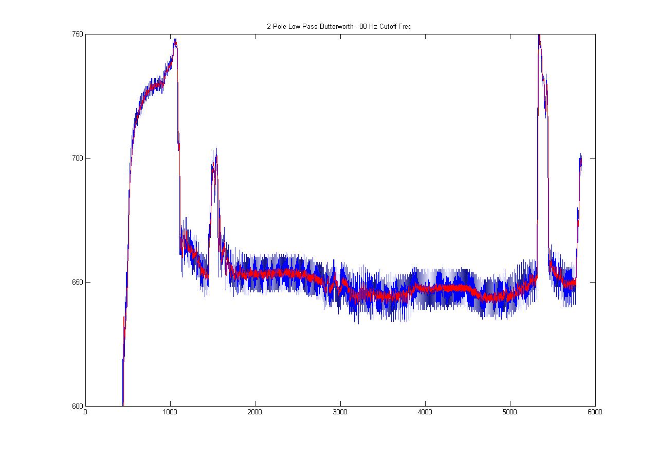

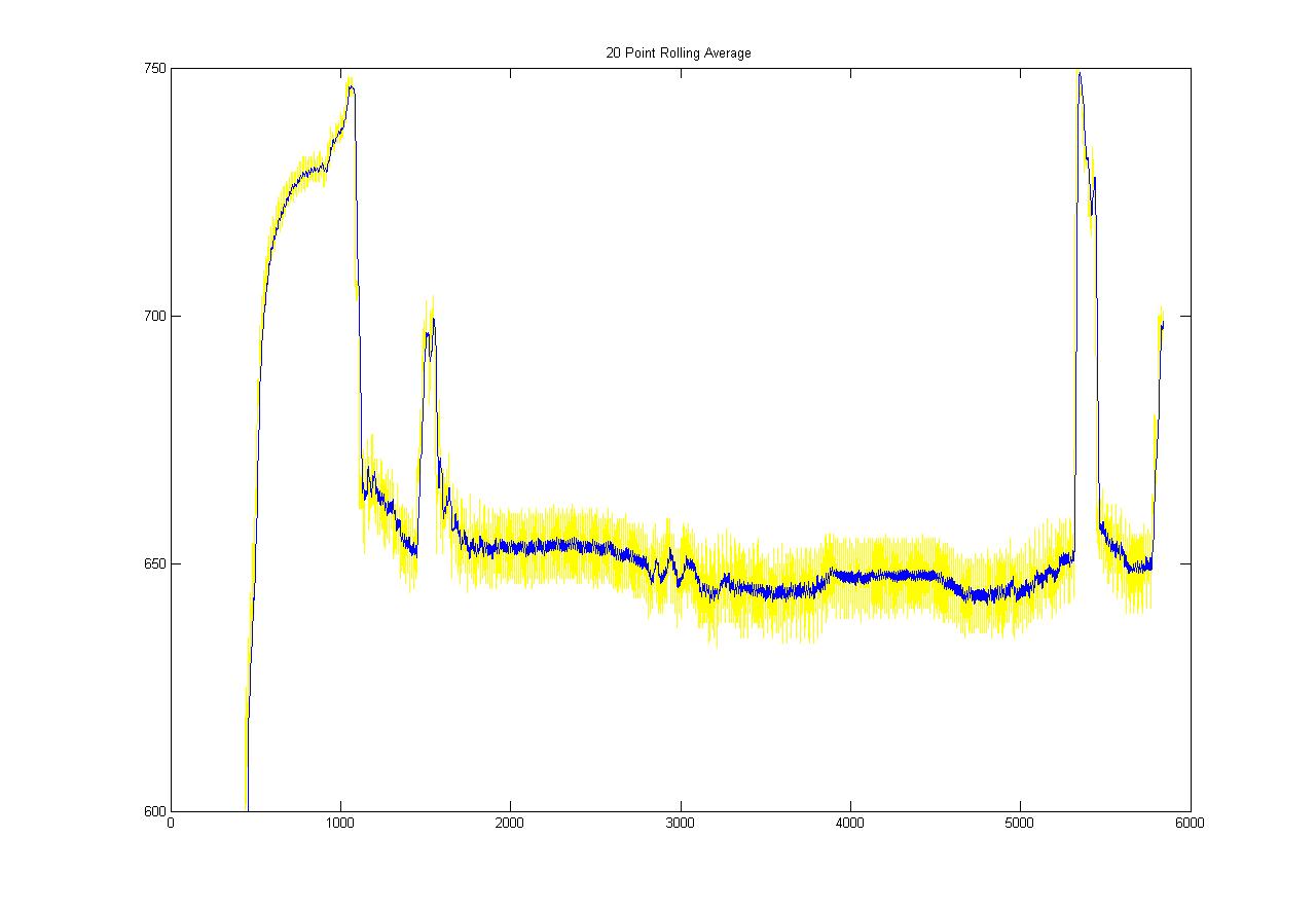

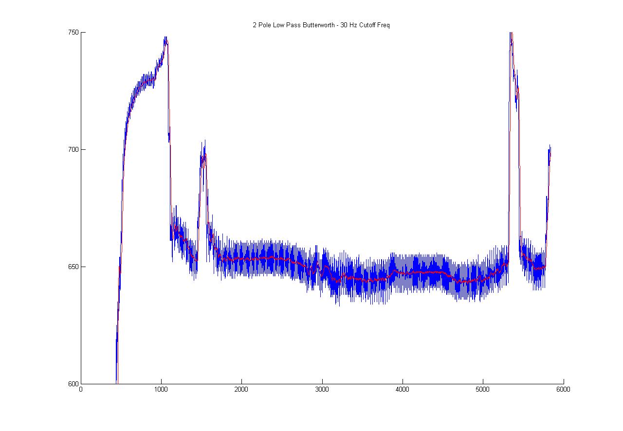

    So after looking at your equation, I think you're going to have a harder time correcting for "being low" than you think. Its low because it started at zero, and if you only had 1/20 the value of the next point, it will take a long time to pull the value to the "true" value. However, if you started with a high count value, you would be biased high and would be trying to pull to a lower count value. The problem is, without more code, you won't know if you started high or started low and which way to offset to correct.
    I would use either of the following options instead. I didn't bother doing the FFT, because after fooling around a little bit, I think you're right that most of your noise is ~60Hz. The first option is to switch from using your equation to a rolling average equation. The first plot shows a 20 point rolling average, the second plot shows a 50 point rolling average. Assuming a sample rate of 1000 Hz(1 milisecond), this will give you .02 or .05 seconds of lag. If you're cutting at 20fpm (4 inches/sec), that gives you a 0.2 inch lag. I don't think any material will change a huge amount of height in 0.2 inches.
    Formula:
    value = average(value(i-19):value(i)) - for 20 point
    value = average(value(i-49):value(i)) - for 50 point
    I think a better option would be to just create an analog low pass filter with an RC circuit. I used a 2 pole Butterworth digital filter to create the following two plots. The first one has a cutoff frequency of 35 HZ, the 2nd one has a cutoff freq of 80 Hz. You can see how much noise is left in the 80 Hz plot. Any low-pass analog filter with a cutoff below ~30 Hz should completely remove the 60 Hz noise without it falling in the transition band. Here is a link on how to come up with the RC values of various order butterworths. http://www.electronics-tutorials.ws/.../filter_8.html
    I tried higher order, but the higher the order, the higher the phase shift of the data and the more laggy it will become. Using the analog filter will also allow you to remove the lines of code from the control software and free up some processor power for other things.
    As a final note, you may have better luck going to an open loop control mode. Instead of trying to control between 0.5 and 1 volt, you may want to try setting an upper and lower bound, and when you hit the bound, just move it ~.010 inches to correct. This will also free up processor power and give you a more stable sample rate, as it doesn't have to monitor voltage constantly, but just check it every 0.05 seconds or so.

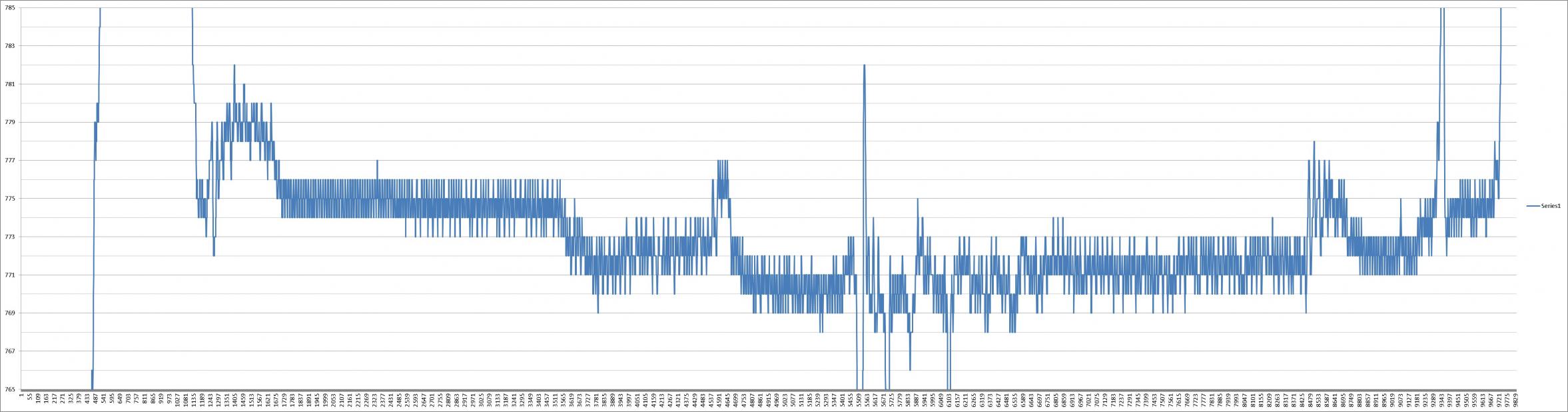

    Default Filter Update
    I took Agent4573's advice and put in a 2 pole filter. I used a calculator I found on the web and it said for a 35Hz filter to use a 470 ohm resistor and 10 uF capacitor.
    I put those on and did a couple cuts with data captures. They were worse then the previous cuts. I realized the only other difference on that run was I had my o-scope on the circuit both before and after the new filter. I tried another capture without the o-scope and it was really good. I guess the o-scope leads were just "noise antennas".
    A blow-up of the raw analog to digital readings (no software filter) is below.

    You can see that the signal is now typically +/- 1 count from the baseline. Couldn't ask for anything better.

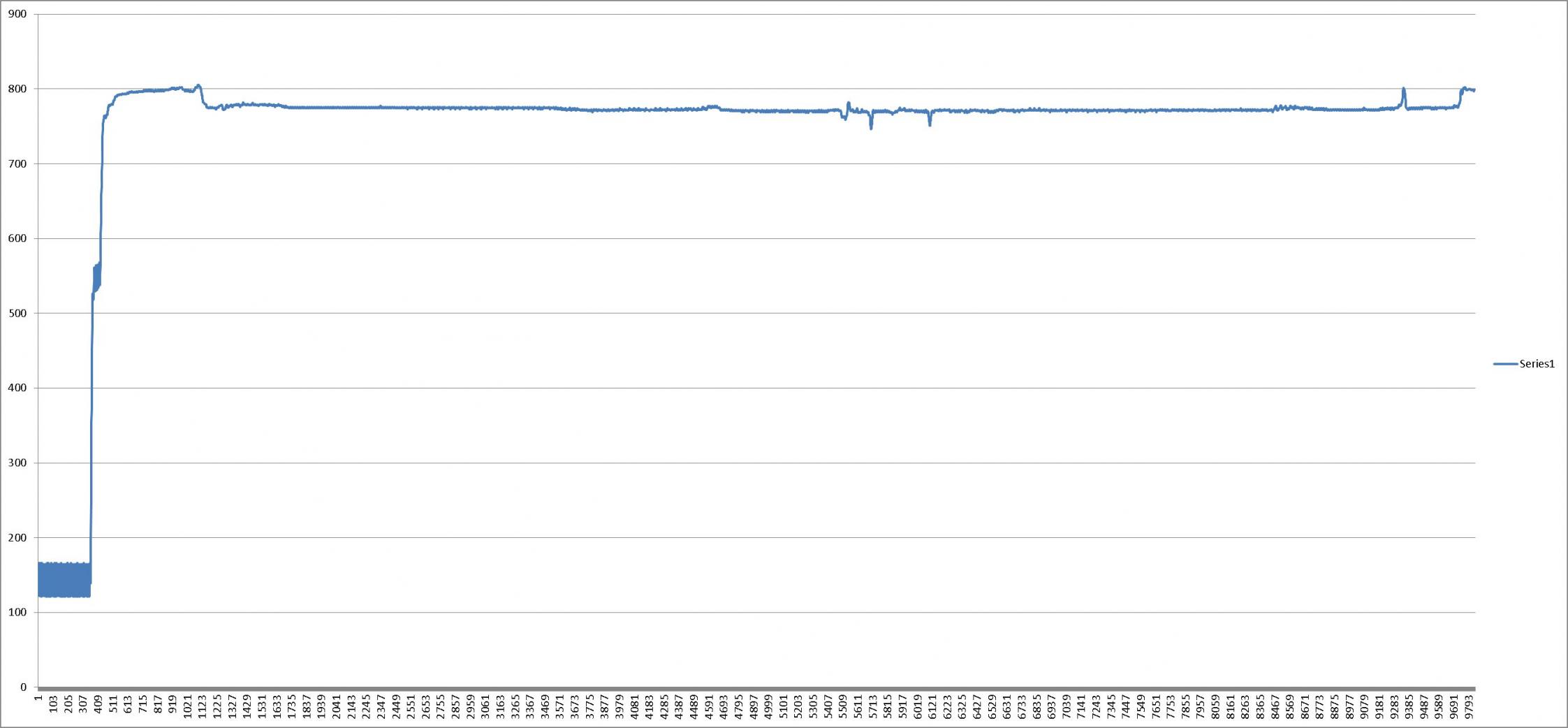

    A full trace of cutting a 1/2" x 2" rectangle is below:
    I did look at the timing. I'm currently dumping data every time through the control loop. I have a delay so that it won't run more than every millisecond. The software currently waits 1200 ms from an "Arc Good" signal until it starts voltage control. In the capture it showed 1142 ms. between "arc good" and start of control. So, it's off by about 5%. I'm guessing that dumping all the data could have something to do with that, though, the display updates could also have something to do with that.
    This is running on an Arduino Mega that uses an ATmega2560 that is an 8 bit processor running at 16 mHz. So, it's not a speed demon but looks like it may do okay for an entry level system.
    I think after I have the first pass running well and all the source posted, I may move to the Freescale Freedom. It's a 32-bit arm processor with a $12 board.
    On the THC front, I have to figure out the best algorithm for up/down. Since it's a digital signal instead of a up/down speed - I'm guessing that I should just continue with the set "trip points". I think the biggest impact is the response time of Mach and the steppers, but I have no idea what that is. Given the latest capture I think that maybe I should trip torch movement if it's > 3 off and turn it off if its within 1 off. Anybody have any thoughts on that?
    I still need to figure out how to setup Mach. It currently won't allow going below the height of the initial height sensing. Also, I have to figure out the "THC Rate" to use.
