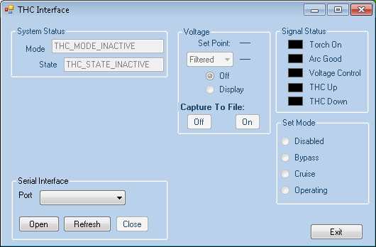

    I've posted a video on youtube of the user interface for the Arduino THC I'm developing for my PP50. The video is at:
    This gives an overview of the interface and functionality of the THC. I'll do a video later showing it in operation.

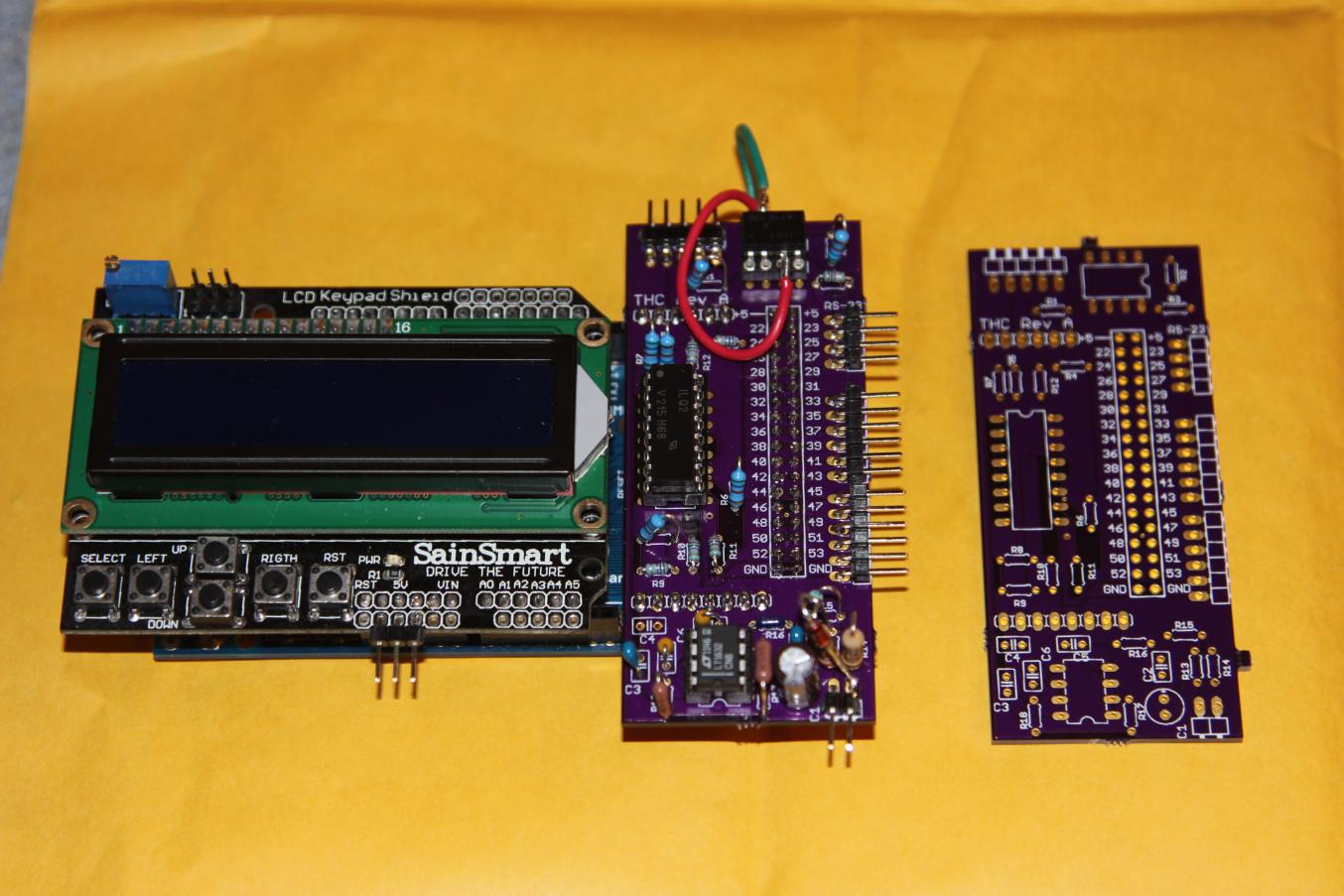

    I got the boards back for OSHPark.com in less than three weeks. They look really good and I couldn't help myself and had to immediately build one. The assembled Arduino w/ display and THC shield on the left is a reasonable size.

    As you can see from the picture, I did find an error that I had to run some wires for. It's for the serial port. With the wires the transmit from the Arduino works, but the receive doesn't. I had trouble with the receive wire and think I burnt out the chip. On the transmit side, the max speed of the serial port on the bench (not the noisy environment of the plasma table) is 38400. Going faster would require changing that opto isolator.
    I checked out the control button wiring and that all works well.
    I checked out the op-amp filter with steady voltages (I skipped the voltage divider so I could test with 3.3v and 5v) and that worked okay.
    I also checked the Arc Good, Torch Up and Torch Down outputs to the CNC that are opto isolated and they all worked.
    I still need to test the Torch On input from the CNC and the plasma signals for Torch On ouput/Arc Good input.
    Once those last three signals have been tested, I'll be ready to start testing it on the table.

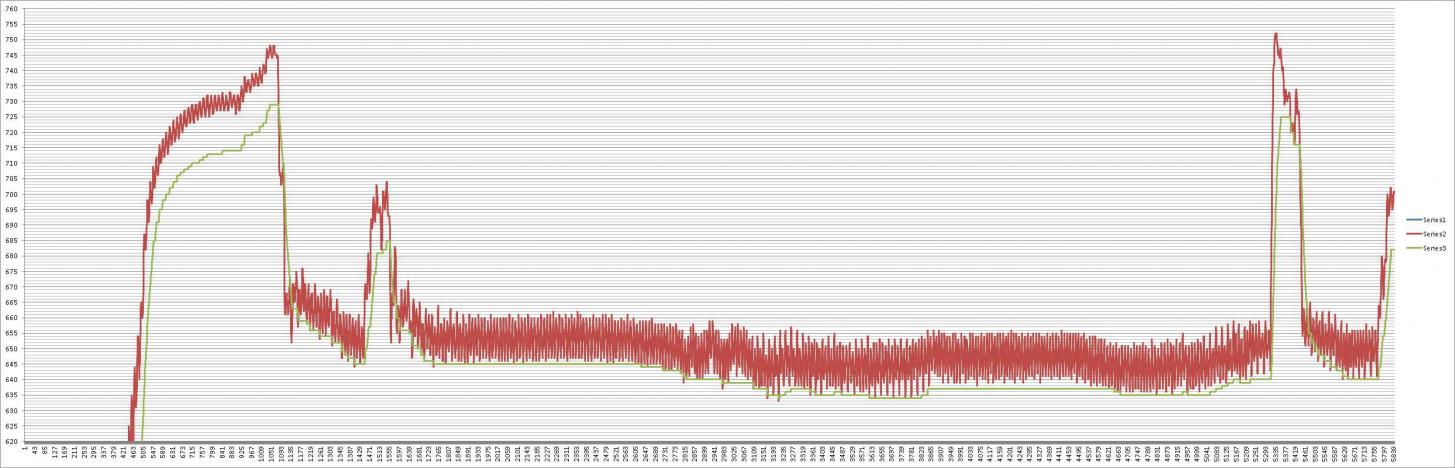

    I've only had about 20 minutes a night to spend on this.
    I did voltage captures with the new software with the electrolytic capacitor. I then removed it and did another capture. Turns out that the data was corrupted on the first capture, so I only have it without the electrolytic cap.
    I also did another capture with a different resistor value in the op amp circuit. The Spice circuit simulator showed that it should have given dramatic improvement on the 60 hz noise on the line. Reality was very different. If ruined the signal.
    So, I'm back to the original op-amp circuit resistor values. The captures are very clean and look really good. There appears to be 60 cycle noise on the line. I've ordered a couple common mode chokes to test and see if that will clean it up. If not, it's not a problem to filter in software.
    Below is a capture of the raw "analog counts" value in red (it's about 7 counts to a volt). The green line below it is the value after software filtering. It's small, but on close examination you can see that the green line is very smooth. The filtering works great. It reads about a volt or two low, but that's easy to compensate for.
    The filter algorithm is very lightweight, so it's fast for the processor. It is:

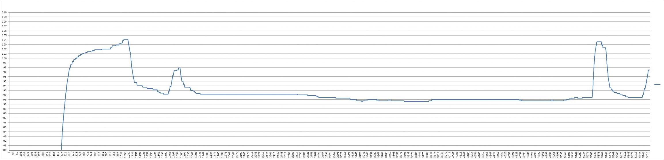

    The next chart shows the values read as volts.
    From that chart you can see how stable the voltage is.
    I'm really pleased with the performance. I just want to see if I can clean up the noise with a filter choke.

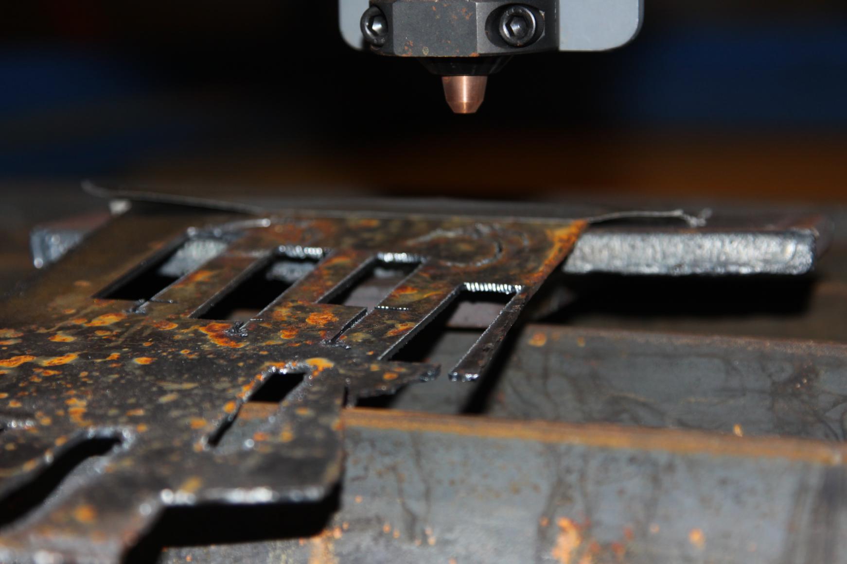

    I tried some test cuts with THC control.
    I started using a SheetCam post processor that would turn the THC off at corners when it slowed down. Then after the corner, it should turn it back on. For some reason, it turned if off and it never came back on.
    I disabled the THC on/off in the G-code and did some cuts. It was "sawing" up and down a little too much during flat cuts. I ended up changing my control loop to tighter values to improve the sawing. I also increased the THC speed in Mach from 20 to 40, but I'm not sure if that was the right thing to do or made a difference.
    After tightening the control loop to within 5 a/d counts (5/7 volt) it still "sawed" a little, but looked okay. (I think I need a better filter for tighter control.)
    So, I inclined some sheet to see what would happen. I still have the problem that Mach won't allow the torch to go lower than the initial Z home value. So, I had to make sure the cut started at the lowest point. I was cutting 2" x 0.5" rectangles.
    You can see the incline in the pictures. It is about a 3/4" elevation over 4.5". The right-most cut was the last one I did. On the very top of the cut you can see the rough edge from the torch going up and down.
ID:	9221Click image for larger version.
ID:	9220Click image for larger version.
    I've had minimal time to work on this because my day job is really interfering with my hobby time. But, any time spent is forward progress - so I'm pleased with that.
    I'm anxious to see if agent4573 can suggest a better filter algorithm.
