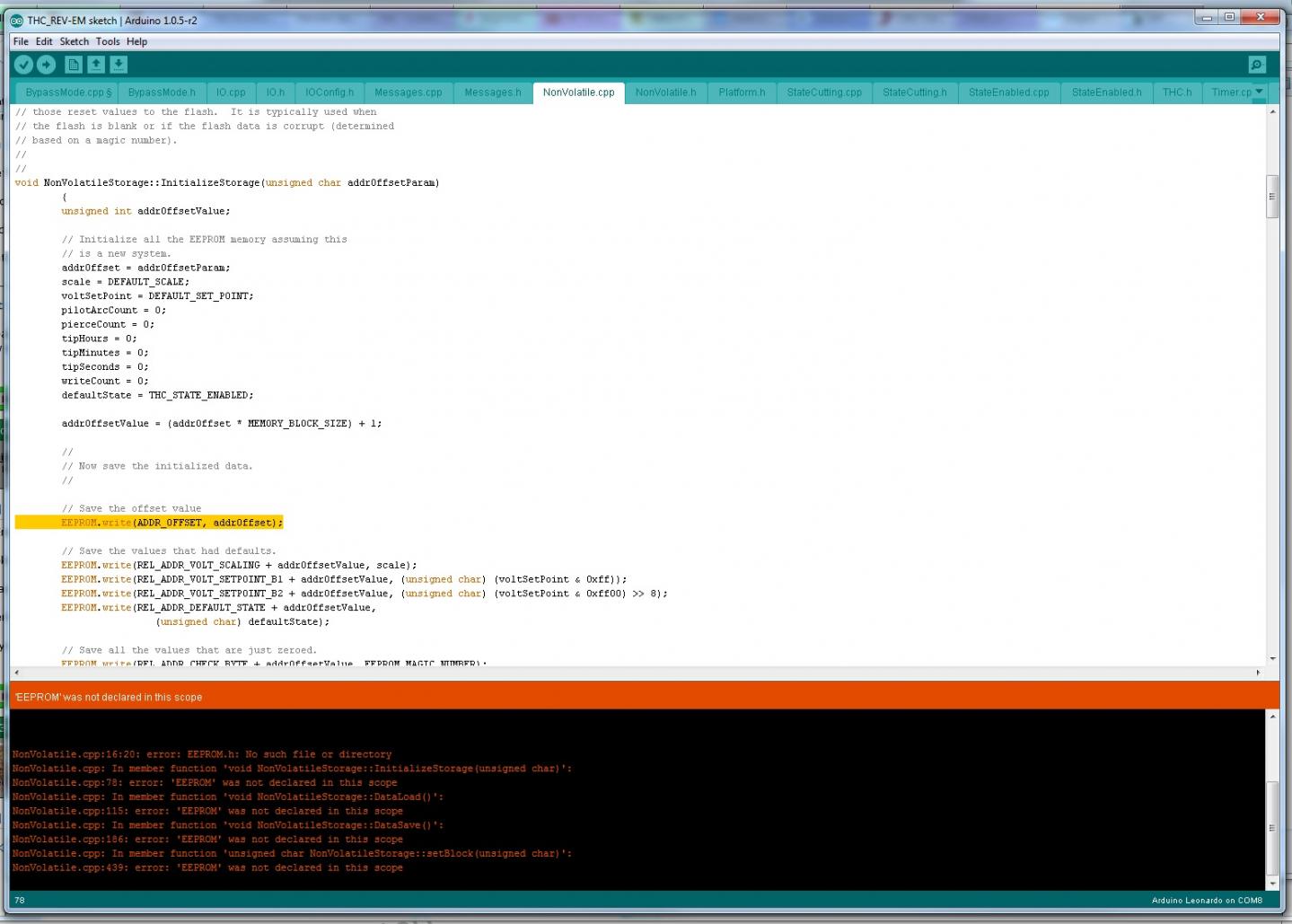

    Hi EmptyNester
    Took a while, but I sourced all the components and built a board. Then I installed the Arduino development environment and loaded your sketch file. Tried to compile the software and got the following error: Attachment 12044
    I was hoping the code was finished & tested, ready to use. I'm not much of a programmer, so don't know what to do now. Any ideas?
    I verified that the pro micro was installed OK, drivers were loaded and correct COM port chosen. I uploaded a sample sketch to it and it works as expected.
    Do you know if anyone else has built one of these THC's and if they had any problems with the code?

    Sorry, haven't been on the forum in a while.
    Your attachment isn't valid. If you can load a sketch file and it runs, then you have the drivers loaded right.
    You didn't say if you were using a Micro or shield system. Look at the file "Platform.h". If you are using a Micro, then make sure the following line is NOT commented out:
    #define MICRO_THC
    If you are using a Mega, then change the line to:
    //#define MICRO_THC
    That's my only guess without more details.

    Sorry, not sure what happened with that attachment. I think the forum has been having some issues, I couldn't log in for weeks.
    I did build the micro version, and followed your instructions to the letter. The #define MICRO_THC line is exactly like that with no slashes in front of it.
Name:	EEPROM error.jpg
    I've attached a screen shot of the error. Let me know if there is anything else that can help
  12. #112
    You should take a look at the Arduino site. They have examples of including libraries in your programs. It looks like you don't have a library included. The other thing is that I'd recommend using version 1.0.5 of the Arduino environment. That's what I used to build it.

    I have done a lot of reading on the Arduino website over the last few weeks. To try to narrow down the error, I have d/l several simple sketches, u/l them to the micro and it works with them.
    There are only 2 versions of the Arduino environment available on the Arduino website - Arduino 1.0.5 and Arduino 1.5.6-r2 BETA
    I downloaded the 1.0.5 (which actually installs 1.0.5-r2. As far as I can tell, the r2 revision has been updated to add support for Windows 8.1) But I'm using Windows 7 so I think it makes no difference
    It came with a lot of the Libraries already included as you can see below.
Name:	Arduino installed libraries.jpg
    Am I missing anything that you might have on yours?
  14. #114
    I PM'ed some ideas to you.
    On thinking about it, I recall running into a similar bug with the IDE (I am using 1.0.5 also). I think the project file got corrupted somehow. I had to create a new project and recreate the files.

    Hi EmptyNester
    After a lot of time and trying many different things I finally got it working. There is a lot of rapid up/down movements, like it's sawing through the steel, but at least it does work. It looks like it overshoots and overcorrects constantly, similar to your vid on YouTube but more exaggerated, and I'm wondering if my Mach3 setting may have something to do with it? Do you think you may be able to check on some of them on your setup please? What should the THC speed be set at? And the THC Max & Min settings? And any other related settings that may be relevant.....
    Also, I have a question re the Mach3 plugin. I have installed it but nothing looks different - what does it do?
