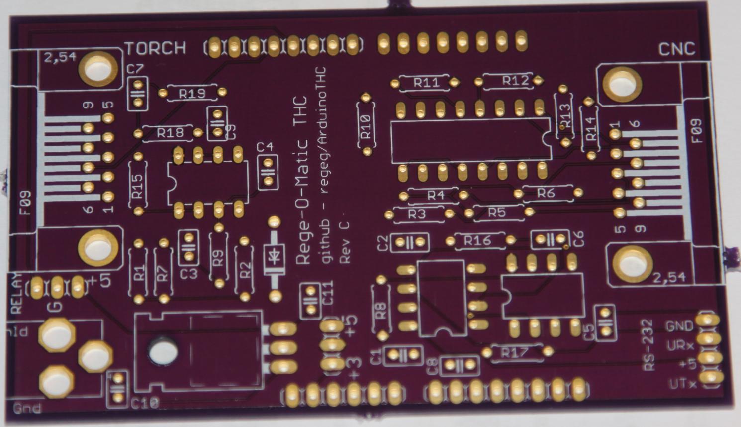

    Default Rev C Board
    I haven't done much in the last couple weeks. It's been a combination of being tired of getting cold working in the garage and travel for work.
    Today I just got the Rev C shields back from fab.
    After I sent it off I realized that I didn't run the "torch on" signal lines on the DB-9 to a solderpad so it can be wired to the relay. As soon as I got it, I saw that the power jack footprint was wrong.
    This rev of the board goes back to the ground plane configuration used in the first rev (that worked). New to this rev are:
    - DB-9 connectors for cabling to the CNC and PP50
    - 3.3V or 5V supply jumper
    - Power jack w/ power supply regulator
    - Standard shield layout
    - no support for a UI or buttons (will rely on control interface application on the PC or integrated into Mach)
    The goal with the standard shield layout, the on-board power and 3.3/5 volt jumper is to allow the shield to work with both the Arduino and the Freescale Freedom board (32-bit ARM that costs $12).
    I hope to get this build and testing this week.

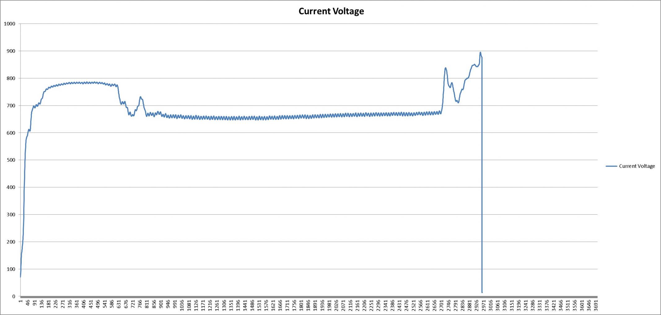

    I finally got a successful data capture (broken wire issues). It has almost two volts of noise on the signal.
    After magnifying the graph it was easy to see that the noise is at 60 hz, on the nose. On this rev of the board I added the two pole filter to the back end of the op-amp filter. I'll just need to tweak values to see if I can improve the noise response.
    If I can, then this is a pretty solid design. I already have a Rev D design that is identical to the current one with the only major change being the addition of a torch-on relay on the board (I currently have it on the side).

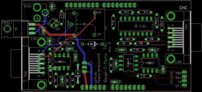

    The current board looks like this:
    The bottom left hand corner is missing the power jack and the voltage regulator. Not necessary, but put there so it can be used with the Freescale Freedom board.
    Having the torch connector in the upper left corner is a problem. If you push down on the board, the pins from the DB-9 short on the metal housing of the USB connector. For Rev D I moved it to the botton of the board.
    The layout of the Rev D board is done, except for fixing the footprint of the voltage regulator. It's also a little wider.

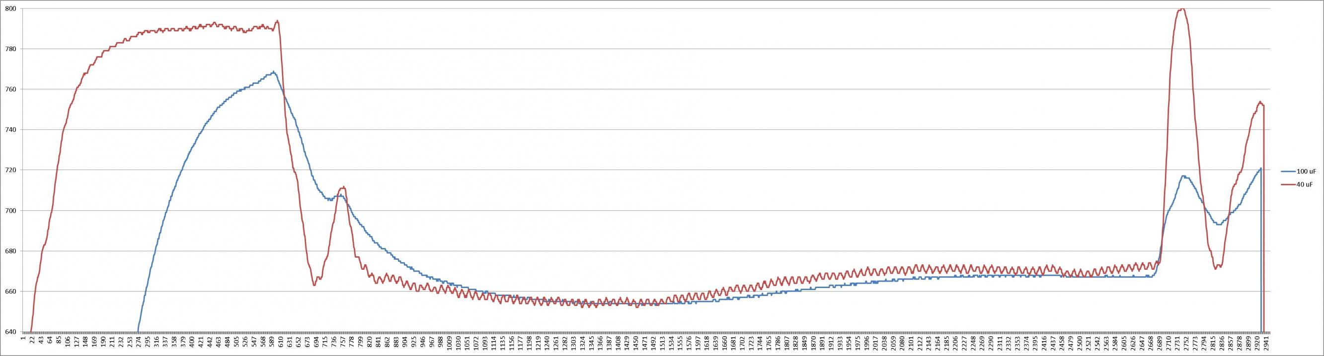

    With my son's help, I figured out what was doing on with the 60 hz noise. I hadn't realized that the frequency I entered in the R-C filter calculator was where the filtering started not the frequency that was eliminated. So, a 60 hz filter only started filter at 60 hz. An 8 hz filter reduces 60 hz noise to pretty much non-existent.
    I went from a 10 uF final R-C filter capacitor to a 40 uF to a 100 uF. (The 10 uF and 40 uF were tantalum, the 100 uF was electrolytic. I have some tantalums on order to see if they hold the voltage less time than the electrolytic.)
    The graph below shows the 40 uF and the 100 uF. The 40 uF has a span of 3 to 4 analog counts (1/2 of a volt on the input). The 100 uF has a span of 1 (1/7 of a volt on input). I'd like a little more filtering than the 40, but not the poor response of the 100.
    After removing the LCD and push buttons, the code size, RAM usage, and processing overhead all dropped. This should now work on an Uno (About $15 on eBay versus $25 for the Mega.)
    I have already sent off the Rev D board that integrates the torch control relay. It should be in by the end of the week. After that one, I think I'll be done with the hardware and focus on integrating the control of the THC into Mach. It's usable now with the PC app.
    After I have the Rev D board working, if I get enough interest I'll write up a guide on building and using it and then get some boards made to sell (probably about $5 + shipping - priced to get it out there versus make a profit).

    I have been working on tuning the final filter stage. The graph below shows the difference between 40 uF, 68 uF and 100 uF used in the low frequency filter (for 60 hz).
    While the 100 uF signal is really clean you can see the response time suffers. The 40 uF capacitor gave a swing of about 4 counts (a little more than 1/2 a volt on the torch). The 68 uF gave a very similar response but only had a swing of 2 counts. That's the ticket.

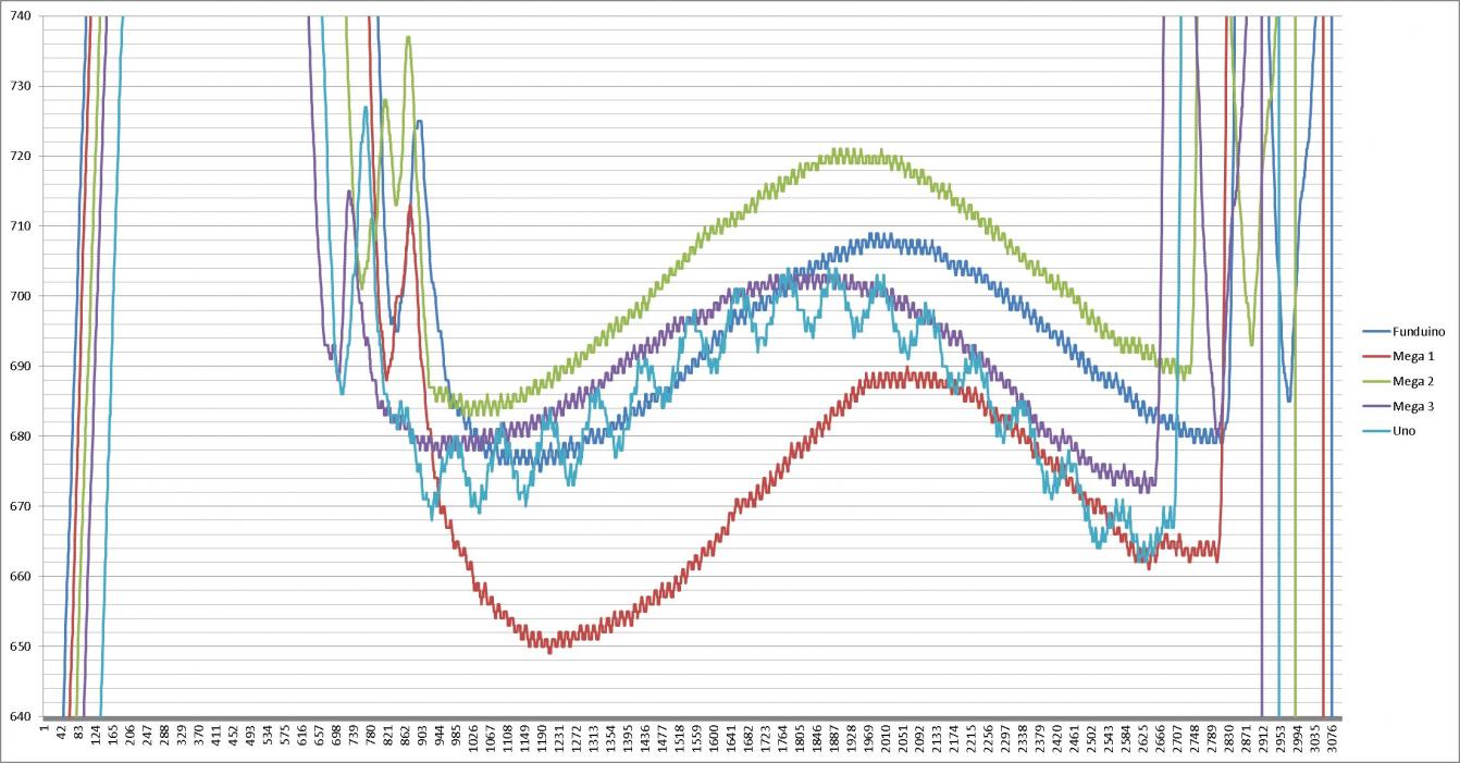

    Default Testing THC w/ Arduino Uno board
    As I'm waiting on the new rev of the PCB that addresses the last couple layout mistakes, I decided to try an Uno board. It's a smaller and cheaper board than the Mega. Without the LCD display, the software is small enough to fit on the Uno.
    I found that the plasma voltage signal on the Uno was very noisy compared to the other boards. So, I did a comparison of all the boards I had (1 Uno and 4 Mega's).
    The Mega's were very consistent but the Uno was lousy. I don't know if it is just a "bad" Uno board, or it's a fundamental/design issue with the Uno.
    The graph below shows the a comparison of all the Mega's and the Uno. It's interesting to note that the same THC shield resulted in different cutting voltages with different Arduino boards. (I use touch and go, so they should be pretty consistent.)
    It's about a 5 volt (plasma torch volts) difference between the highest and the lowest.

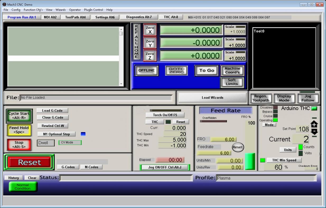

    Default Mach3 Integration
    Still waiting on the next rev of the printed circuit boards w/ the minor fixes.
    I started working on making the THC talk with Mach. It took a while to find all the info I needed, but it wasn't too bad. The screen design in Mach is another story.
    There are a bunch of different screen layout tools, and I think they all have a respectable learning curve. And, that's not something I'm really that interested in doing. So, I took the standard plasma screen and got rid of some controls I don't use (never bothered to even learn what they did). I've put the THC controls on the bottom right of the screen:
    The top left of the panel shows the current THC mode of operation and has the button to switch modes. The green LED to the right of the "Arduino THC" label is a status LED. It's green if it is talking to the THC and red otherwise.
    The display can be either in volts or counts. It shows 2 volts as the current voltage due to noise. I had code to compensate for that but took it out for debugging since a non-zero value helps.
    The arrow buttons will adjust the set point. There is an LED with each button. They show if the THC is sending a torch up or torch down signal.
    The bottom right has a checksum error counter. If the serial cable isn't shielded, you can get so much noise the system doesn't work. By showing the counter, you can tell if you're having communication problems.
    I still have to do the cruise control button. I can also put the tip life tracking in, but space is getting tight.
    I finished debugging the Mach interface and went to test it with my table. I got a Mach error because I need to add the .NET 3.5 upgrade to XP. Unfortunately, when I "optimized" my XP for use with Mach, I apparently killed the network adapter. So, it may take a while to rebuild the PC so that I can do a live test.
    Assuming the Mach interface works as well live as it has during testing, I still have more work to do on that. It's currently hard coded for the serial port, so I have to add some configuration ability to it.
