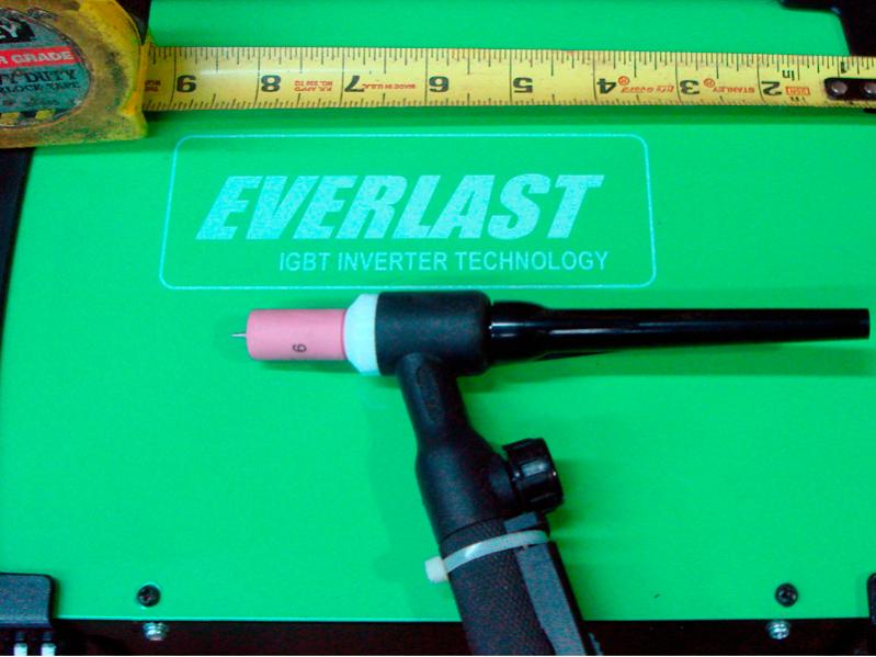

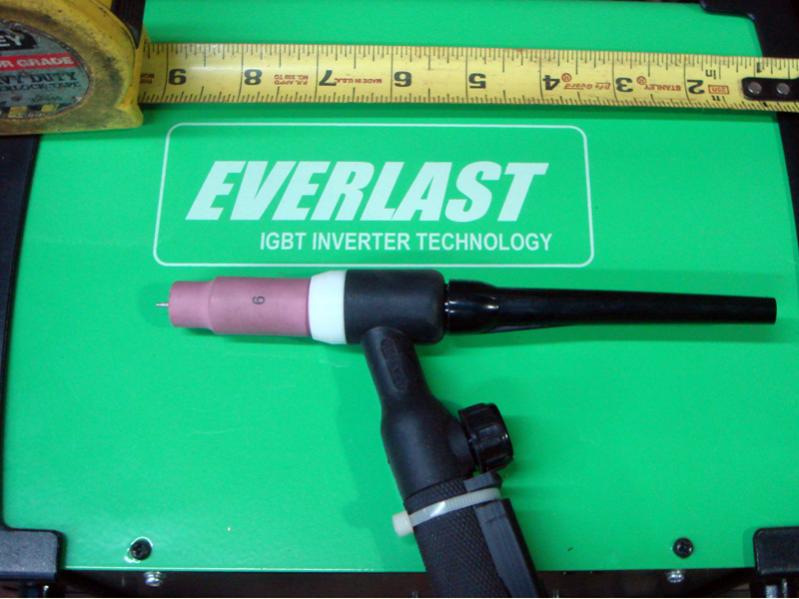

    Based on recomendations from Jody at http://www.weldingtipsandtricks.com/ it's a nice upgrade for the WP 26 torch.
    Standard version

    Stubby gas version

    Does allow you to get into some tighter spots.

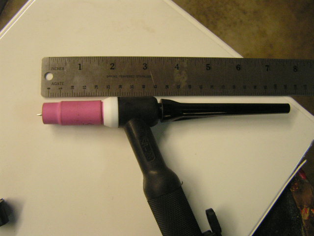

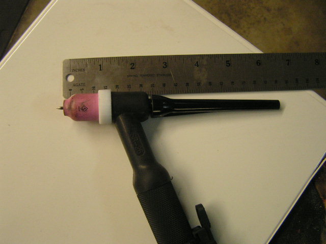

    You can also get plain stubby collet bodies to shrink the 17-26 torches. Gets into tight spots, but you can't run as much stickout as the gas lens versions. Both with #6 cups.

ID:	8892 - Click image for larger version.
