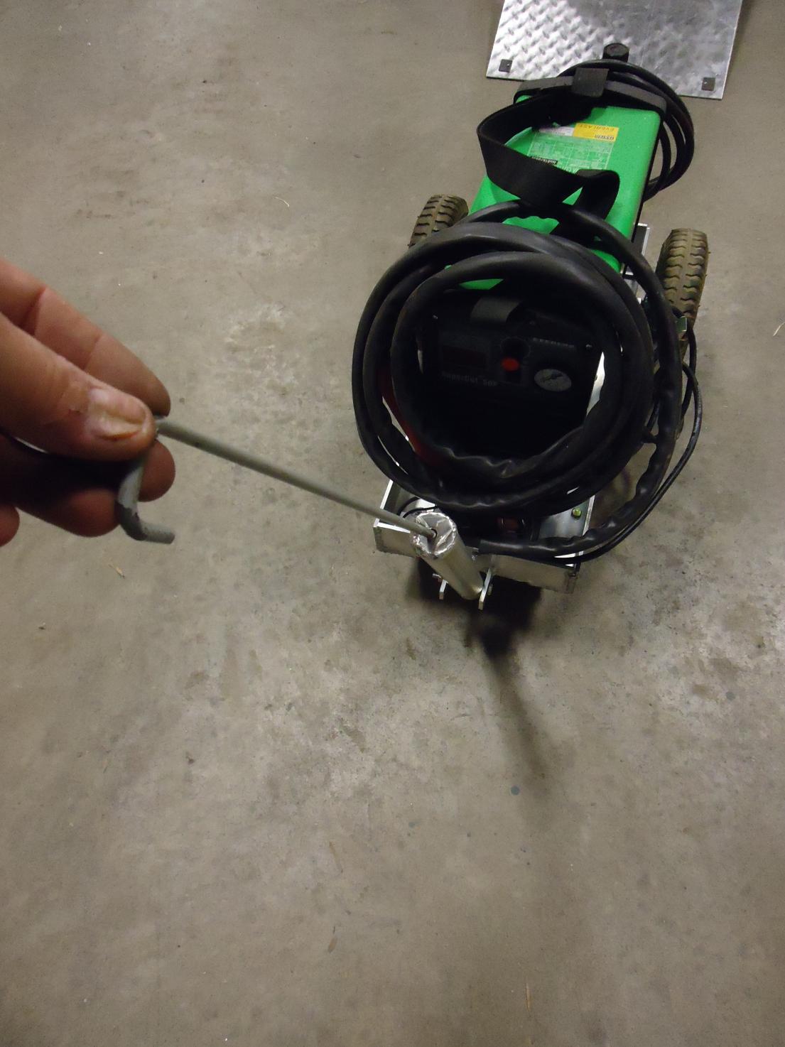

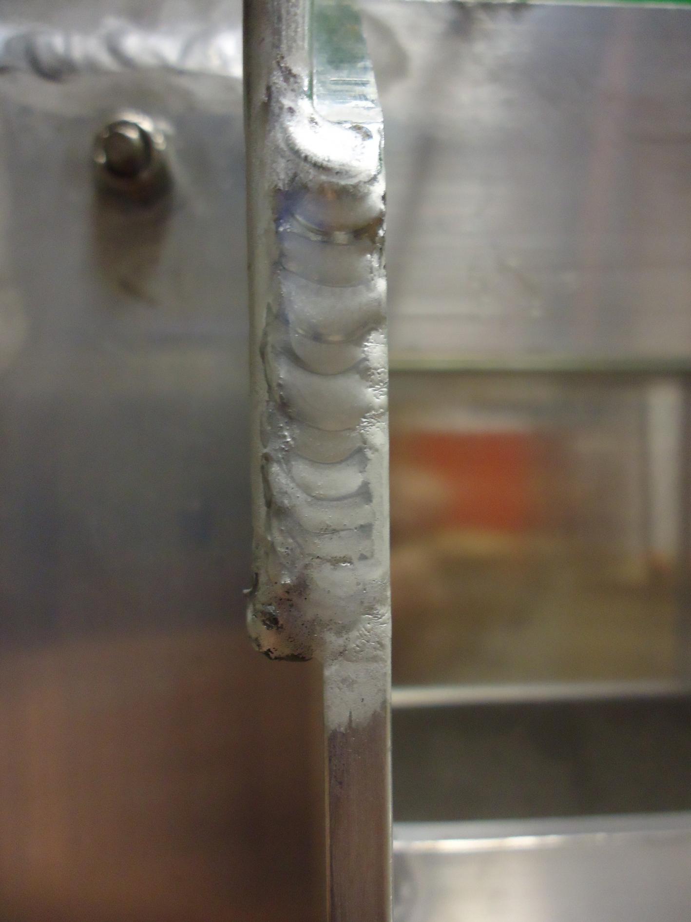

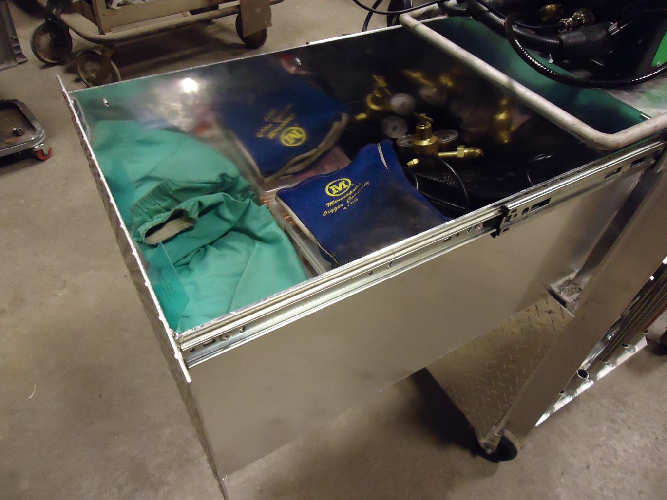

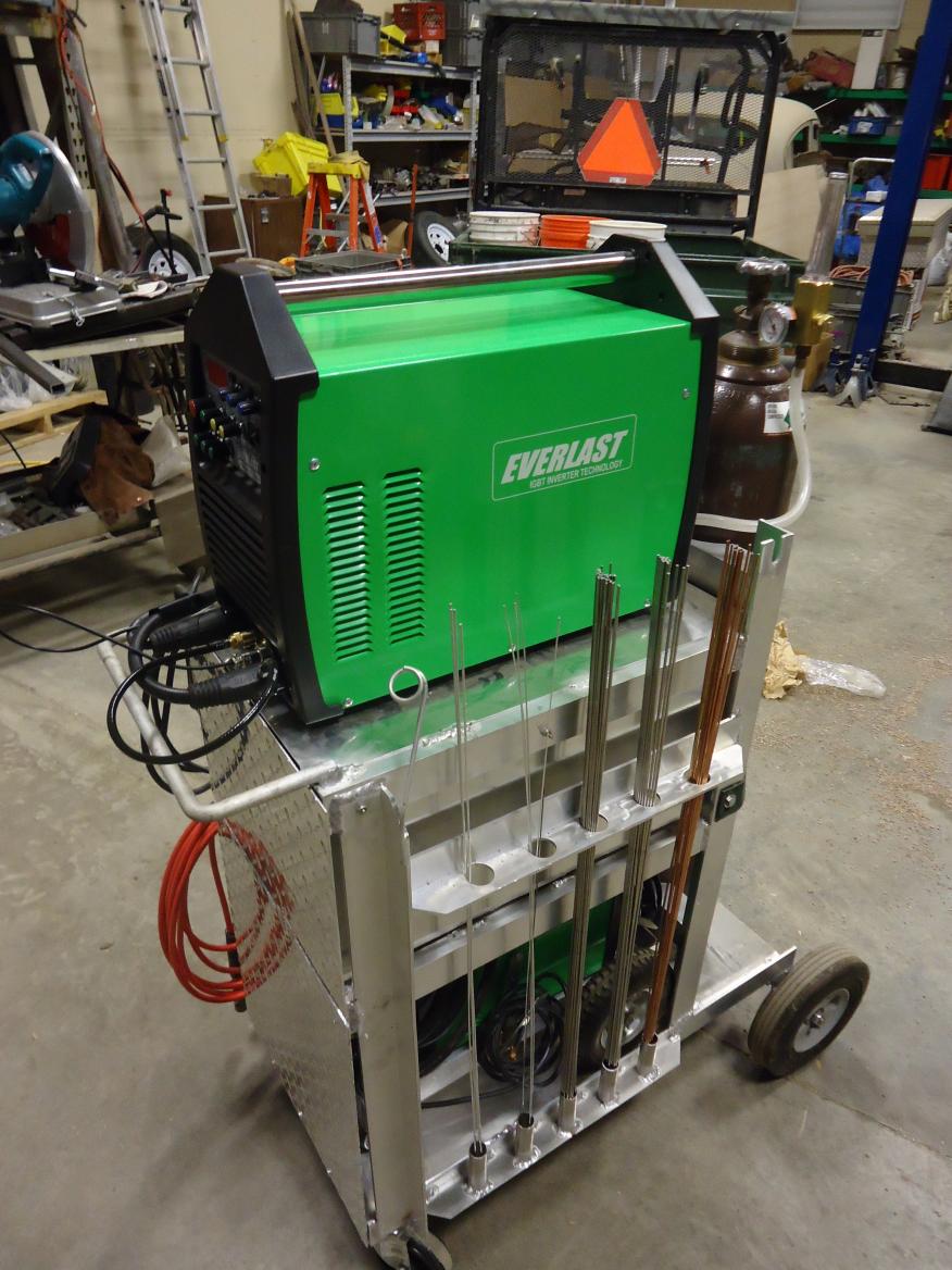

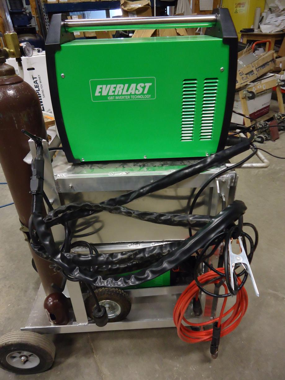

I have added some new additions to my cart since last summer, needed some hangers for cables and cords on the rh side, found some 10" 3/8" diameter rubber coated stanley hooks for a buck at the discount store. Rethreaded to 3/8" -16 and added them to the cart. I also added a coil hanger for my torch as i am mostly welding close to the table and wanted some place to hang the torch while hot. Welded it on vertical up at 95 amps with pulse on High.The little SuperCut 50P got a upgrade to the handle on the cart. Found some 1 1/4" .060 tube added a hinge and spring at the bottom and put a wire slide handle in the center so you can pull up and take off. There is a picture of the storage drawer also.
