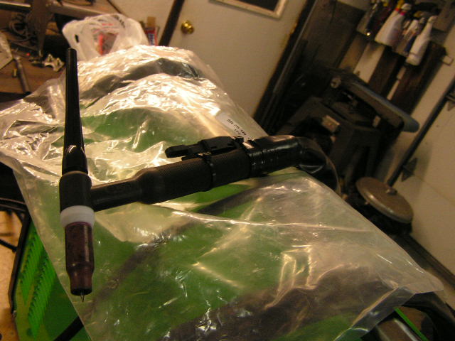

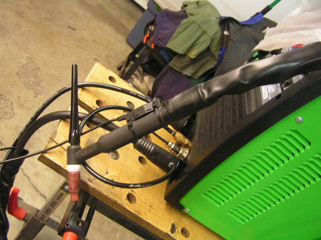

    Can you post a picture of the torch you received , is it a molded blue handle torch with a red switch ?

    It isn't the blue with red button, it's the black handle (WP26F15) with the finger switch. I think what the issue with me is the lack of flexibility with the cable. I could get use to the size of the torch, but the stiffness of the cable makes it hard for me to get into a comfortable position. I can weld for about a half inch. then I need to stop and repostion. I've never used a finger switch torch, always used a foot pedal with the limited tig use I've done. The foot pedal has a much different feel than what I'm used to, but it will just take some time to get used to I think. With a much more flexable torch set-up, I think I'll gain the confidence to produce a better weld.

    This is the WP 26 that shipped with my 200DX. I was practicing some tonight and the bulky feeling for me, is from the stiffness of the hose. I've already got use to the torch. Did some with pedal, I think I have that figured out now too.
