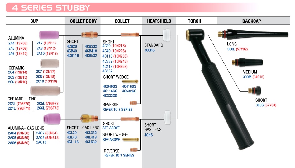

    I orderd the stubby kit Jody recomended for the WP26 torch. Much easier on the funds at this point than ordering another torch. If I do end up getting another torch, I'll get one that uses the same consumables as the WP26.

    Here are the CK individual stubby parts for reference and fit all brands of 17, 18 and 26 as well as CK 3 series torches. Click image for larger version.
ID:	8882 from CK torch parts pdf.

    Thanks Zoama,
    this is very helpful
