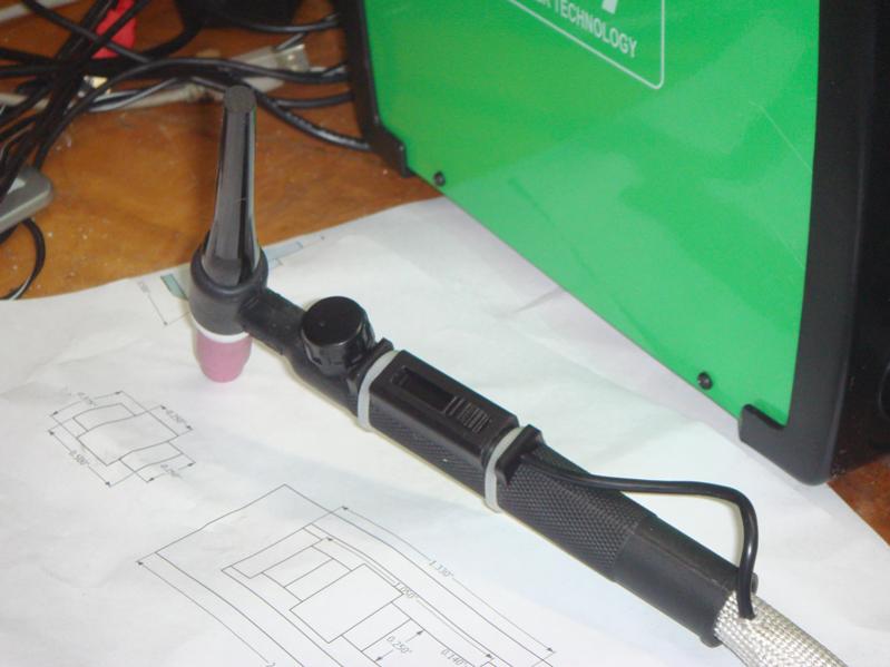

    I use Varflex fiberglass insulated sleeving. It's fire resistant and super soft and flexible.
