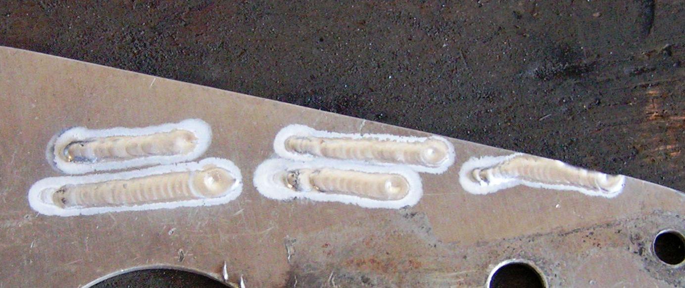

    Turned out, it was the HF unit. Ray was a big help. The unit was missing the nut that held the wires onto the points.
    I wasn't overly thrilled to have to open the machine, but, waiting for a nut to come from California made no sense and din't want ot have to wait longer to be able to use the machine.
    Didn't have a bunch of time, but was able to check and make sure the HF was working.
    The 200DX is a really nice machine, very first time I've done aluminum.
