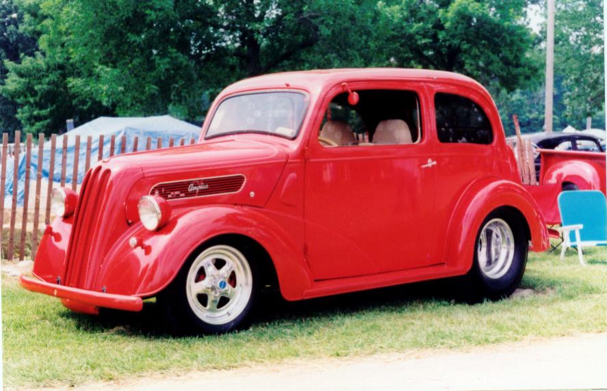

    The Anglia was my first ground up build.
