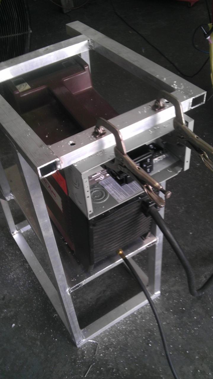

    So I was at my friends shop messing around with my 200DX and he started complaining about how one of the guys who work for him forgot to turn on the water cooler and burnt up a new torch that was replaced only about 2 weeks ago. Prior to this he was complaining about how he needed a new cart for his inverter thermal arc welder too. So I said why don't you make the new cart but add a breaker to the cart that turns on the welder and cooler with a single switch. He said he doesn't have time and would love to get around to do that but time time time. So, to get some seat time in with my new welder and just general practice I offered to make one for him using his materials. The look on his face seems like he just won the lottery, lol. Its teh least I can do since I use all of his material/equipment when I need something made or fixed.
    So here we go... will be finishing either later today or tomorrow.
    Material used so far: 1/8 rectangular AL pipe, 1/8 AL plate, Misc electrical stuff, SS Rivets, SS Screws
    Filler Rod: 3/32 5356
    Tungsten: 3/32 2% thoriated
    Cup: #5
    Settings: 150A, 220Hz, 30-40% Balance, Was messing around between foot pedal and also torch switch, No pre-flow, 4 sec post flow, 18 CFH Argon flow, no pulse
    Pic 1: Completed frame. The bottom part is for the water cooler, the next part is for the welder, and the top will have a hinged top with a tray set in to hold consumables, the top will also be able to act as a little welding top. Not sure if I want to put caps on the end of the pipe or not...

    Pic 8: Breaker box clamped down and drilled ready for set screws.
