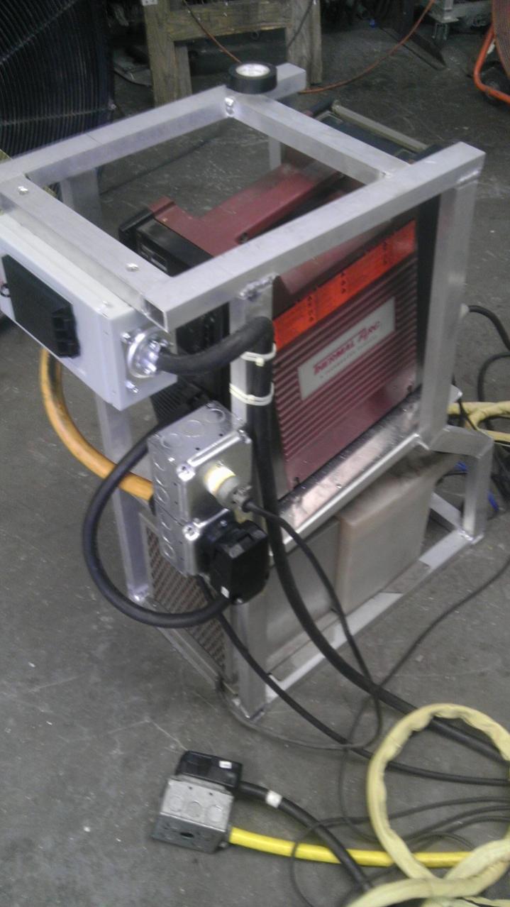

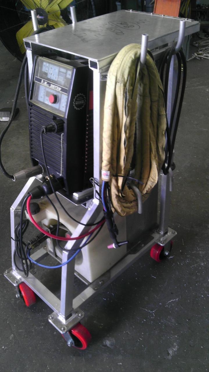

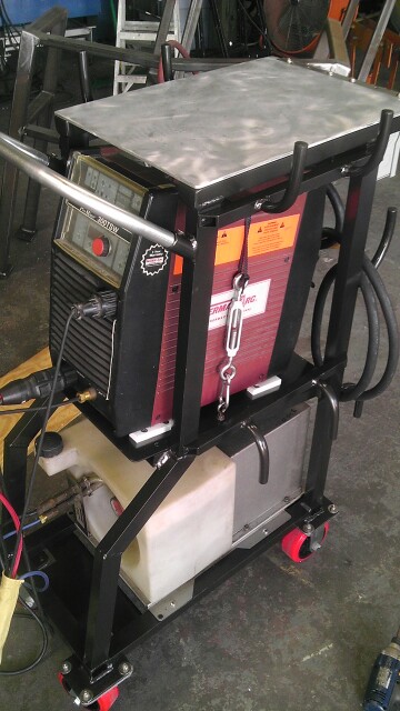

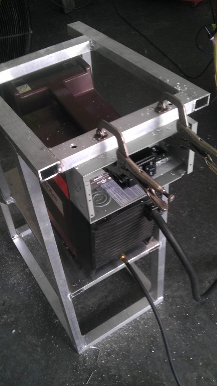

    So I was at my friends shop messing around with my 200DX and he started complaining about how one of the guys who work for him forgot to turn on the water cooler and burnt up a new torch that was replaced only about 2 weeks ago. Prior to this he was complaining about how he needed a new cart for his inverter thermal arc welder too. So I said why don't you make the new cart but add a breaker to the cart that turns on the welder and cooler with a single switch. He said he doesn't have time and would love to get around to do that but time time time. So, to get some seat time in with my new welder and just general practice I offered to make one for him using his materials. The look on his face seems like he just won the lottery, lol. Its teh least I can do since I use all of his material/equipment when I need something made or fixed.
    So here we go... will be finishing either later today or tomorrow.
    Material used so far: 1/8 rectangular AL pipe, 1/8 AL plate, Misc electrical stuff, SS Rivets, SS Screws
    Filler Rod: 3/32 5356
    Tungsten: 3/32 2% thoriated
    Cup: #5
    Settings: 150A, 220Hz, 30-40% Balance, Was messing around between foot pedal and also torch switch, No pre-flow, 4 sec post flow, 18 CFH Argon flow, no pulse

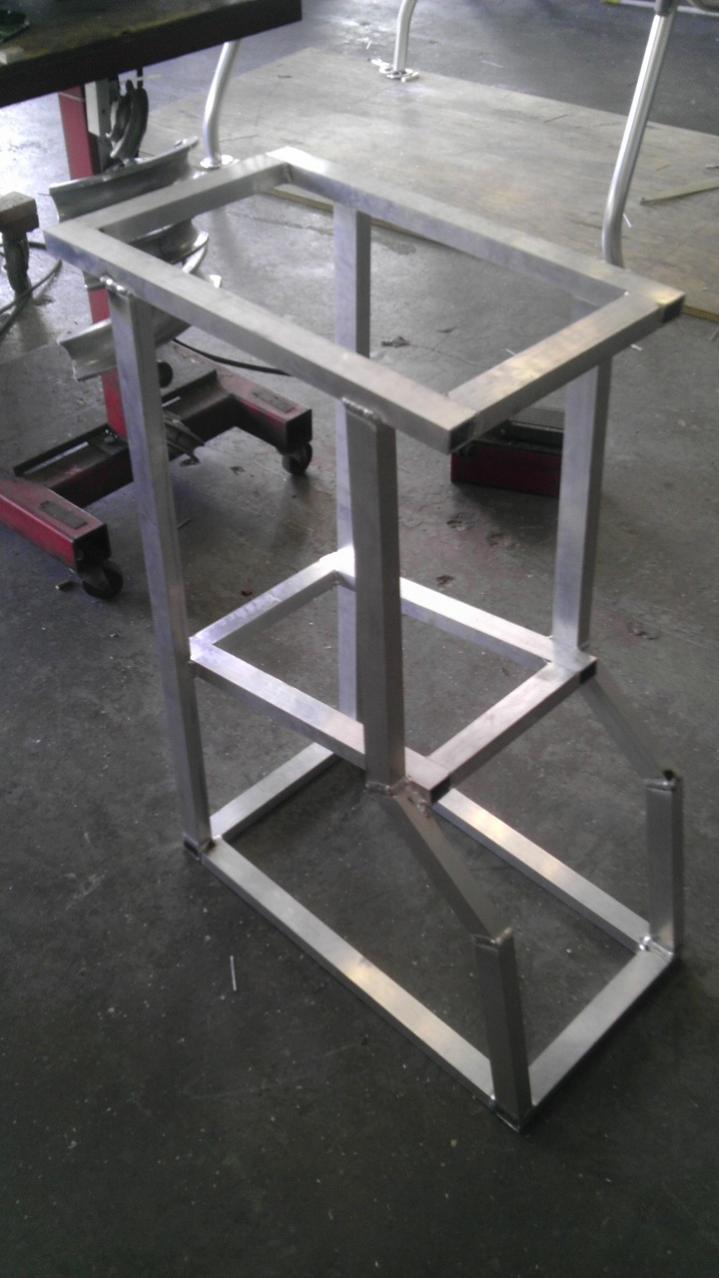

    Pic 1: Completed frame. The bottom part is for the water cooler, the next part is for the welder, and the top will have a hinged top with a tray set in to hold consumables, the top will also be able to act as a little welding top. Not sure if I want to put caps on the end of the pipe or not...

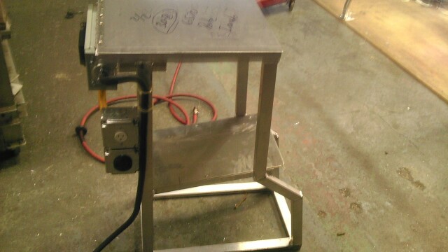

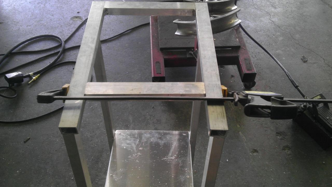

    Pic 2: This is the shelf for the welder. I just drilled the holes and will just use rivets to hold it in place.

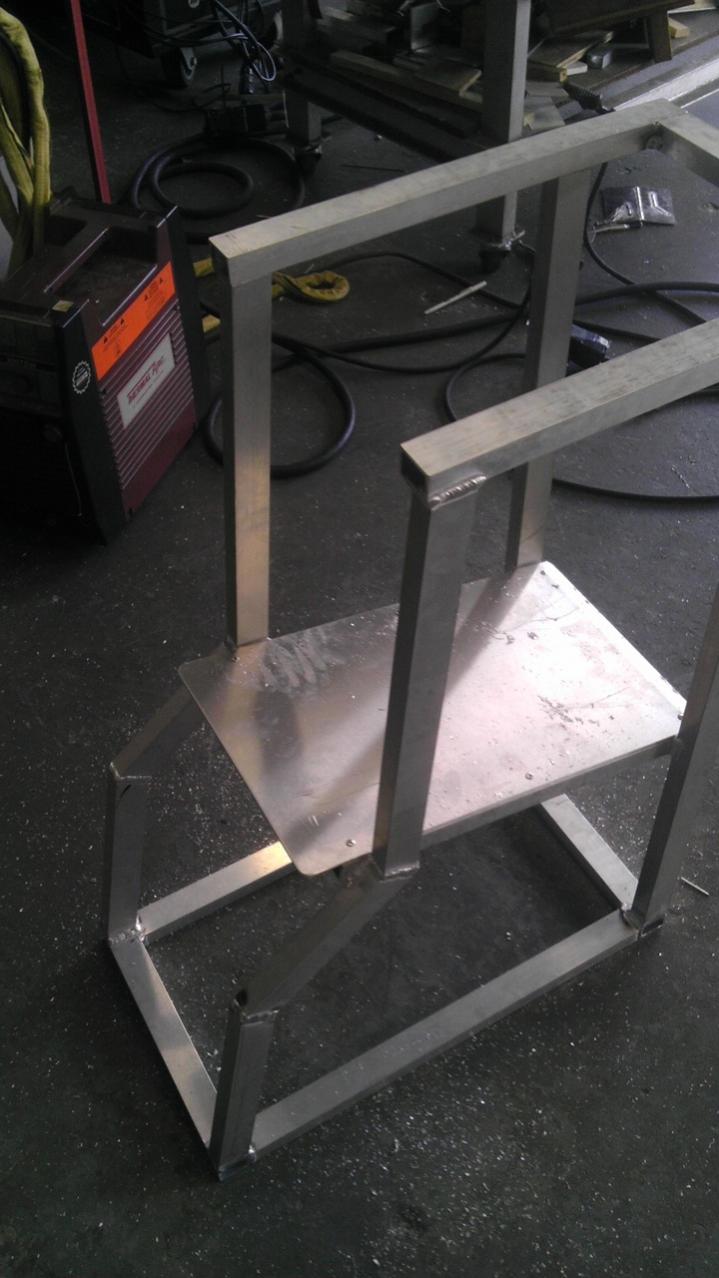

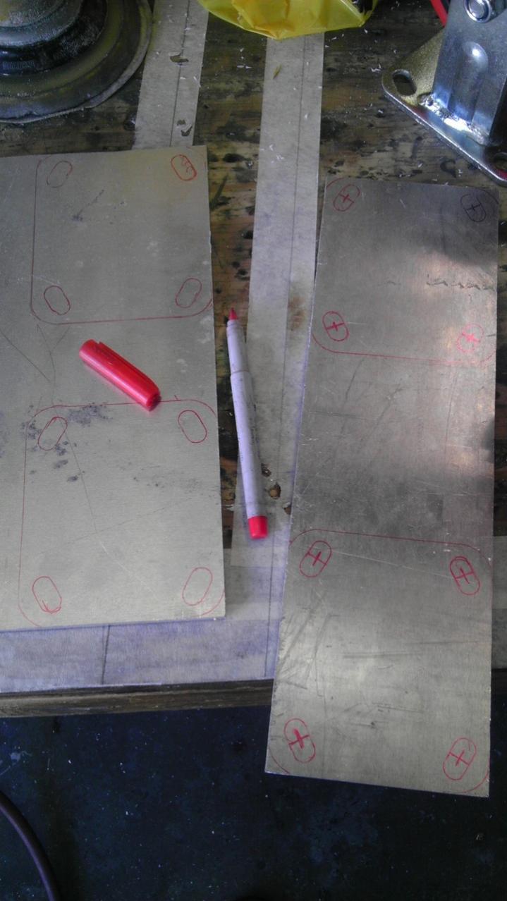

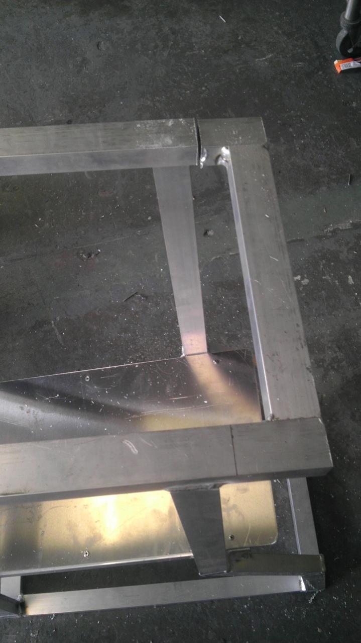

    Pic 3: Of course when you design stuff on the fly you usually come into problems. This is where I had to cut the top front support and move it back. When I put the welder in, the front brace wouldn't allow the front lid of the welder to open fully....ugh. So here it is being cut off to be relocated.

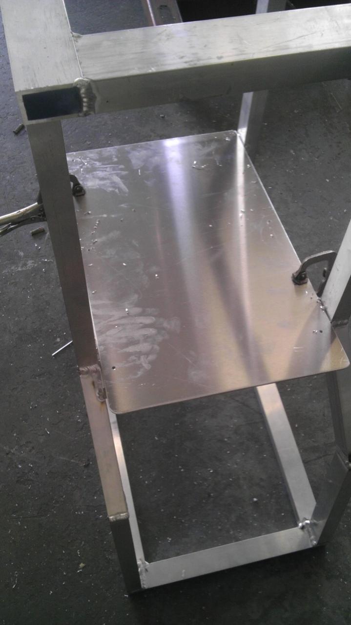

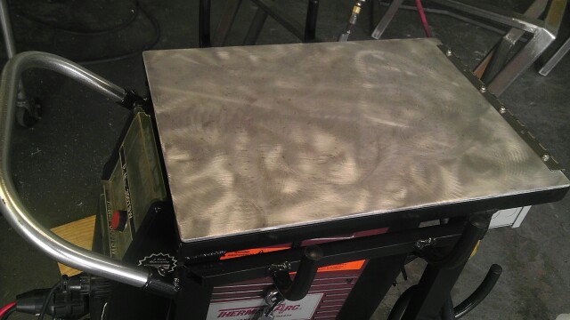

    Pic 4: Front brace cut off and welding shelf riveted in.

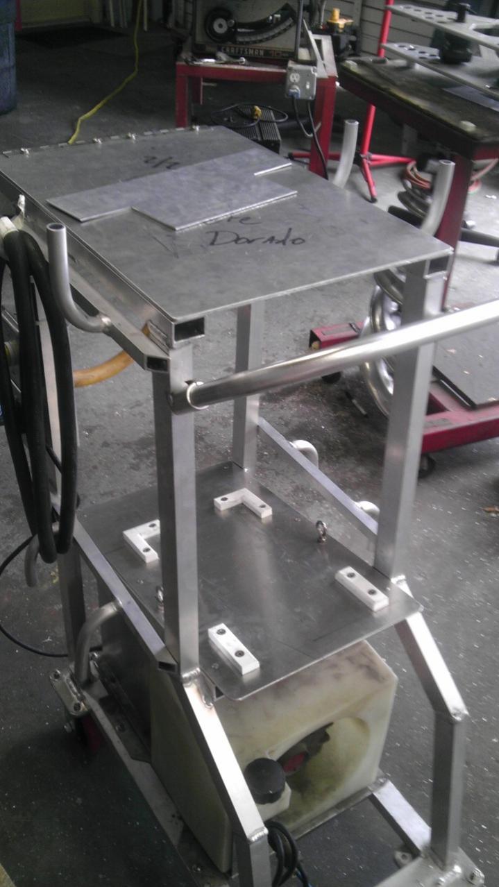

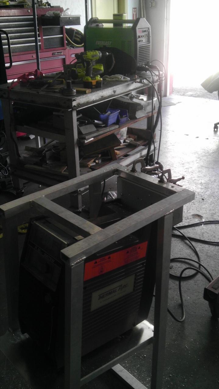

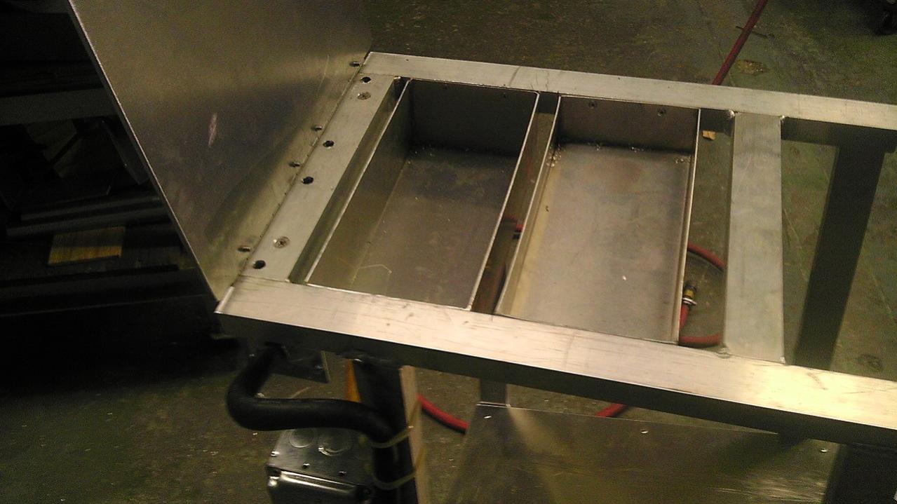

    Pic 5: New brace location. Since the brace is getting moved back, the tray I will insert inside will be smaller and so will the table work top, o well.

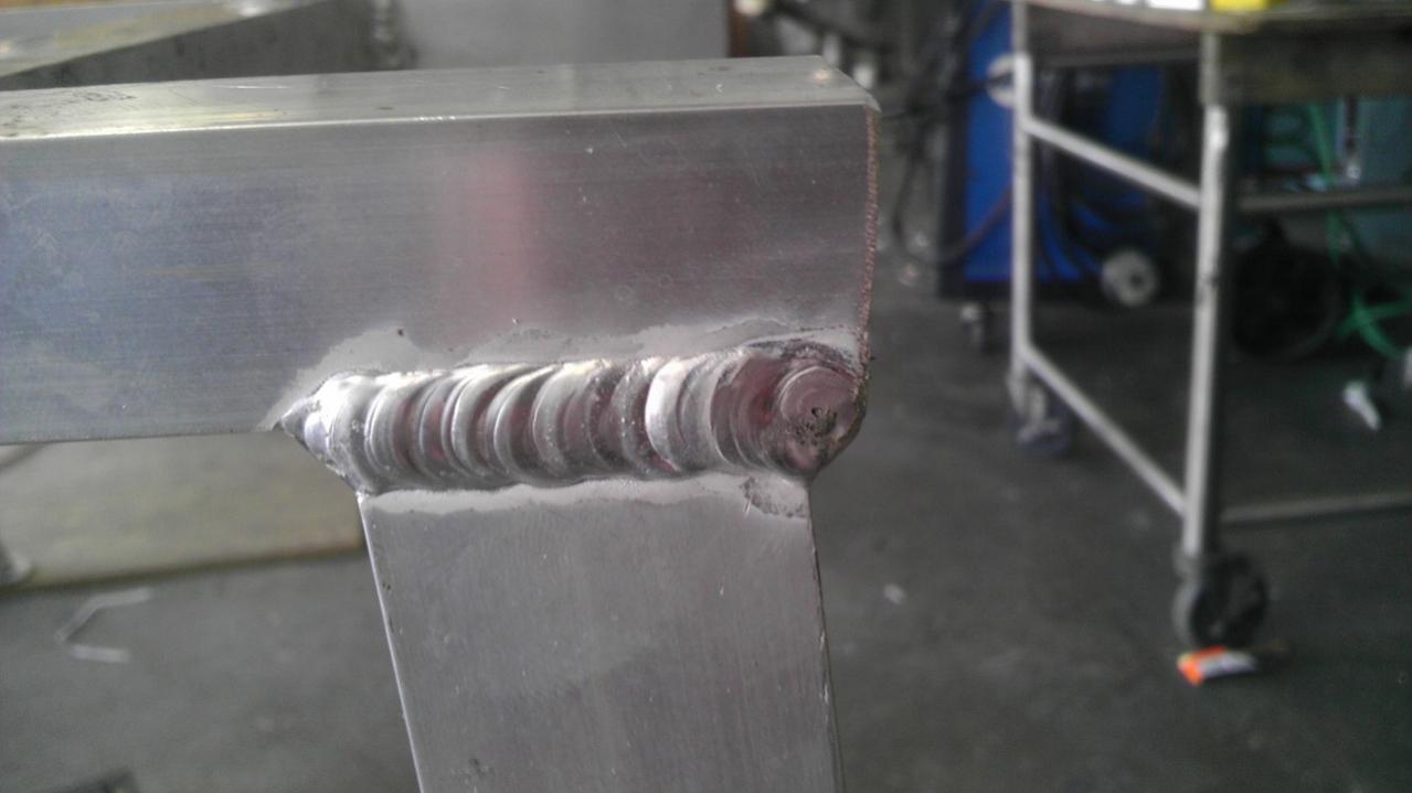

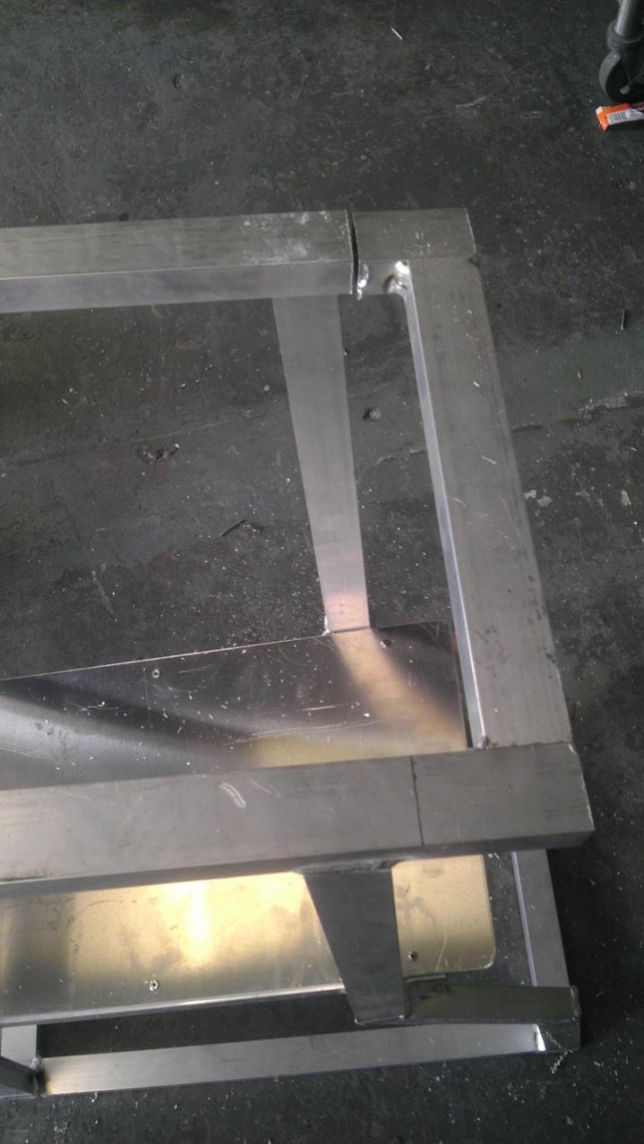

    Pic 6: Quick weld shot

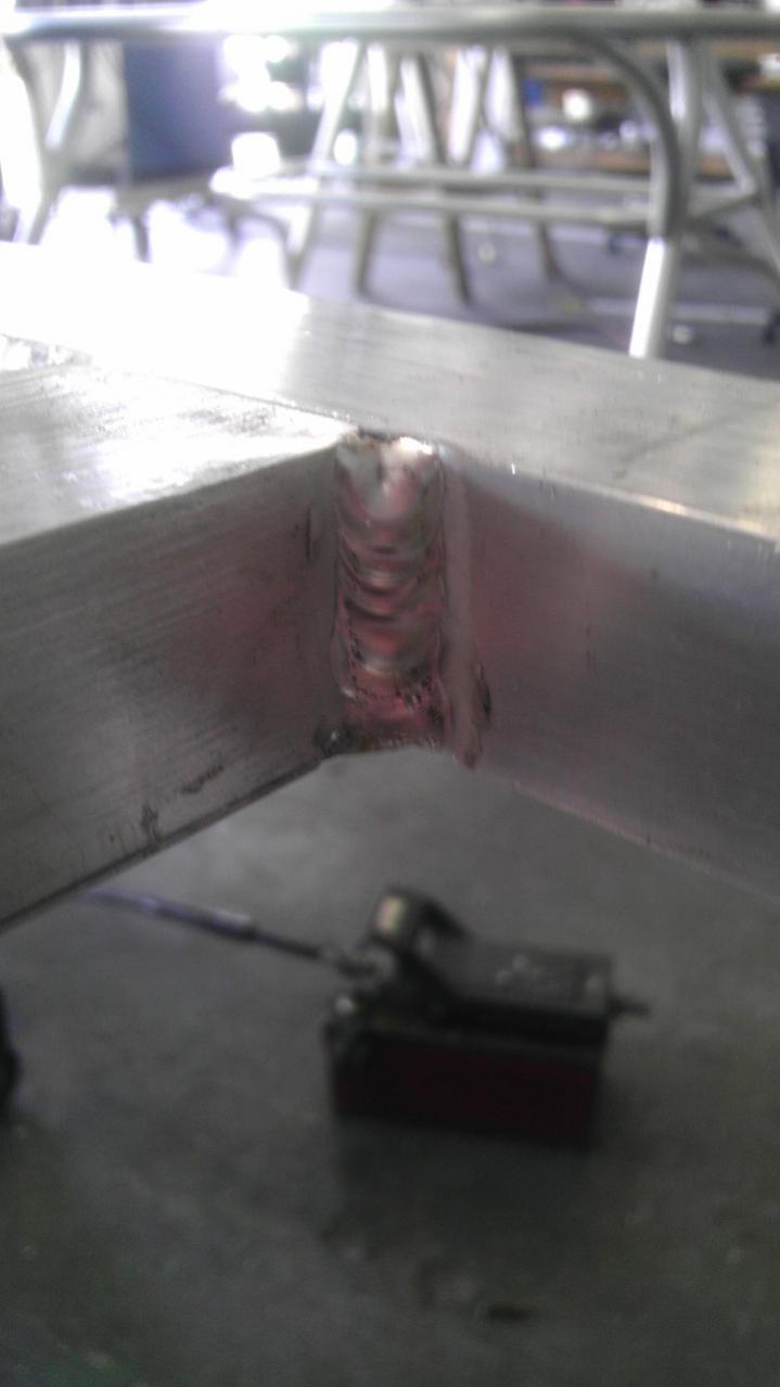

    Pic 7: Another weld shot. I didn't prep the metal at all so all the oil and grease is still on there. Its not my welding cart...lol.

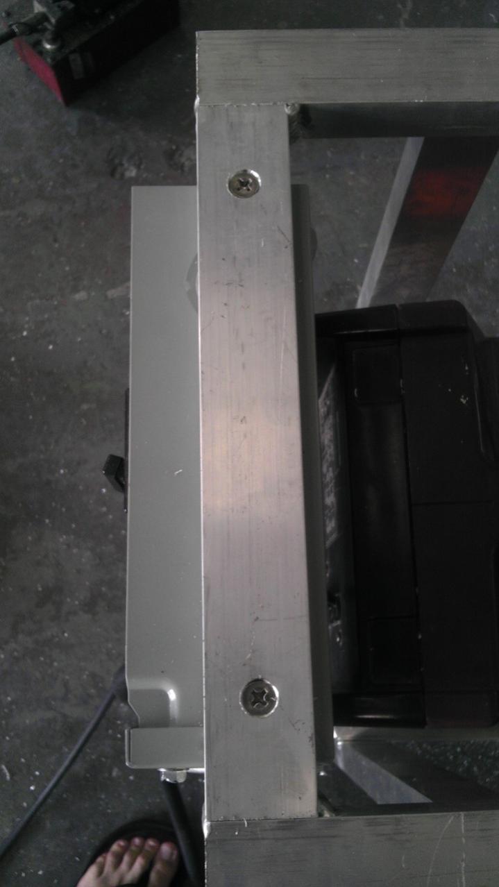

    Pic 8: Breaker box clamped down and drilled ready for set screws.

    Pic 10: Set screws in. Dont mind my not safety foot attire...

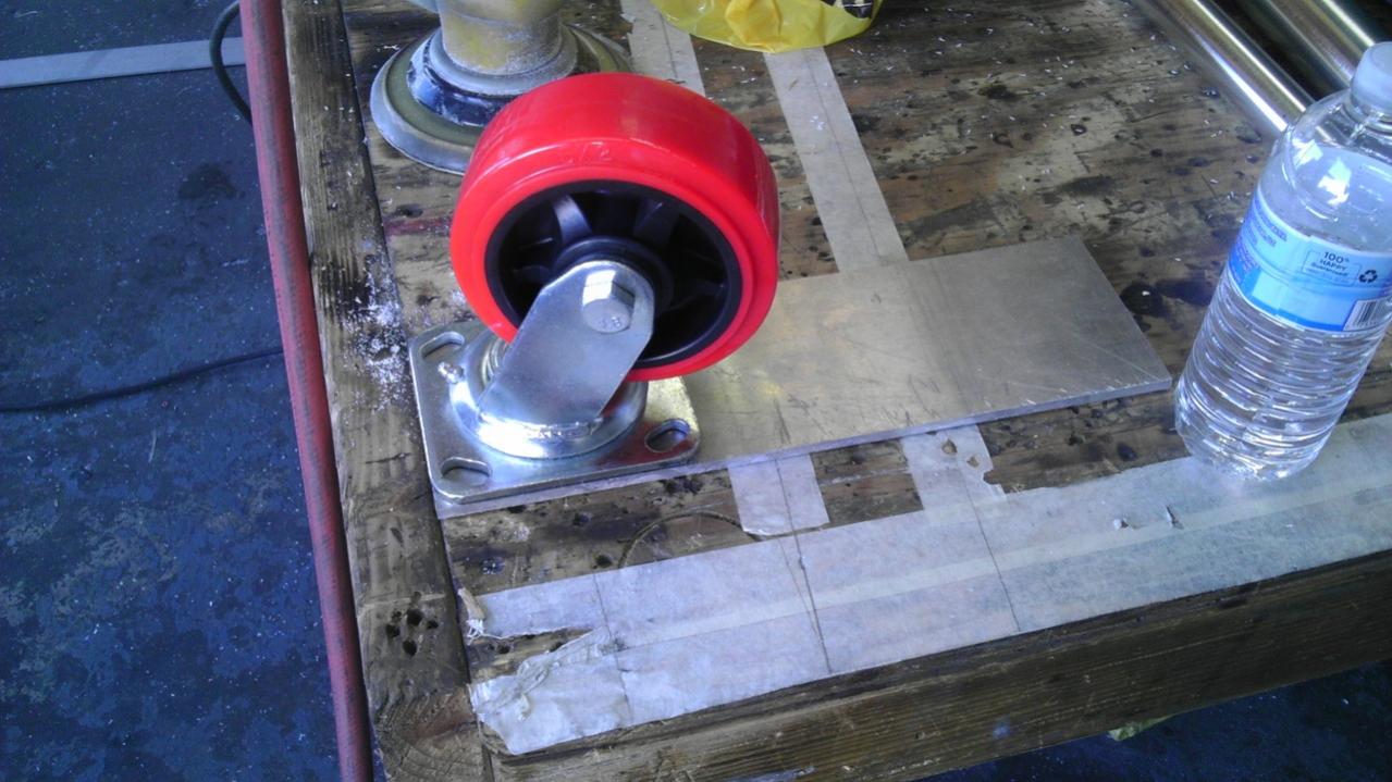

    Pic 11: Went out to grab lunch and stopped at Northern Tool for some wheels. I went rummaging through the scrap he had and was able to find one piece that fit the wheel perfectly for the mounting plate. Just need to do a little trimming and we will be good to go.

    So far so good. I think the design so far is good and I might copy it for when I do mine. I will modify it a little because I will need to add a part for a bottle and I will not be using a water cooler, so I can make that section some more storage with drawers hopefully. Next step is to put wheel plates on, wheels, make tray, make lid with hinges, wire up plugs, add some hooks for cables, and maybe make some type of holder for foot pedal.

    Pic 13: Preliminary wiring done

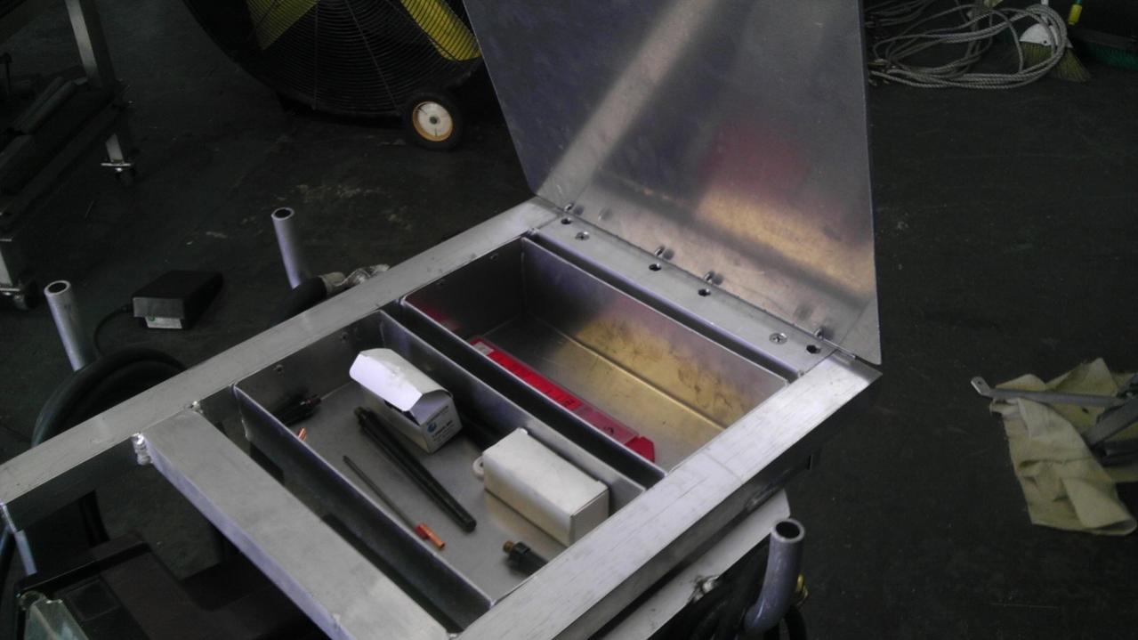

    Pic 14: Trays and top are in
    Pic 15: Work top complete.

    Pic 16: Complete
    Pic 17: Complete with trays having a purpose.
    I was gonna make a little holder thing for the pedal but decided not to for the time being. I dont think I will ever make one for it as this machine always has a switch on it anyways.

    I like the cover on the trays. Keeps all the crud from accumulating in them, yet easy to fish things out.

    Did a little more work. Added a handle and started to make some gizmo to hold the welder down in place.

    Bored on a Sunday so finished welder holding gizmo and painted with some leftover Black hammered rustoleum paint..... Not bad.
