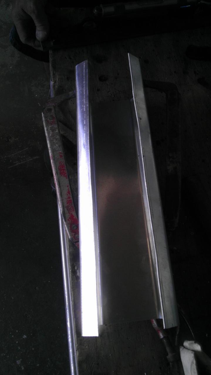

    So I started messing around a little today and decided to make an intake manifold for a friends car. Didn't get any welding in because I am designing/building as I go and its going slow. I had to do the main piece twice because I didn't make my measurements correctly for the bends in the break the first time. When I did the first one it was all twisted and wouldn't have lined up, lesson learned.
    Pics so far:

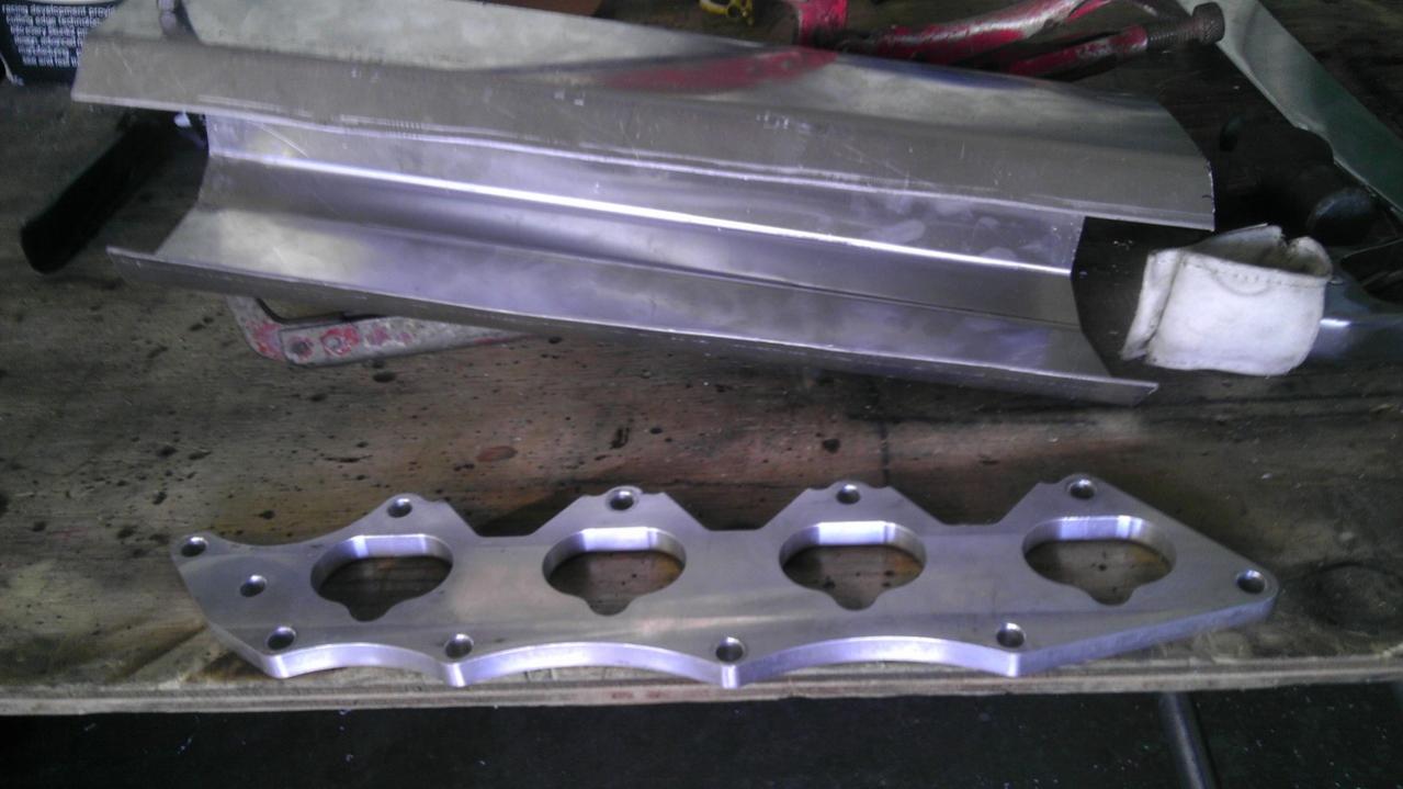

    The flange on the bottom is one I had CNC'd in a batch for when I make ITB manifolds, so I already had it.
    What I am going to do next is cut out a plate for one end and then machine out a 3/8 piece of AL plate for the other end cap where the throttle body will bolt to. Once that is done I will close up the big gap with a piece of sheet and add the runners and then the flange.
    Not much so far for 4 hours of work, lol. If I didnt mess up the first one I would have been better on time.

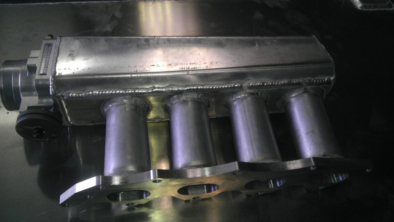

    Figured I would post the finished product up minus the injector bungs. I had to mill those from some solid AL bar. No pictures because I forgot to take some before I put it on car and car is now gone.

    How thick is that flange that you had CNC'd? The end result looks awesome! It looks like you've made a few of these prior to this one, as it looks professionally done. I've messed up more than my share of sheet metal in the metal brakes at my old job. It's really easy to do, especially if you don't mark your bends clearly, or you are in a hurry!
    This post reminds me of how much I want to get an A/C tig welder for welding aluminum and magnesium!
    Heh. I know what you mean. I messed up once in the brake for this one and it was on the last bend...arghhh!!! There are two CNC'd pieces there. The first is the main flange which my friend sells, not exactly sure on thickness. Its either 3/8 or 1/2" thick. The other piece is what the throttle body is bolted to on the left and is definitely 3/8" thick because i machined it myself. It is set inside the plenum so you cant see it from this angle and since the TB is bolted on it.

    That is a cool project. Did you have any issues with the flanges deforming when welding?
    Miller 252
    PowerTig 250 EXT
    Thanks!
    I bolt them to a 1" steel jig to reduce warping. I use the same jig for when I make turbo manifolds. It still moves a little bit even with moving around to different areas of the piece to spread the heat out. The movement isn't enough that the gasket cant fix though.
