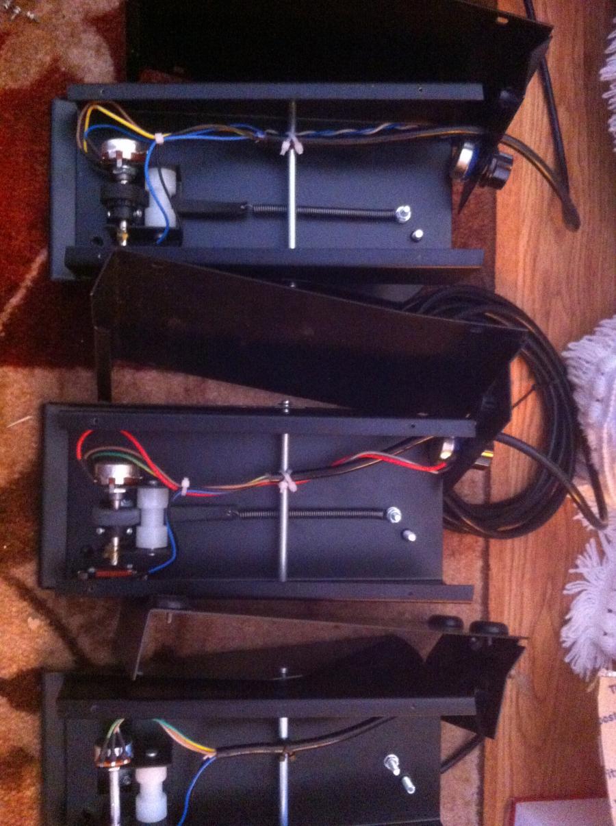

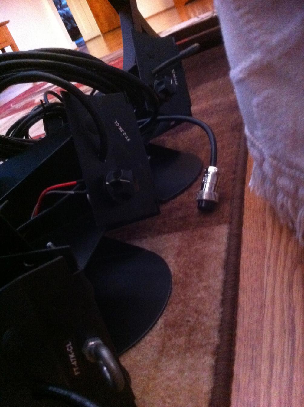

    Alright, so I know that after I post this all I'll get is "Please call the office" but honestly calling the office hasn't worked. Either my welder originally came with the wrong foot pedal, the associate I've talked with doesn't know what's going on or the packaging department doesn't. See the photos for a much better understanding of what I'm facing here.

    The two on the left are the "replacements" i was sent. This has taken almost 4 weeks. The one on the right is my original. The difference is that the one on the right only has one potentiometer that Ohm's out at 47K. The other two have two potentiometers each. One for the foot pedal action, and one twist knob on the outside. The second photo shows (poorly I know) that my original foot pedal has a sticker that says "FT-47K-CL" while the other two say "FT-2.2K-CL"
    So honestly...WTF is going on here. Sorry for the language but I'm beyond annoyed right now. Please explain to me which foot pedal my PT200DX is supposed to have. I only used the original a couple of times and from what I can remember it worked okay. Is the original wrong? Or is Everlast sending the wrong replacement to me? Or is there a third option I've overlooked.
    It depends upon which 200DX you have. If you have a new one, it will have no knob, and a 47k potentiometer in it. IF you have an older one, it will have 2 potentionmeters, one that shows 2.2k and the other will be 47k. It looks like you were sent 2 of the older 200DX which we have just cleared from inventory in the last few months.

    I'll try to help but I'm no expert. I believe the pedals with two pots are the old style and the single pot is the new style. I know you're annoyed but if you'll remain calm I'm sure Oleg will get this straightened out. In my experience, everlast customer service is very good but sometimes there are mixups and delays. I guess that's to be expected in a rapidly growing business. Whomever you talk to, tell them you need the pedal with no knob.
