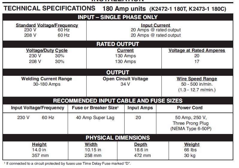

    Hi
    As the title says, I notice the everlast are on there own when the rate there duty cycles, I looked at cigweld and Lincoln electric and both the, rate there duty cycles at full power but not everlast? So wanting to know what the duty cycle is at 200 amps on the imig200
    Cheers
    Chris

    Not sure where you are looking, but Lincoln rates their 180 amp MIG at 130A/20V/30%. And the Millermatic 200 is 150A/21.5V/20%. Virtually all MIGs seem to be rated less than full power and with pretty low duty cycles. I'm guessing because they are CV machines rather than CC.

    Not this 180C. http://www.lincolnelectric.com/asset...473-1/e724.pdf
    30% at 130 amps. Definitely not showing 20%Transformers fall off faster than that.
    From the operator's manual.
    ON the 200 imig you could expect about 10% at max. But that is not official because as I said, it is temporary surge current that is not going to reach that amount of time...it's all theoretical. What's more important is to compare the RATED duty cycle, not the max amp duty cycle for a MIG. That is what is real, consistent and what will be used.
