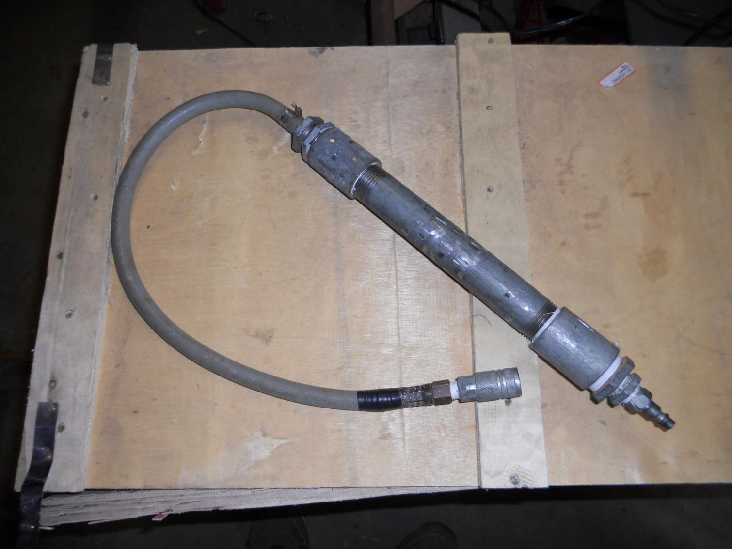

    What's your air pressure running and what kind of extra dryer do you have on the input side? Also what size holes are your tips?
    60PSI
ID:	8792 filled with dessicant.
    .9mm <40A, 1.0 <50A and 1.2 >50A or if I'm too lazy to change it.

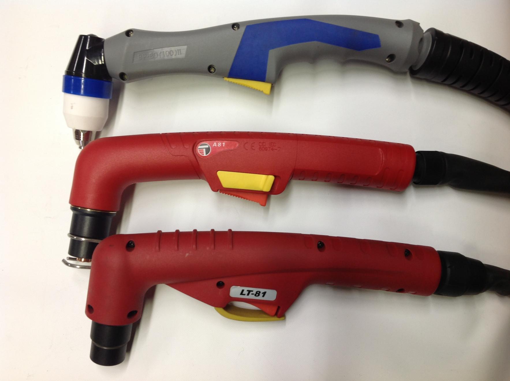

    Luis, these are ERGONOMICALLY designed. They are way better in feel and movement than the competition. Additionally, I have used HT and TA products and their torches in 80 amp are just about as big. Spare parts and consumables here in the US are actually cheaper! Here's an 80 amp kit from Hypertherm at 275.00 for comparison. You get very little.http://www.bakersgas.com/HYP850880.h...FQWFnQodl0QA4A
    And here's the equivalent cup in HT that is a good bit more...http://www.bakersgas.com/HYP220854.html
    A lot of problems are due to the fact that customers fail to run an air dryer on the product, which is a requirement.
    Trafimet makes these parts in different countries. If you can get hold of an original Italian made nozzle, the material may be slightly different.
    Presently in the pilot arc HF style there are. 4 choices the red handled Panasonic p80 is basically the same as the blue / grey torch that some customers prefer for the 70 / 80 amp although consumable life while less expensive does wear faster.
    The innotech L81 uses the same consumables as the A 81 trafimet. Not sure about USA but all our consumables for A81 are genuine trafimet parts

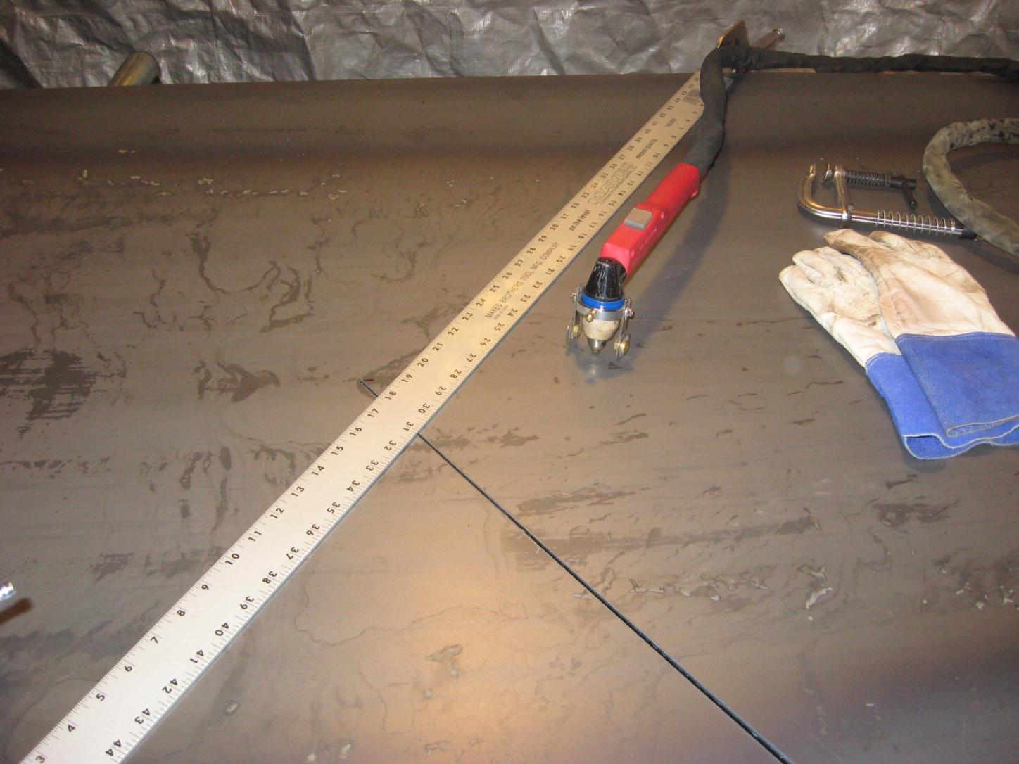

    I use the P80 torch on my PP60... I don't know if it's compatible with the 256. It's plain, simple and gives no trouble. The roller guide is a must have for me.
    Most of my use is between 25 and 40 amps @ 70psi with these 1.1mm tips http://www.ebay.com/itm/P-80-Panason...item5d271c7cf8
    At my current rate of use this consumable set will last me about 20 years since I don't use it for a living and one set has lasted a little over a year. I still have the 1.3mm tips that came with the torch.
    I put the roller guide against the straight edge to get a nice clean cut. 4'x8' sheet of 11ga Click image for larger version.
