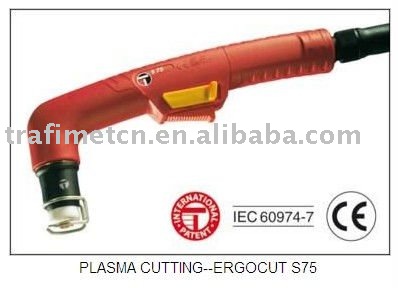

    New units in the next shipment should have an s-75 if they do not now. We are dropping the HF start. Going to the blowback start same as the PP50 currently has. This will eliminate interferance, and reduce maintenance.
    It would be the one that looks like this:

    I'm pretty happy with the WSD-60 that came with mine, but it burns through consumables pretty fast at higher amperages and you really can't get much of a low angle for gouging or bevel cuts. That's why I'm asking.
