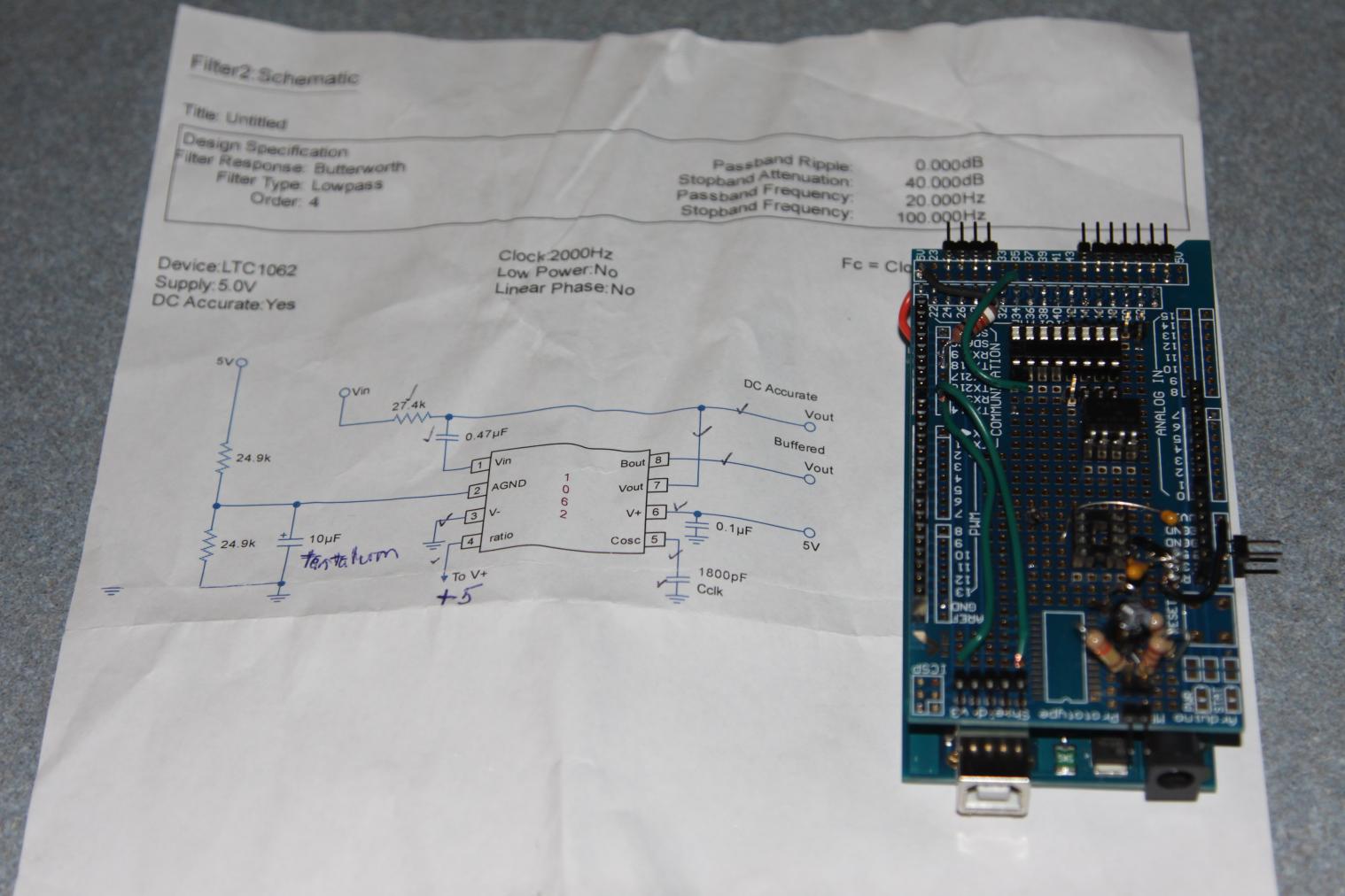

    For pass 2 - I used "Filter CAD", a free filter design application from Linear Technologies. This approach used a passive filter chip instead of an op-amp.
    The differences for the pass 2 design were:
    1) new filter circuit
    2) new voltage divider
    3) added opto isolators on serial output
    4) added opto isolators on the CNC signals (Torch On, Arc Good, Torch Up, Torch Down)

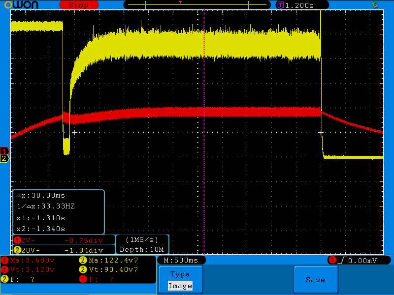

    The picture above shows the Arduino Mega with a prototype board mounted on it containing the LTC1062 analog filter circuit and some opto-isolators. It's sitting on top of the schematic for the new filter.
    The filter circuit did a good job filtering, but the response was sooo slow that it can't be used to servo on. The capture below shows the trace.

    The yellow trace is the voltage just coming off the CNC port. The red trace is the voltage coming out of the filter. (The noise shown on the red trace isn't seen by the A/D. I think that's common mode noise the scope is picking up. The analog read of the value is pretty stable.)
    On the trace, each square horizontally is half a second. You can see that its taking well over a second for the red trace to reflect voltage changes in the yellow trace. So, this filter doesn't seem to do the trick.

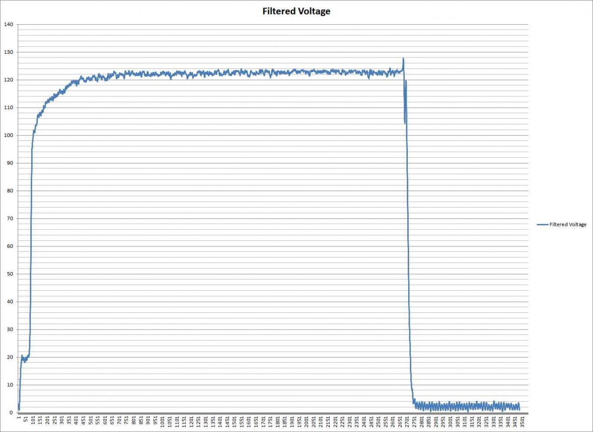

    This is a capture of serial output from the Arduino. I had a lot of data corruption using TeraTerm to capture. I had to delete a lot of corrupted data, but I think I got a reasonable representation of the filter output.
    The capture below shows the analog reading that was filtered by the hardware and then by the software using a sliding window average of 5 samples. The averaged value was then converted to volts input (analog count / 7).

    The x-axis numbers are sample numbers not time. From the time the voltage initially hits 110V until it drops is about 3.3 seconds of elapsed time.
    You can see that the reading has about 2 to 3 volts noise in it. But, because there are so many samples, I think that can be smoothed either with a hardware filter tweak or a larger software filter sample size.
    I'm confident that this can be made clean enough for decent control.

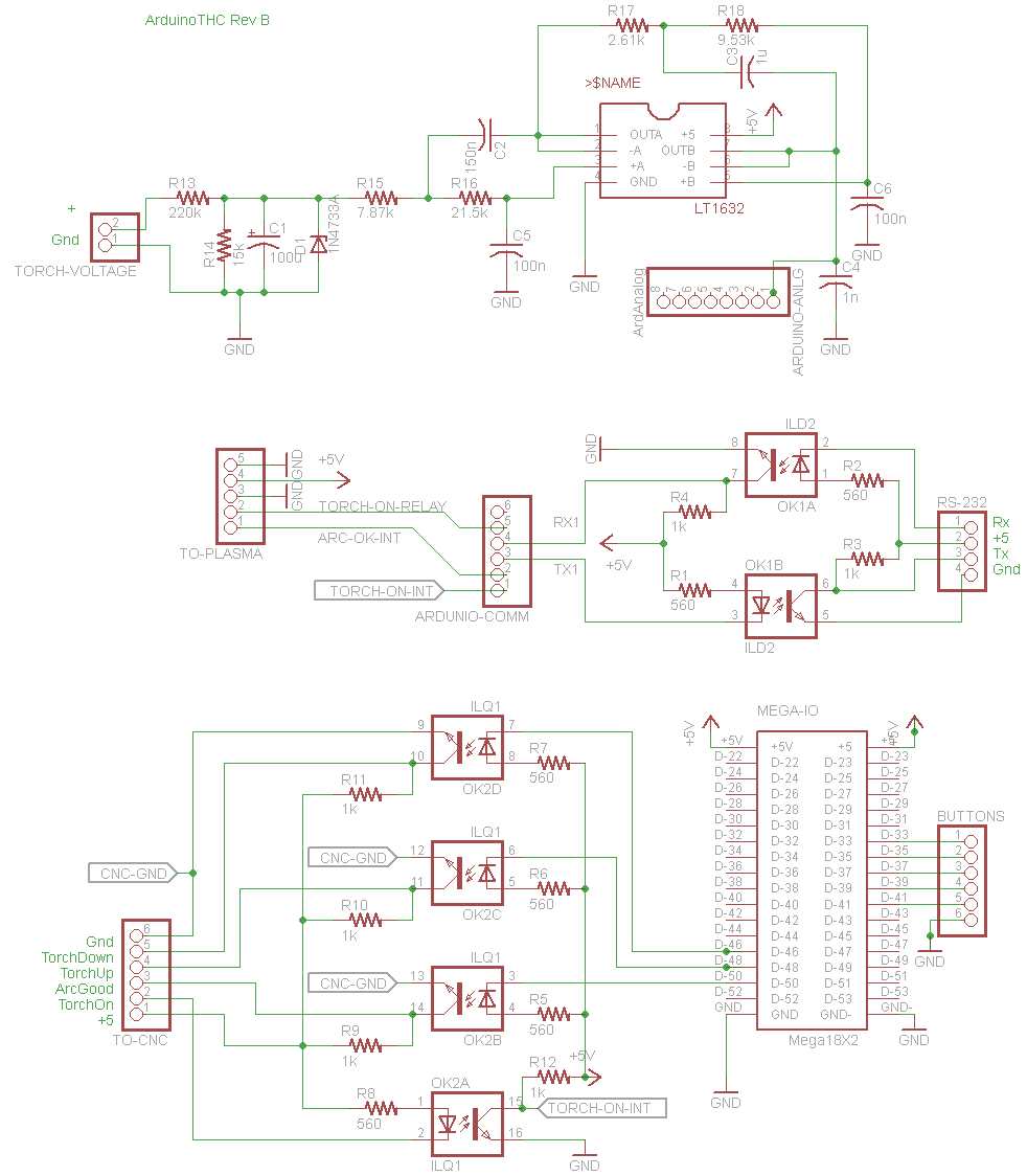

    Here's the schematic for where things are today. I just sent out boards to be built and then realized I forgot the overvoltage protection for the torch voltage input.
    This copy of the schematic has that update. (Use at your own risk. I'm not an electrical engineer, but I stayed at a Holiday Inn Express last night.)

    The top block of the schematic takes the full voltage input from the CNC port and divides it down. It is scaled to cutting voltage instead of max voltage. This gives better resolution on the analog to digital conversion. There is a zener diode to protect the circuit from over voltage. The rest of the block is the filter using an LT1632 op amp. C4 is a spare that I haven't needed yet, but wanted space for on the board.
    The middle block of the schematic shows two things. First is wiring of the Torch On line from the CNC controller and the Arc Okay from the PP50 to the digital inputs that support interrupts. The second part of that block is optional and is optical isolation for a serial port.
    The bottom block of the schematic shows optical isolation for the CNC Signals (Torch On, Arc Ok, Torch Up, Torch Down) and the connectors for the buttons.

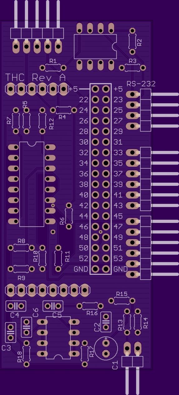

    When I uploaded the file, the web site gave me a sample image of what the board would look like.

    It shows board under the pin connectors on the top, bottom and right side, but that shouldn't be there. All the pins stick out past the edge of the board.
    This board fits on top of an Arduino Mega with a 2 line LCD display shield next to it.

    Now that I have the boards and am debugging them, I found a number of errors in the schematic.
    A number of them are just signal name errors, there are some resistor value errors but so far only one layout error in the serial port opto-isolator. I've switched the Tx and Rx lines between the Arduino UART and the opto-isolator.
    I'll post an updated schematic later when I've finished debugging and tuning everything.
