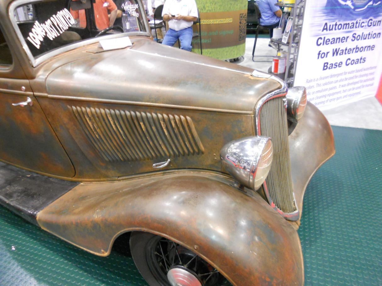

    The first thing that I thought was that the nice shiny restored wood bed wouldn't really go with a patinaed body, but then I remembered this bad boy:
ID:	8728Click image for larger version.
    and sorta changed my mind.

    The bed is very easy to pull out so if it does look goofy I can change it pretty easy.
    I tried to rough up the paint for an aged look but I still didn't like the look.....
    Now I'm letting it rust before I seal the body. This was about two hours after I stripped the paint, should look pretty good by monday.
