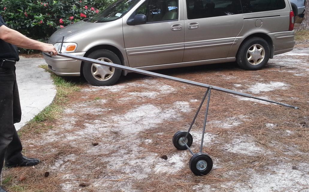

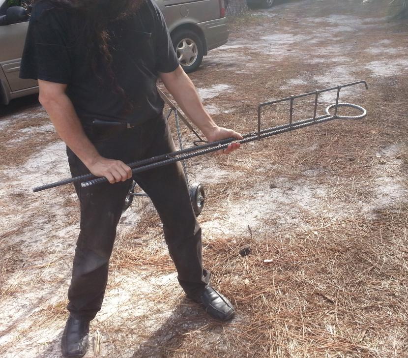

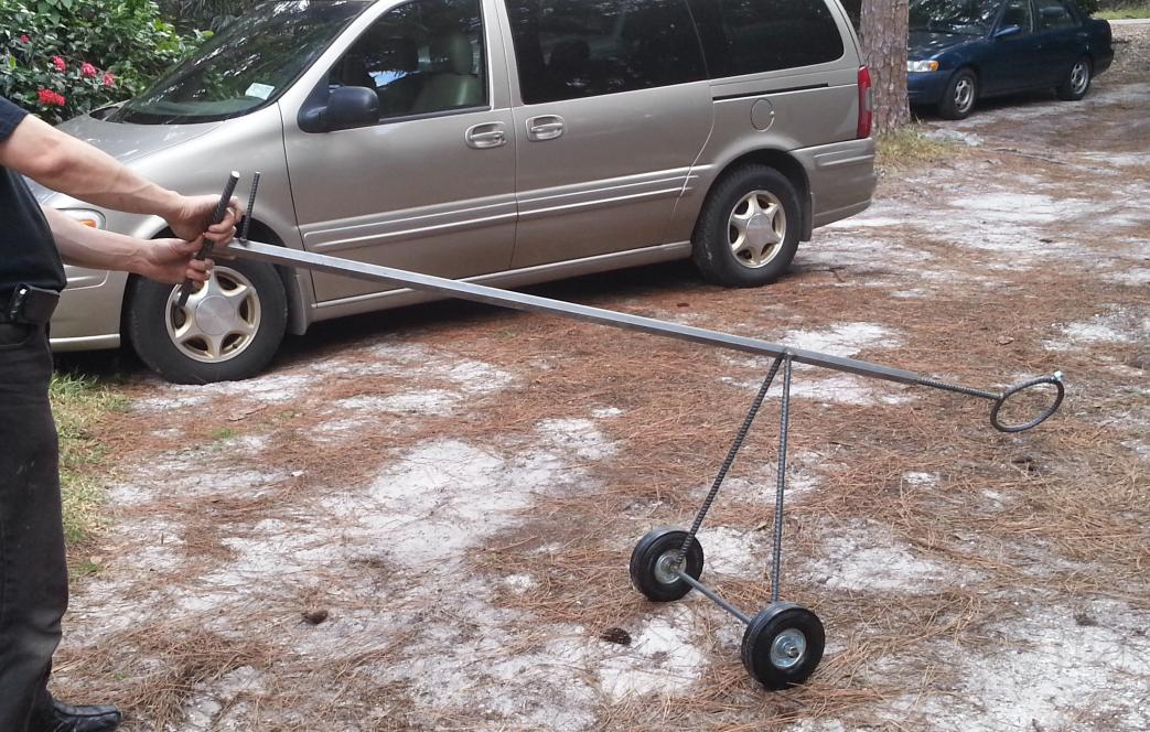

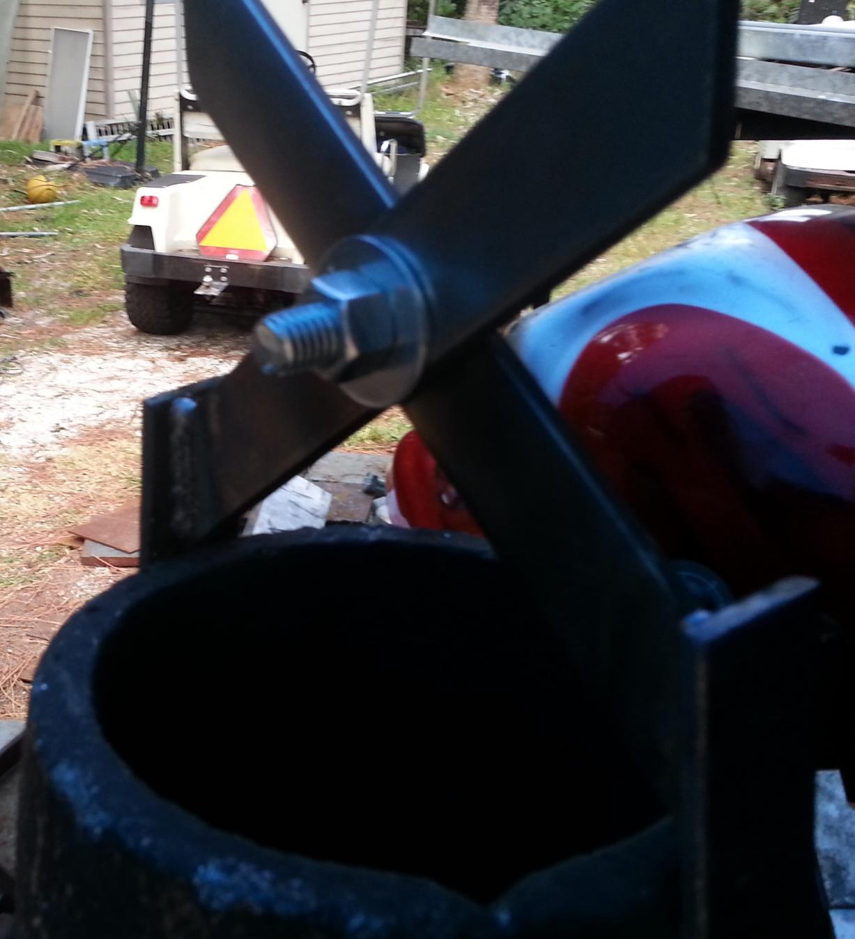

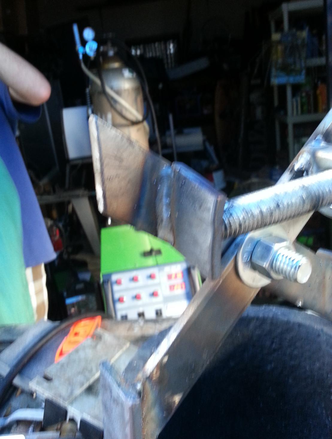

    Has a person that wanted some tools made, figure I would post the final tools. Rebar, steel plate, nuts and bolts.
    One a to pickup the crucible, other to are to move and pour the metals. He invited us to come see them in action, will get more pictures then.

    Very nice. I really like the wheels to carry the weight, hold it nice and steady, and keep the operator far away from splashes.
    Being able to cast metal opens up a large new project list. I would be careful with the wheeled one there is no retainer for the crucible and it may fall out near the end of pouring.
    Thanks Tom, I totally missed that. I will contact the customer and let him know.
