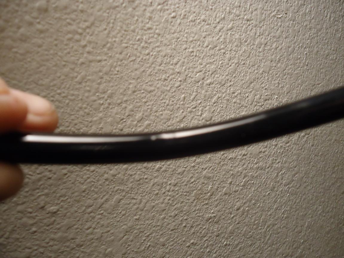

    Was trying out my new 200DX appears to be a great machine . Using with a couple of different torches i have and i am having a gas problem with one torch. I have a WP-9 flex head 3/32 tungsten # 6 cup argon 15 cf ,welding some mild steel at 75 amps welds great clean bright welds very nice. Switch over to the WP-17 Torch same tungsten nozzle ect. and there is a gas problem lots of porosity in the welds dirty looking not bright. Tried replacing collet collet body tungsten ect. ????. I took the gun apart found one spot in the hose that did not look right and repaired it . No Luck still the same problem.

    Check the o-ring on the torch back cap.
    Been in there from both ends, Just went out and checked all the removable parts on the torch they all look good nothing mismatched or wrong. I am going to pull the cover off the cable and look at the gas hose in the morning. It is definitely not supplying a steady volume of gas , I can change the way i am holding the torch or move the torch lead and get gas to flow.

    The problem is with the gas supply hose, The hose has a small imperfection from when it was made about every 4-6" on the length of the hose in this euro style 17 gun. The small spot that i am trying to show in the photo has a thinner wall thickness and will collapse and close if it bends. Looks like it was too hot or possibly got some air in it when it was extruded where it was made. This spot was right at the end of the torch handle and would explain why moving the torch around or letting the weight of the rest of the torch leads hanging on would give me restricted gas flow. This is a Euro style blue handle 17 torch with 12' leads.

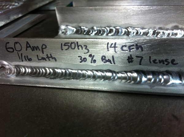

    cbmkr , I used the stock torch at 200Amp for short duration welding 1/4" to 1/4" and also with 1/4"x 3/8" plate, the machine was very capable and did not thermal before my hand would be unable to hold the torch, hot it certainly was. Thick gloves helped me get through it. So far I love the machine and I was practicing really thin stuff like below which is really my first intention of getting a tig machine. I have about a total of 12 hours of argon flow. That .05 aluminum plates is not easy make T-joints one of my biggest troubles so far, I am okay with other joints but fillet welding is not so easy with my noobness.

    Cut the bad spot out of the vinyl tubing on the 17 torch and it mostly stopped the gas problem, If you get the hose rolled over your arm it will bend enough to crimp the hose tight enough to mess up your gas flow. I thought about adding a spring cover to the tubing to stop it from bending but did not have one around in the shop anywhere. It only seems to bend right at the end of the handle.

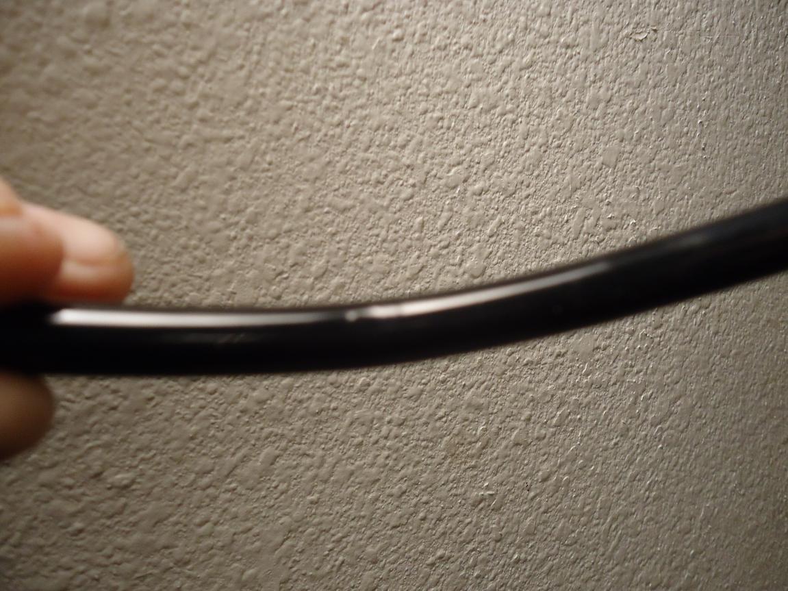

    It sounds like you might have a torch overheating problem, like I posted about here: http://www.everlastgenerators.com/fo...=4899#post4899
    The WP-17 is not spec'ed to handle the output of your 200 amp @ 60% duty cycle machine, so if you ran it at high throttle for too long, you probably melted the inside of your gas hose. A "weak spot" or nonuniformity in the hose wall thickness seems to be a giveaway. IME, the shielding gas gets contaminated, in particular when the overheating is occurring (e.g., when welding thick aluminum.)
    Watercooling is overkill for a 200 amp machine, IMO, when CK worldwide carries a quite nimble, capable, and reasonably priced aircooled torch (the Trimline 210 with superflex hose option) that can do the job just as well with much less cost, complexity, required maintenance, and also while providing a more portable welding setup. FWIW, the CK Trimline 210 superflex cable has about the same outer dimensions and overall flexibility as the current vinyl style WP17 setup you've got, just with a bit more density due to the larger copper conductors inside.
    No overheating it was a brand new Euro Style torch that i have had for sometime and not used , When we tried it on my new machine we were having gas issues immediately and started looking for the problem. The torch had just been taken out of the box and the plastic bag it came in.We were using it at 95 amps. The tubing was defective and bad the full length of the torch and had spots every 4-8" in a spiral around the tube. It is a manufacturing problem where the tubing was made. The DOM process that is used to make this tubing can have problems with the base material being to hot or the tube being pulled to much from the outgoing side of the die. It is made using the same process as adding the shielding to electrical and welding wire ect.
