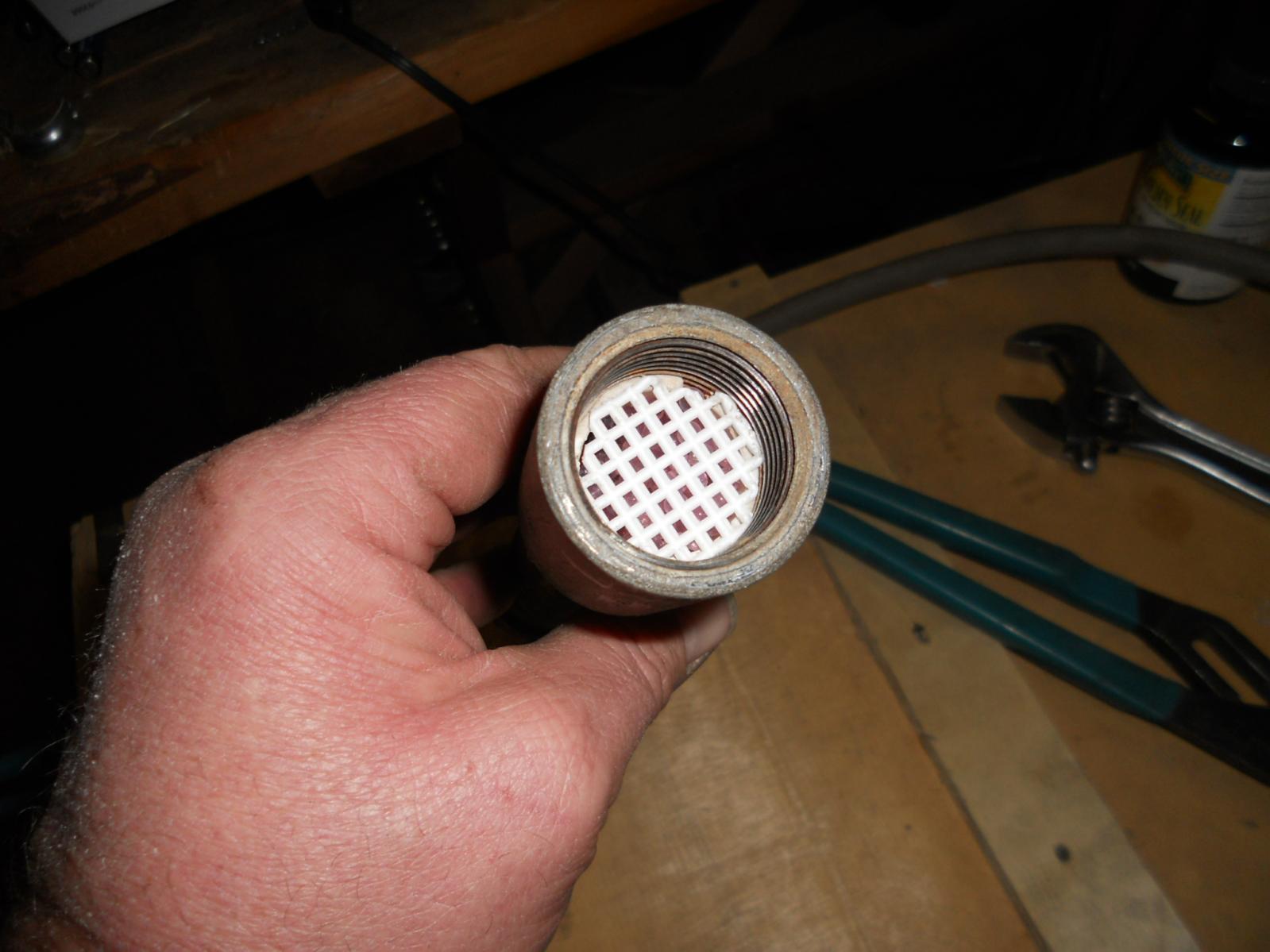

    I recently purchased a Harbor Frieght Descicant filter for my SC50P. Now I get a 25 PSI pressure drop. I am getting old so I do not recall what the pressure drop was before I added the HF Filter. Has any one experienced this? My Compressor is 5 HP 80gal tank so it is definatly not a supply pressure issue. On the SC50P I have an Inline water seperator then the Regulator (comes with the unit) set to 60 PSI currentlyand then the HF filter.

    Solved! It is the filter that is pressed into the inlet side that is the problem. Just take it apart and tap it out using something thin and stiff for a punch.
    It is kind of surprising how little dessicant there is in there, we will probably wind up recharging/refilling these things fairly frequently.

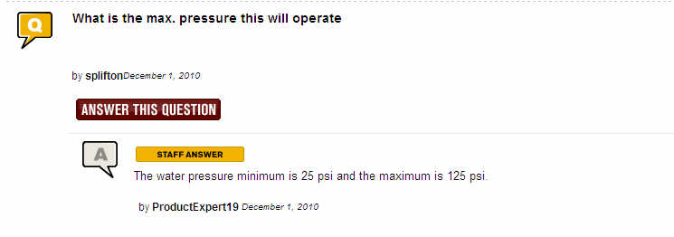

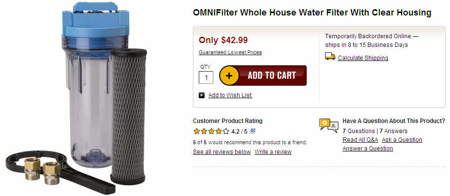

    May I suggest using a home water filter like attached and fill it with desiccant. You will be able to see the color change and the volume of air should be just fine for plasma. I comes apart easy for desiccant refurb, just remember to use the standard filter for these units to stop and desiccant dust from passing through to the torch. As the attached shows it is rated a 125PSI. Can be found at Lowes & Home Depot and other places.

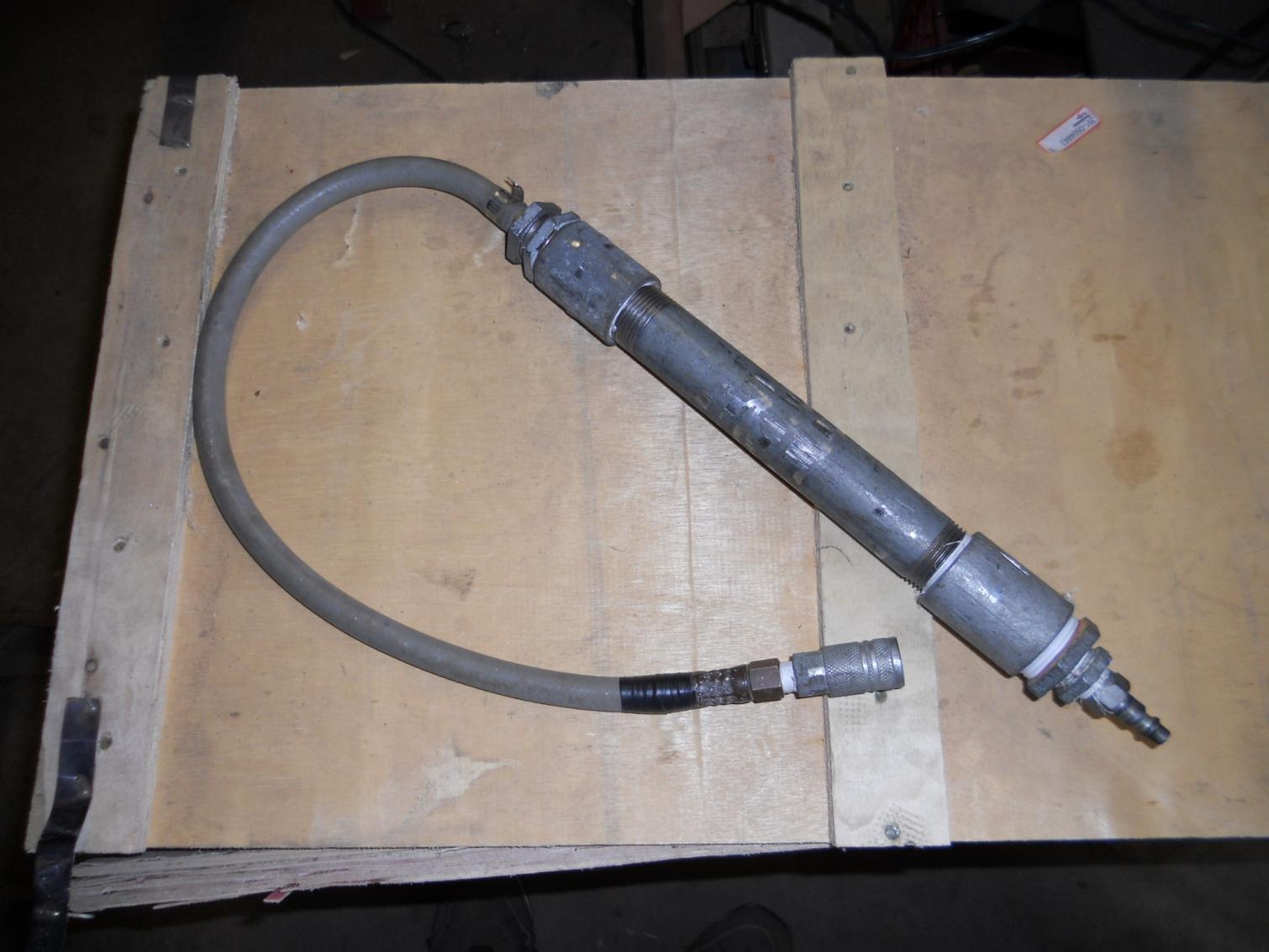

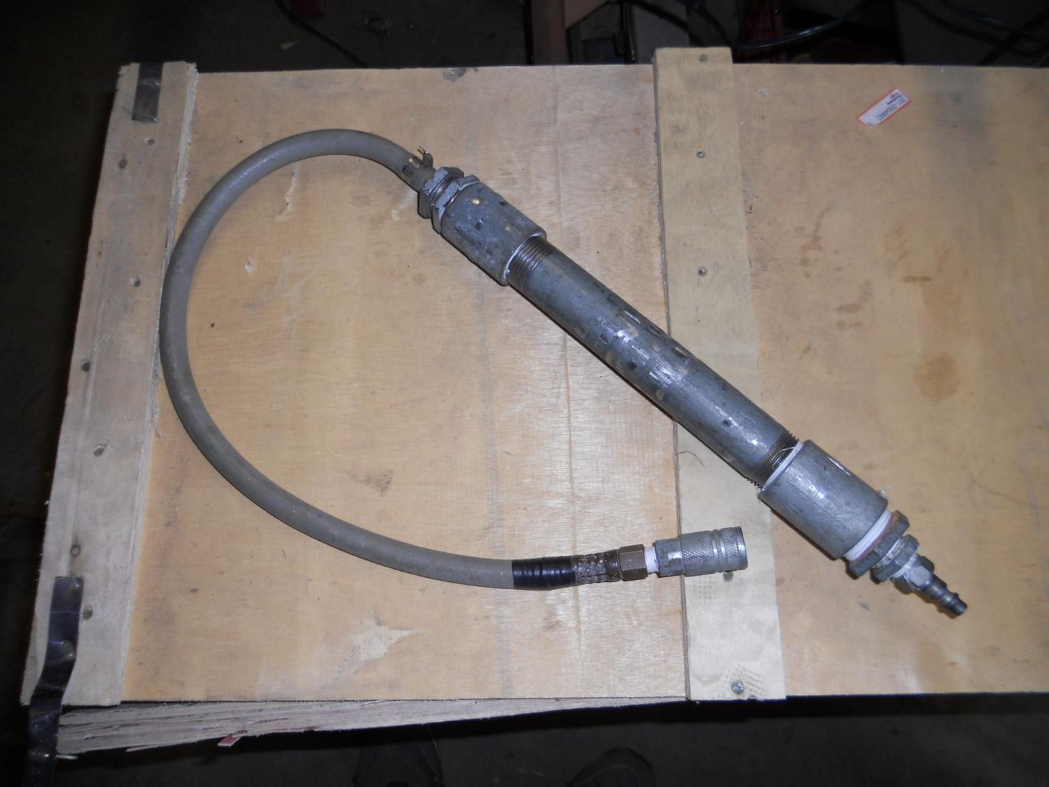

    This is my primary dryer at the moment:

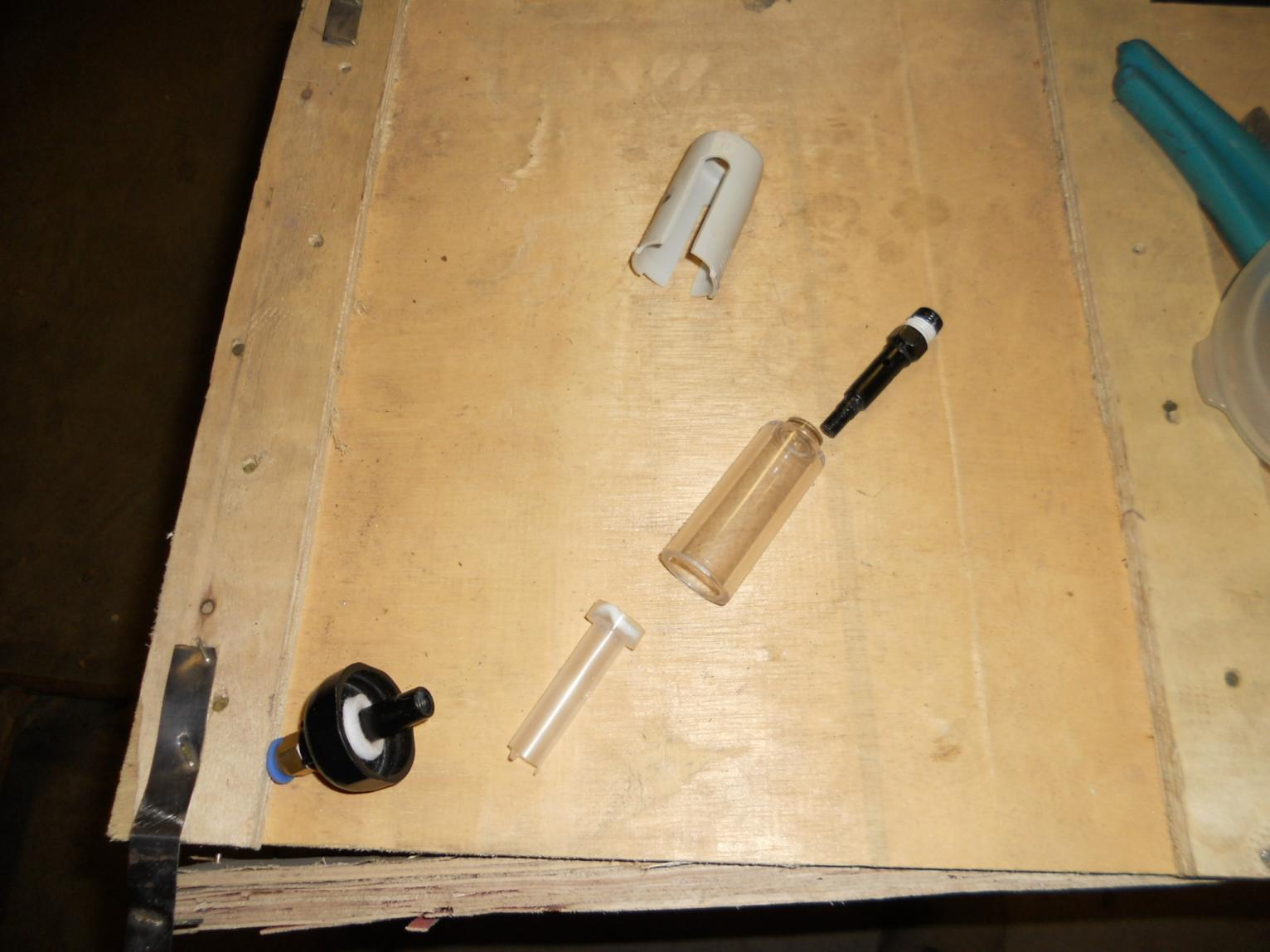

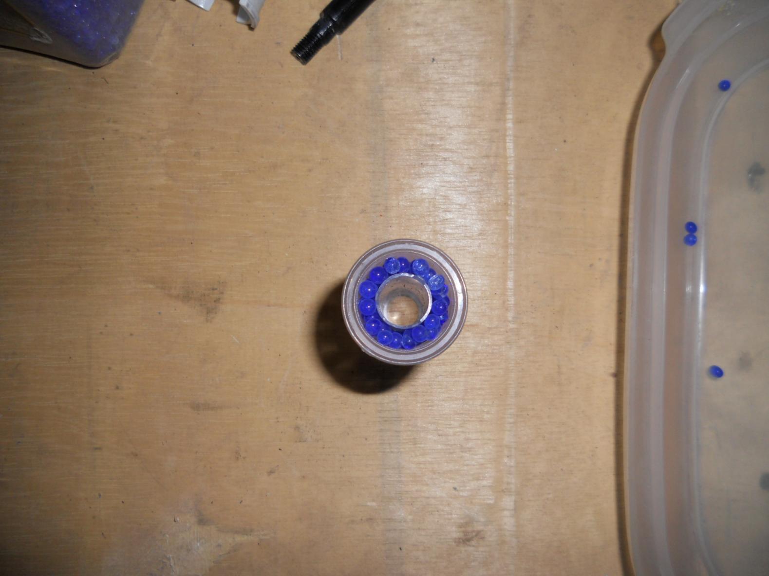

    This is the HF unit in pieces:
ID:	8797Click image for larger version.
    Not enough in there to dry much air at all. It will go back on as a secondary though.
    I removed the filter and it does make a difference. I have a typical glass oil/water seperator ahead of the regulator that I am going to fill with desicant. It will probably hold 10 time the amount in the HF filter. I ordered a pound of dessicant for 17 bucks shipped.
