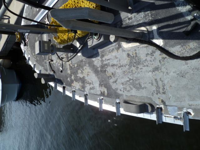

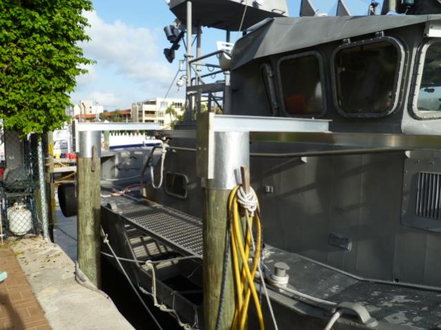

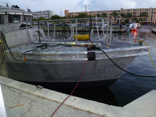

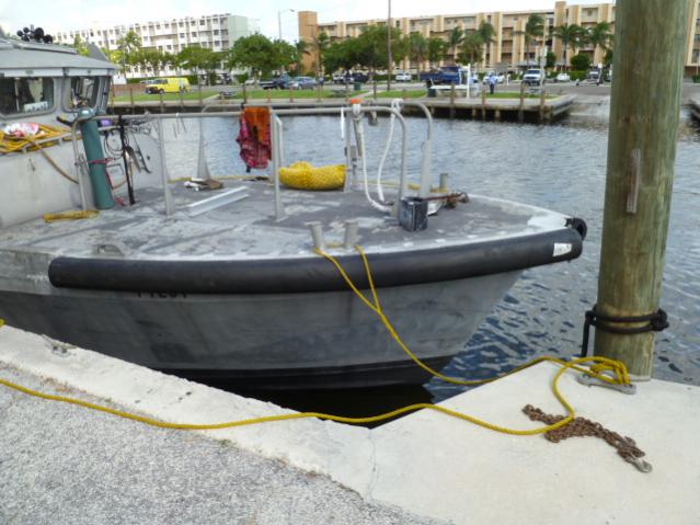

    strange advice on these threads. the guy has a 200 dollar spool gun (which surprisingly has some pretty good reviews). from what i read it will serve his purpose and save him some money.
    show up on a job with your tig machine, at xxx dollars per hour and tell them you arre going to do the weld out with it. lol

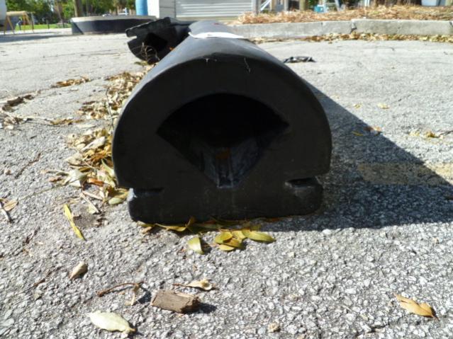

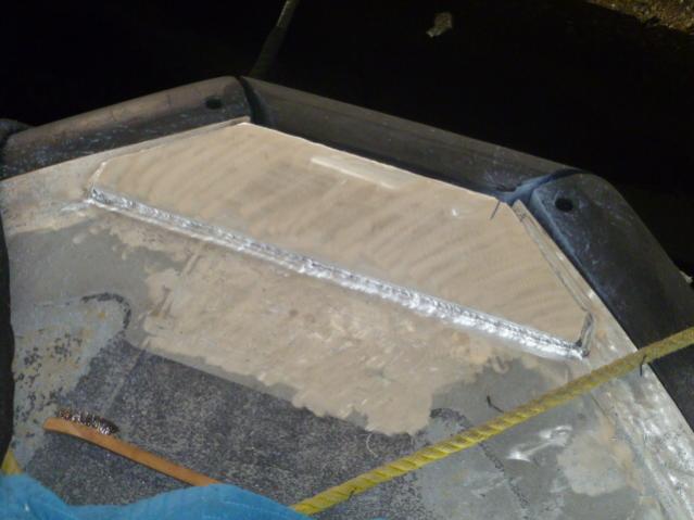

    i used almost 20 pounds of wire on this job. rub rail was so heavy i used the pilings to support a trolley setup with two chainfalls then a comealong at the bow to pull it in.
    that plate used to retain the piece of rail at the bow in the last pic is half inch to three eighths. it took less than an hour to put in three passes. i've done a ton of this stuff.
    not in any way implying that tig welding not important i know it is but believe me, there is no more cost effective way to lay in aluminum wire than a spool gun.
