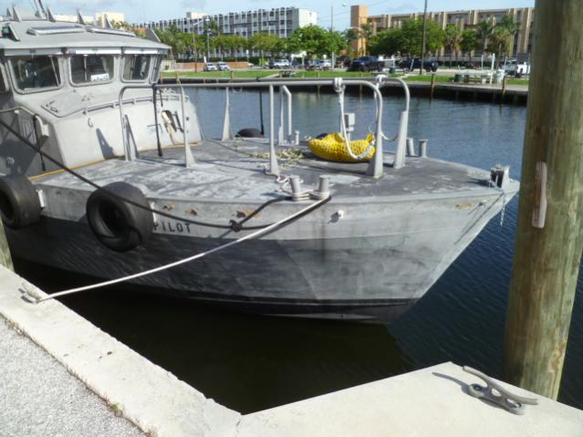

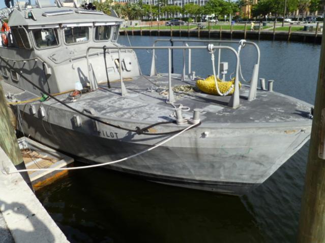

    We have a 250EX and *210EXT and a *IMIG-200 and IMIG205 with spool guns for aluminum (* is the ones used most these day). Really depends on the job, but the MIG is normally the winner unless small detailed work or odd metal type is required/used.
    fdcmiami: What did you use to groove and clean the salty boat?
    i used 36 grit flap discs for most of it. sometimes i'll use my skill saw when i have a clump of something, i lay it at an angle and drag it across the weld. cleans up fast, better be holding on though. i use cheap seven and a quarter in blades.
    i own a 250ex, very happy with it, and use it when conditions warrant its use.

    strange advice on these threads. the guy has a 200 dollar spool gun (which surprisingly has some pretty good reviews). from what i read it will serve his purpose and save him some money.
    show up on a job with your tig machine, at xxx dollars per hour and tell them you arre going to do the weld out with it. lol
    i used almost 20 pounds of wire on this job. rub rail was so heavy i used the pilings to support a trolley setup with two chainfalls then a comealong at the bow to pull it in.
    that plate used to retain the piece of rail at the bow in the last pic is half inch to three eighths. it took less than an hour to put in three passes. i've done a ton of this stuff.
    not in any way implying that tig welding not important i know it is but believe me, there is no more cost effective way to lay in aluminum wire than a spool gun.
