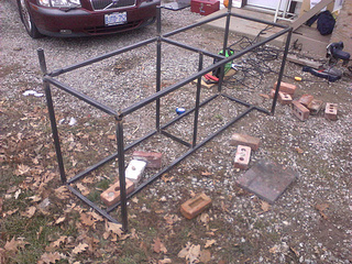

    How it looks now. All that's left is the top and to put in some braces and hardware.

    So the top still needs to be done. I'll probably add 2 more crossmembers to support the top and some gussets as bracing. Here's a list of other future improvements.
    Backsplash, reinforced plating for small vice, dedicated lith for welder, shelving for clamps, electrode / ground holders, Dedicated ground point, 120v outlet.
    Anyways, baby steps. Lets find a top plate first. I'm thinking 12 guage but we'll see what the metal shop has for sale.
    Cheers.

    Looking good so far I think. The first time and maybe the second and third is always the best when building stuff.
    2013 PT-200DX
    Ryobi Drill Press
    8" Shear
    6" Bench Grinder
    4x8 CNC Plasma Table
    Looks like it will work nicely for you. Some closeup weld pics might help to offer suggestions. Was the rod sticking when it cutout? What amperage were you using? How tight was your arc? With new clean metal you will probably find it easier to learn with 7014 or 7018, even 6013 will leave a cleaner finished weld than 6011. Where 6011 shines is burning through rust, mill scale, paint, and whatnot. Also for deep penetration with less power. Something that will be great with 3/8" or 1/2" plate for a little box like the 140ST. 12ga. is not bad for a top, but if you intend on being able to pound on it, you might want something a little stronger. If it's just a place to put things and you don't plan on clamping much too it, then it will be fine, especially with some bracing. If you plan on welding your top on, be sure to just do short stitch welds of about an inch or so and move around to keep the top as flat as possible. It really doesn't take much to secure it. You can post larger pictures without issue because of the thumbnail setup. Kinda hard to see what you have going on. Look forward to seeing how it all comes out.
    The stitch welds will allow you to keep warping down. Also allow you to remove and replace the top easier. On the shop size, you have to start somewhere. I would use 6013 as my goto, but 7018 will make for a nicer looking weld when you get started.
