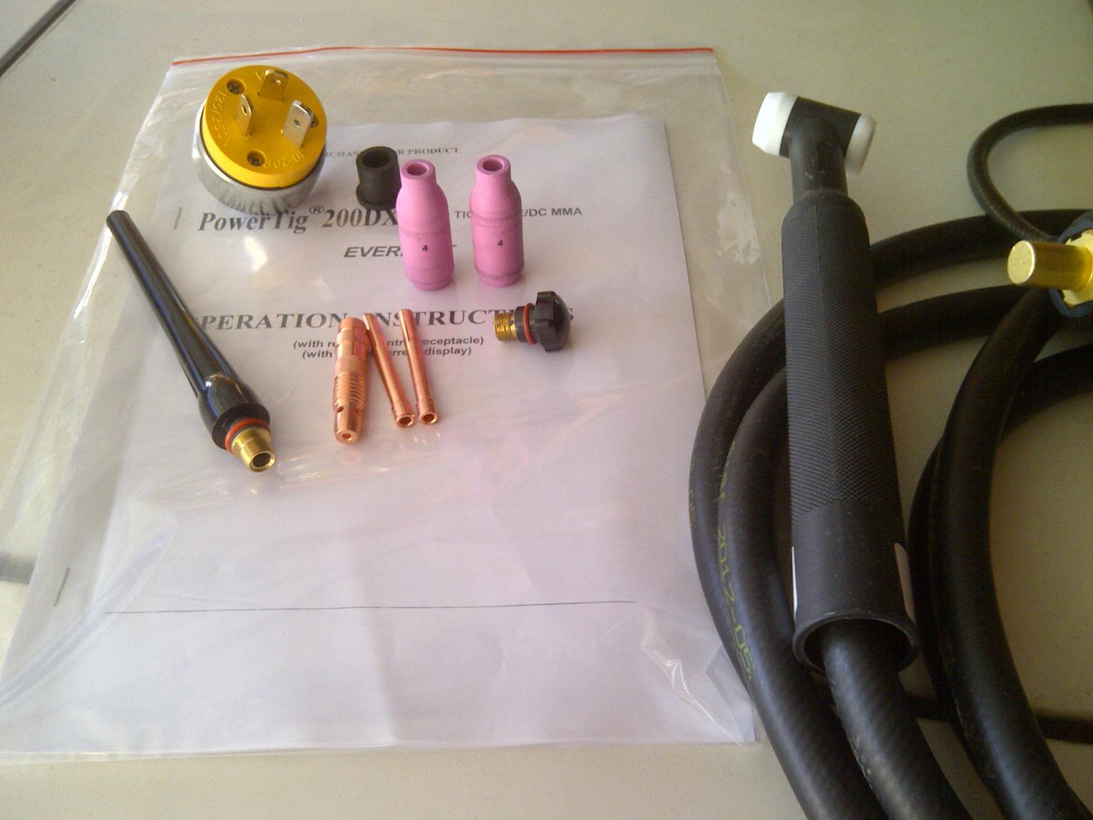

    What is exactly included in the starter pack? I see that it has 2 back caps, a collet body, 3 collets and 3 different cups. My main question is what size are the collets/collet body? I am going to buy some tungsten and other consumables so I can start welding X-Mas morning with no waiting. I just need to know if I need to order 1/16 collets and tungsten if the ones that are included are 3/32 etc.

    I use 3/32 and 1/16 evenly I would think. Maybe a little more 1/16 than anything. I just want to know if the starter pack comes with collets that are 3/32, 1/16 or both. If either one is missing I will get them for the time being. I dont plan on buying a bunch of torch parts because I plan on changing the torch out to a CP20 in the very near future. I am just going to give some $ to the guy I do my welding at and take some of his supplies anyways, lol.

    My 185 had 1/16" and 3/32 collets and collet bodies in the starter kit

    Ahh ok. Thanks.
    I guess the picture depicting the starter pack doesn't reflect the actual contents because it only shows one body and 3 collets. I will just get some tungsten and I will be good to go.

    The 200DX I got came with 1.6, 2.0 and 2.4. Dunno what the heck the 2.0 is for, but the others are 1/16 and 3/32 respectively.
    I ordered 1/16 tungstens when I first got the machine, and shortly found that I needed 3/32 more often, even working on thinner stuff. I'd say order the 3/32 if you're only ordering one, you can always sharpen them more acute if you find they're a bit big for an application. Kinda tough to thicken 1/16

    Mine came with 2 caps, a 1/8 collet, 2 - 1/16 collet bodies, and #4 #5 #6 cups. I already had some others so it didnt really matter.

    I only got one collet body, three collets (well, two and that 2.0), a 5, 6, 7 cup, full back cap and a nub.
    Same with the WP20 I just got, one body, three collets, three cups 4,5,6 in that case, full back cap and a nub. Oh, and no hose ends like the description said...

    No. It seems like you get what ever the person at the factory grabs... That or someone at amazon was playing around???? I was missing 1 collets so who knows. (I put 1/8 collet... ment collet body... same with the collets... said collet body.... long day)

    The torch and power of the machine determines if you get a 2.4 for 1/8" tungsten. Maybe someone screwed up an order. My 160 did not come with it since 3/32 is the max for it.

    Mine came a week ago and the pack looked like this:

    A collet body, 2ea 3/32 collets, 2ea #4 cups, and a short cap with mashed threads. The bag was sealed, but I think it may have been returned previously (the 20A dryer plug was in the box too).
    NO the plug is in the box still even though it isn't supposed to be. That is the newer style torch. Not sure why it is still there, or why exactly they have changed the cups/collets.
    Yep, the plug was a good indicator that someone else returned the unit before me. I would expect any provided plug to be rated at least as high as the machine's input! Welder seems great otherwise.
    No, you misunderstood. This is the same old style plug that was and has been included and the factory won't stop putting it in for some reason! It isn't a return. The welder shouldn't come with ANY plug, but the factory keeps sneaking these old Air Conditioner 20 amp plugs in. They must have bought a lifetime supply or something.
    I hear you now. It's a free "gift" with every order.
    Same pieces I got in my shipment.
