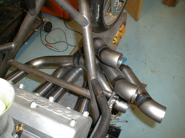

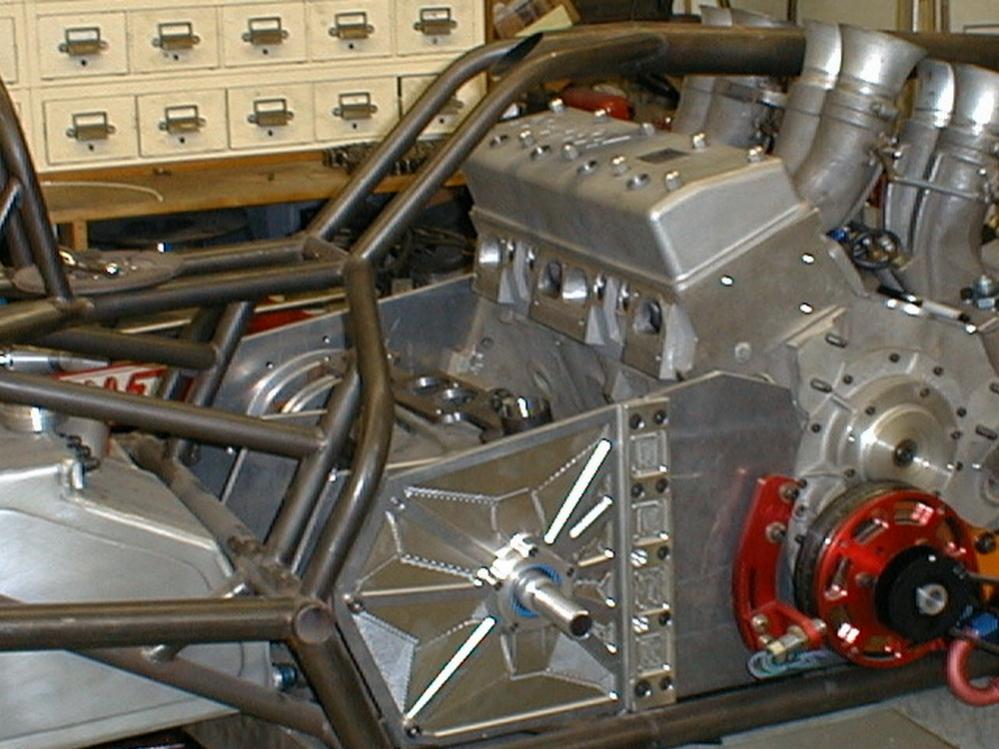

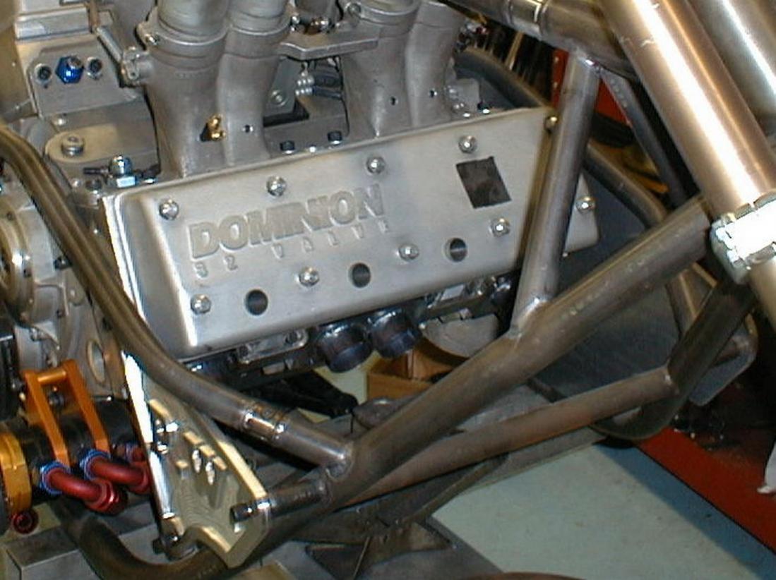

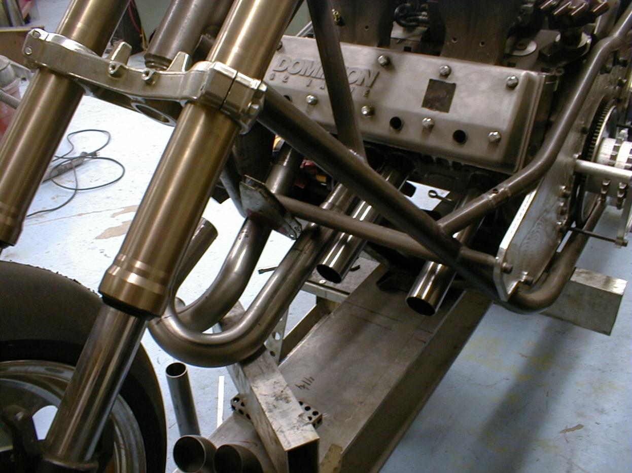

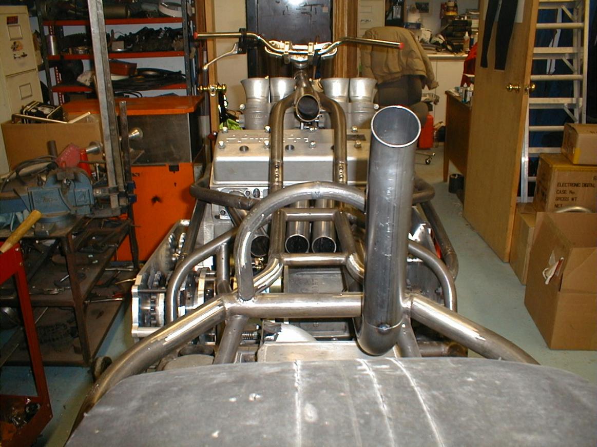

    Under seat Exhaust system First time lot of work and thinking to put in and to get out.Click image for larger version.
Name:	V8 Exhaust under seat 1a.jpg
ID:	8567Click image for larger version.
Name:	V8 Exhaust under seat 1aa.jpg
ID:	8568Click image for larger version.
Name:	V8 Exhaust under seat 1b.jpg
ID:	8569Click image for larger version.
Name:	V8 Exhaust under seat 1c.jpg
ID:	8570Click image for larger version.
Name:	V8 Exhaust under seat 1d.jpg
ID:	8571Click image for larger version.
Name:	V8 Exhaust under seat 1e.jpg
ID:	8572Click image for larger version.
Name:	V8 Exhaust under seat 1f.jpg
    Well, that is certainly interesting.
    What are your plans / ET Goals with it? I assume it is just made to have something "different"?
    Is it a decent motor?
    Don’t know the new rules for V8 drag bike racing for the new year yet but the engine is restricted to 396 cubic inches and the speed was 205 MPH 1/4 mile but the new distance of 1000 ft. will change things.
    Motor Chevy 350 stroked to 396
    Heads are Dominion 32 Valve
    Hilborn Fuel Injectors
    Hilborn Fuel Pump
    Pistons 13:1
    HP 1200 to 1300 on alcohol
    15in rim 16 in wide Goodyear Drag tire.
    Where do you run them? CMDRA? What ET do they run?
    Do you just dump the front bank exhaust out to the sides?
    ET no restricted only MPH
    working on the front will finish later this week all four coming out right side so far.

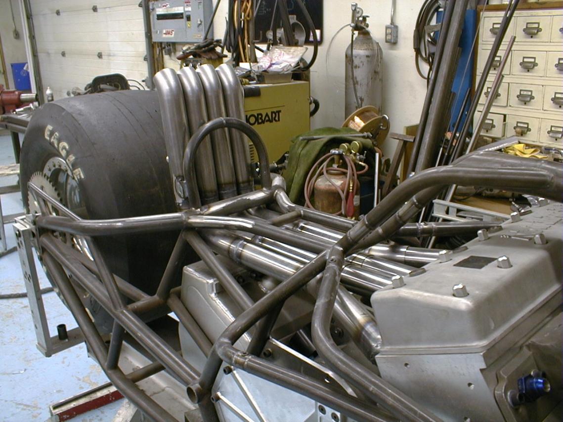

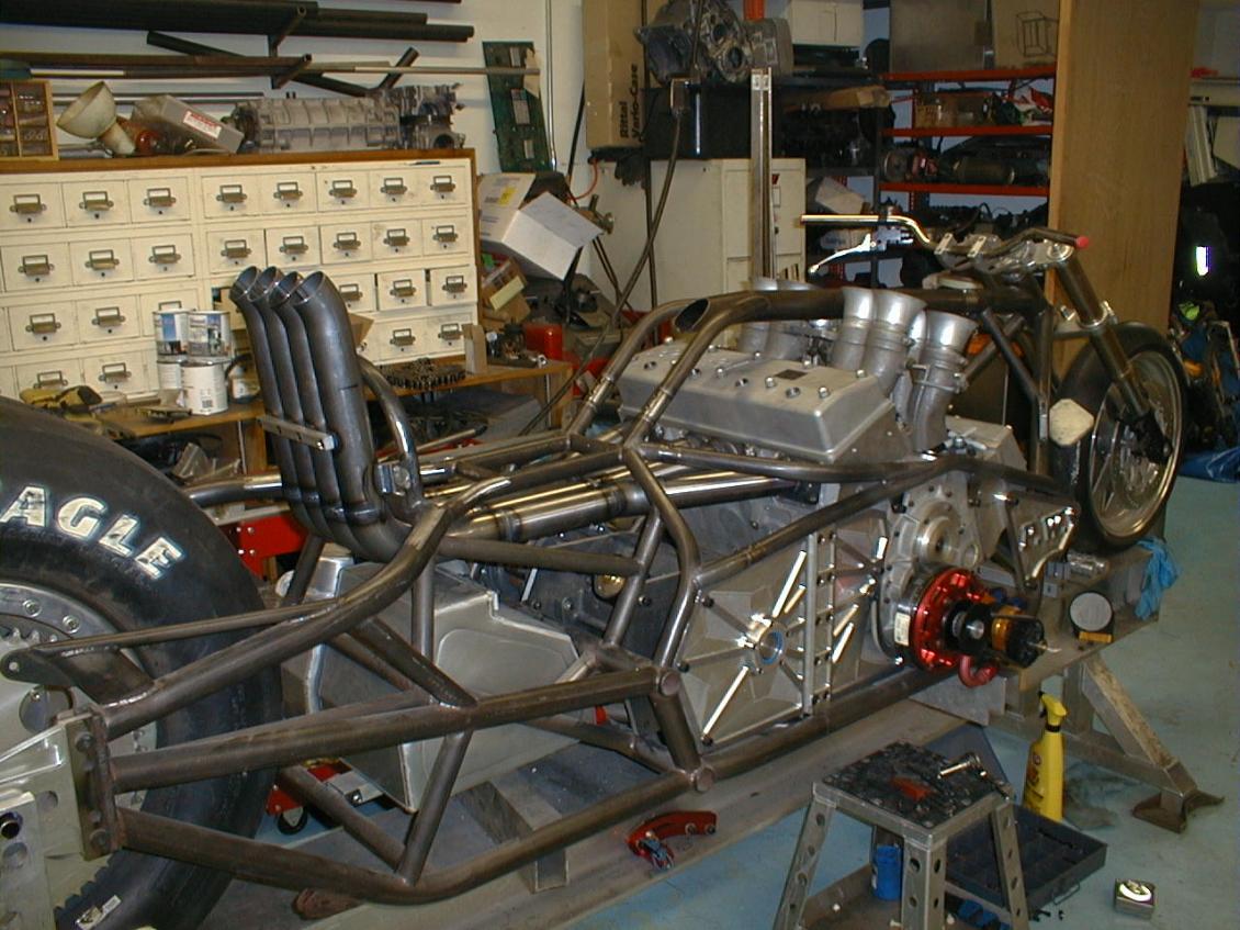

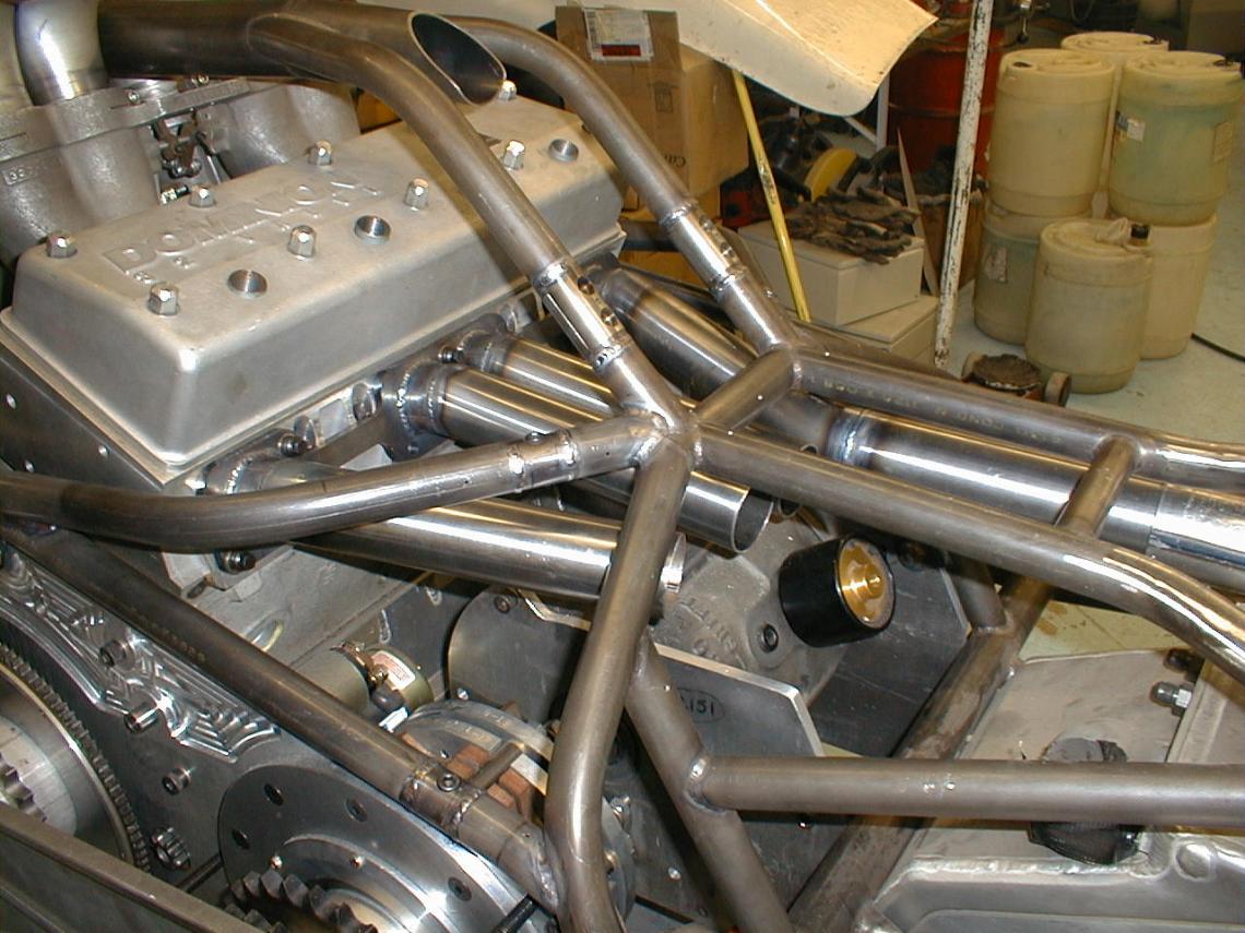

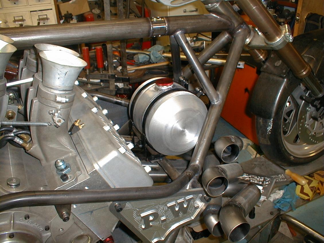

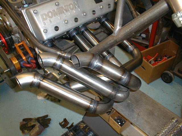

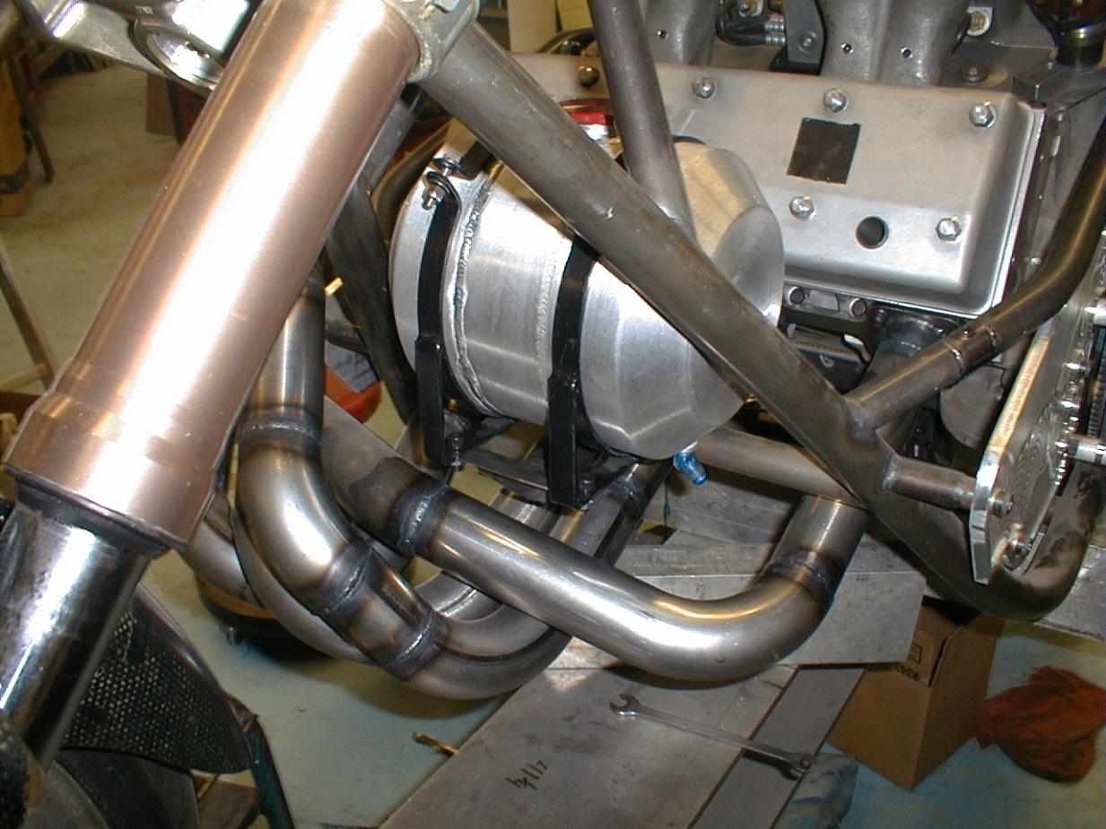

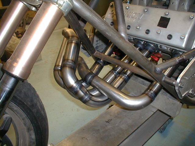

    Front Exhaust system finished Click image for larger version.
Name:	V8 Exhaust Front 2a.jpg
ID:	8582Click image for larger version.
Name:	V8 Exhaust Front 2b.jpg
ID:	8583Click image for larger version.
Name:	V8 Exhaust Front 2c.jpg
ID:	8584Click image for larger version.
Name:	V8 Exhaust Front 2d.jpg
ID:	8585Click image for larger version.
Name:	V8 Exhaust Front 2e.jpg
ID:	8586Click image for larger version.
Name:	V8 Exhaust Front 2f.jpg
    that is freakin bad ### .
    250 ex
    205 mig
    milwaukee grinder
    140e mig
    Outstanding ... I've dreamed about a V-8 drag bike ... even made a miniature. That is just bad beyond words!

    Nice looking exhaust. Hope you use ear plugs when that thing runs.

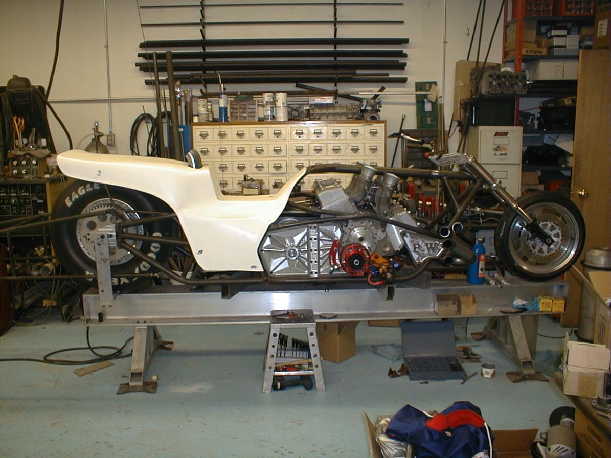

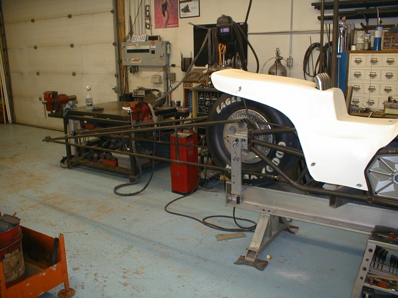

ID:	8614V8 Wheelie bars, front fuel tank and RH side view.
    Nitrous, too. That must be a wild ride.
    That's just crazy wicked. I saw the title of the post and figured it would be just a scale model .... Man, that is a BEAST!

    I have to say, that is something. Be safe and good welds only.
    Holy crap, is all I can say. What do you call the operator of that beast? "Rider"? "Pilot"?
    Be safe! And post videos when you can!
    I would love to make passes on something like that ... I think I would be more concerned with stopping than anything else ... Our top fuel and pro fuel Harley riders in AHDRA started using chutes a couple years ago since a few have gone off the end of the track. They're hitting 230 mph in the low sixes (still 1/4 mile unlike NHRA that has cut 320 feet for nitro).
