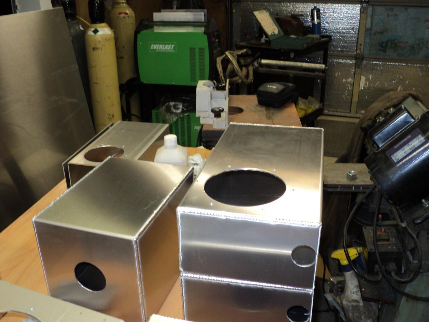

    These are some more tanks i welded up for dadscustomintercoolertank.com,5052 material ,.100 thick using 3/32 5356 tig rod.
    250 ex
    205 mig
    milwaukee grinder
    140e mig

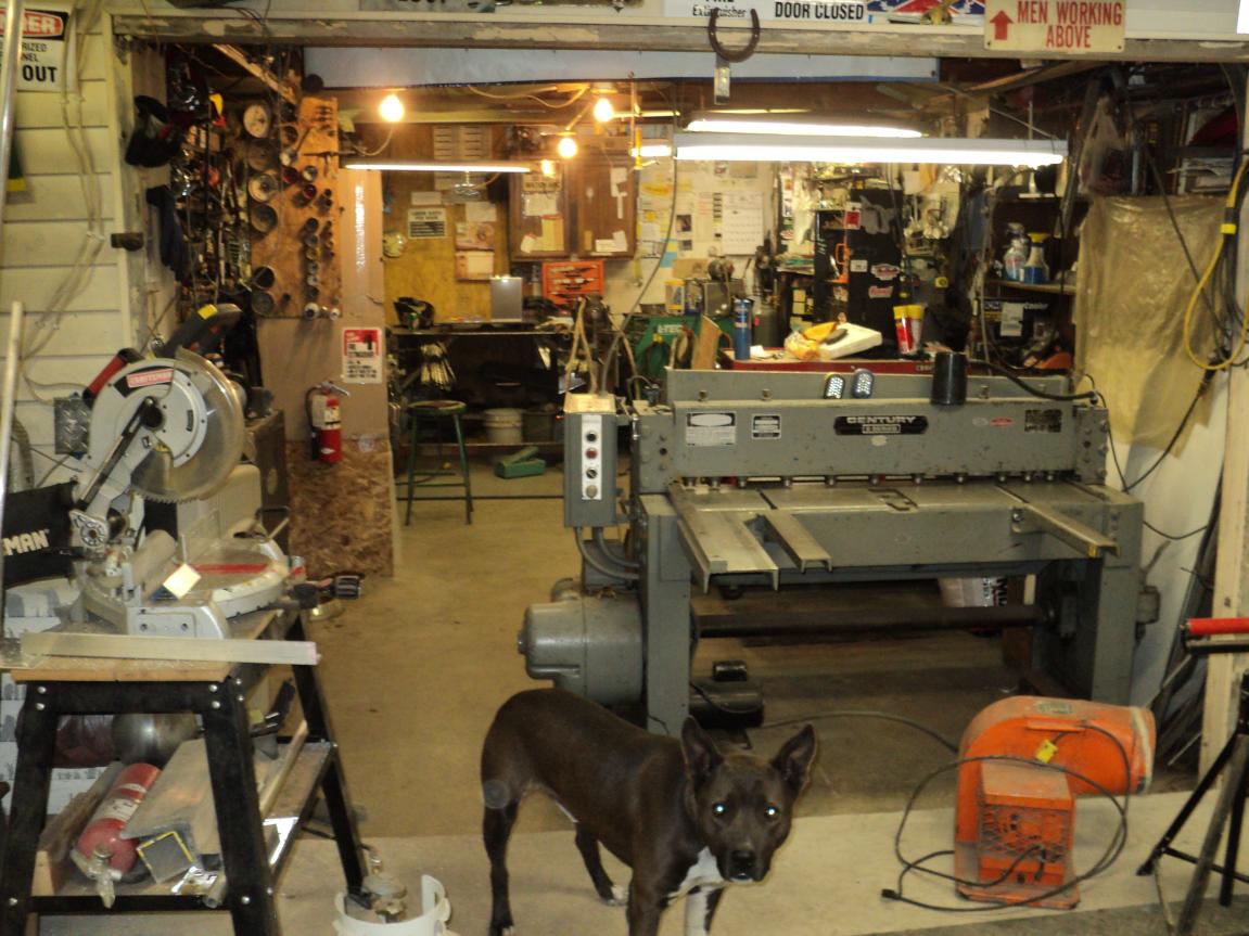

    Nice work... how do you get to your welder ?
    thanks...garage is small but there is enough room and it keeps heating bills down in winter time.Click image for larger version.
