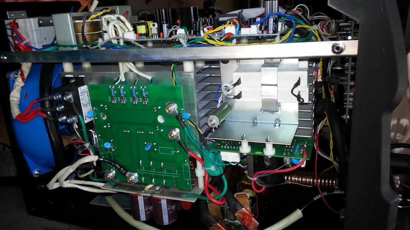

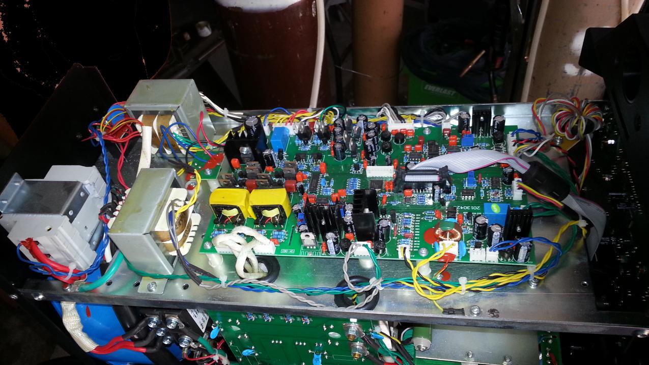

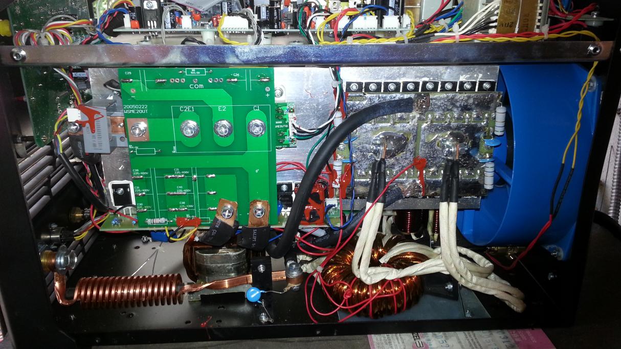

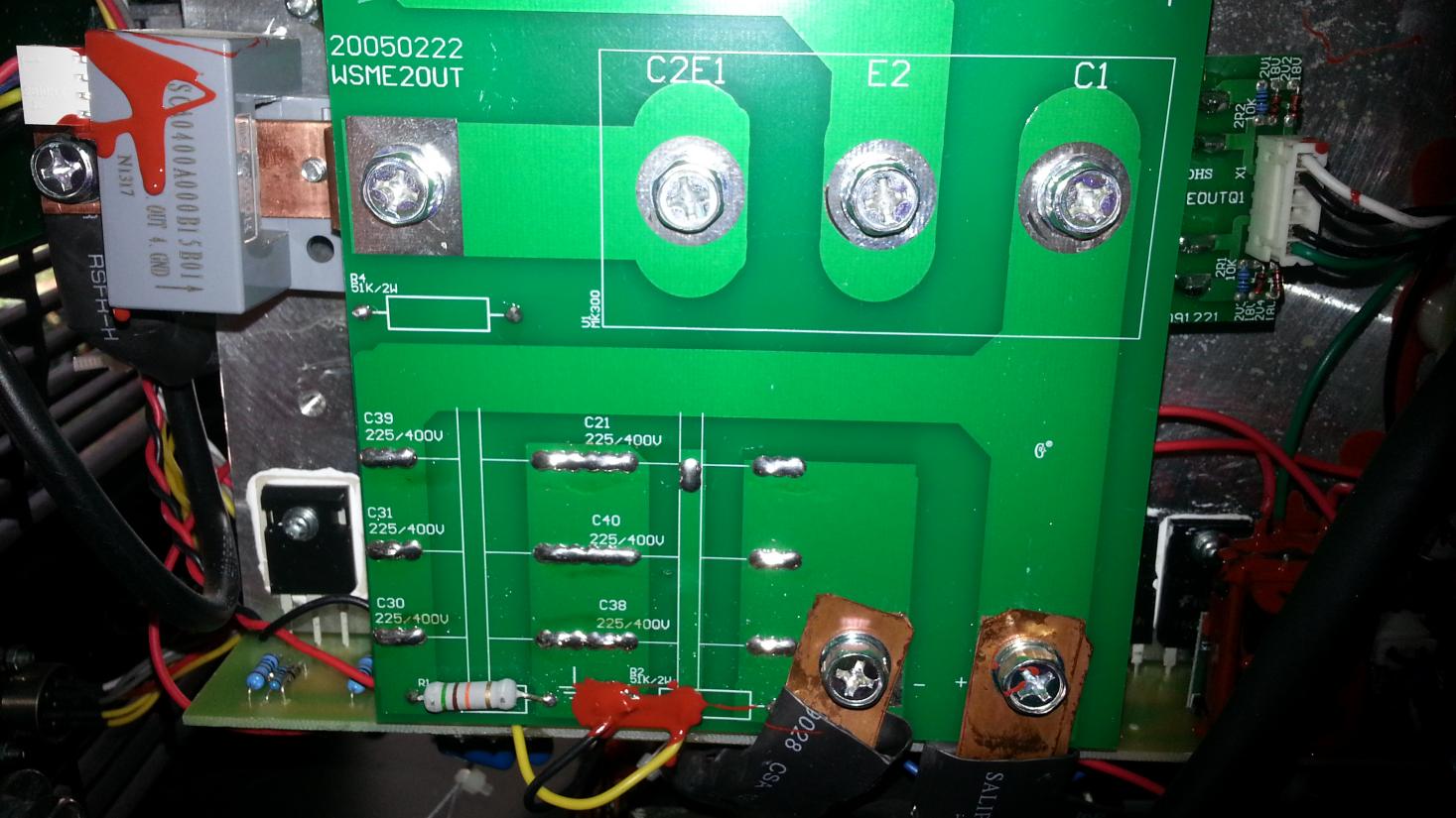

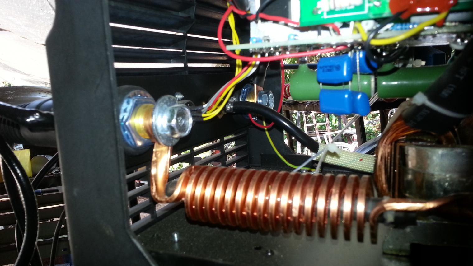

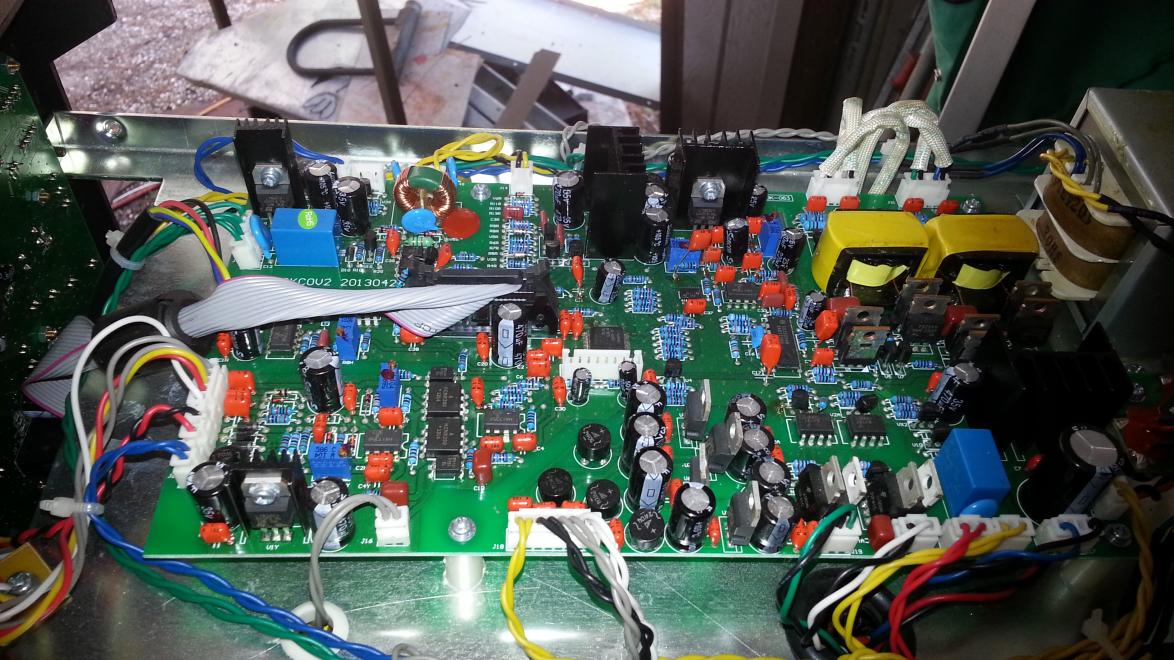

    Some inside pics. Forgot to look for a spot to hook up the scope. Will have to open it again.

    Thanks for the pics. Did you notice what brand caps were used? That fan looks pretty substantial, how is the noise level and is it a fixed speed, or does it vary with temp? Look forward to your review. Is this an actual production unit, or a pre-production sample?

    Fixed...and loud. secondbatch

    I was thinking the same have it like a computers fan on the CPU's as it get hotter with demand it speeds up the fan and slows down after cooling it.

    Guys,
    On demand fans result in higher prices, lower duty cycles, and the potential for more failures. This isn't a computer sitting, in a nice cool place under your desk. It's a machine that is sitting in a high stress environment, in 120 degree heat and 95% humidity at times, (as Mike, mine and any body's shop is in the South East) drawing in smoke, ultra fine metal particles and dust. If your computer was in that environment, those on demand fans would be going full tilt. What's the expected life span of a computer as it is? After 3 or 4 years, the manufacturers WANT you to replace it. It isn't something we are going to do for the near future. It's not even in our plans for now.
    Yes, it might be doable, but not something we feel is as pressing as other matters. Our goal is to keep the units running cool and keep the duty cycle that we advertise.

    Fixed...and loud. second batch
    I find this one is not as loud as the 250EX though. Hey, 250 amps, it needs some air

    I agree 100% with Mark. And it is 120 degrees OR 95% OR both here most of the year. He's not joking there.
    I have no problem with the fan noise, I have a lot louder things I live with. The compressor charging when I am on the phone bugs me some, someone grinding when I'm on the phone does too. But that's sometimes how a shop works, at least for me.
    I would rather not have on-demand and get a better duty cycle and know I will get (if I keep it clean and covered ) a lot more time/use out of my machine.
