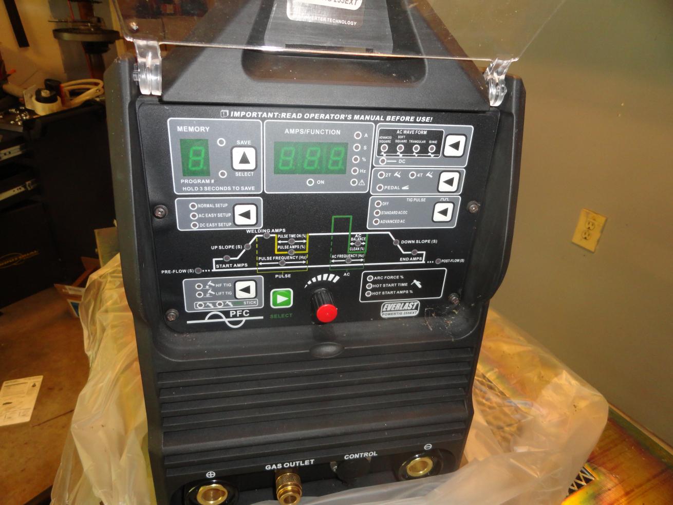

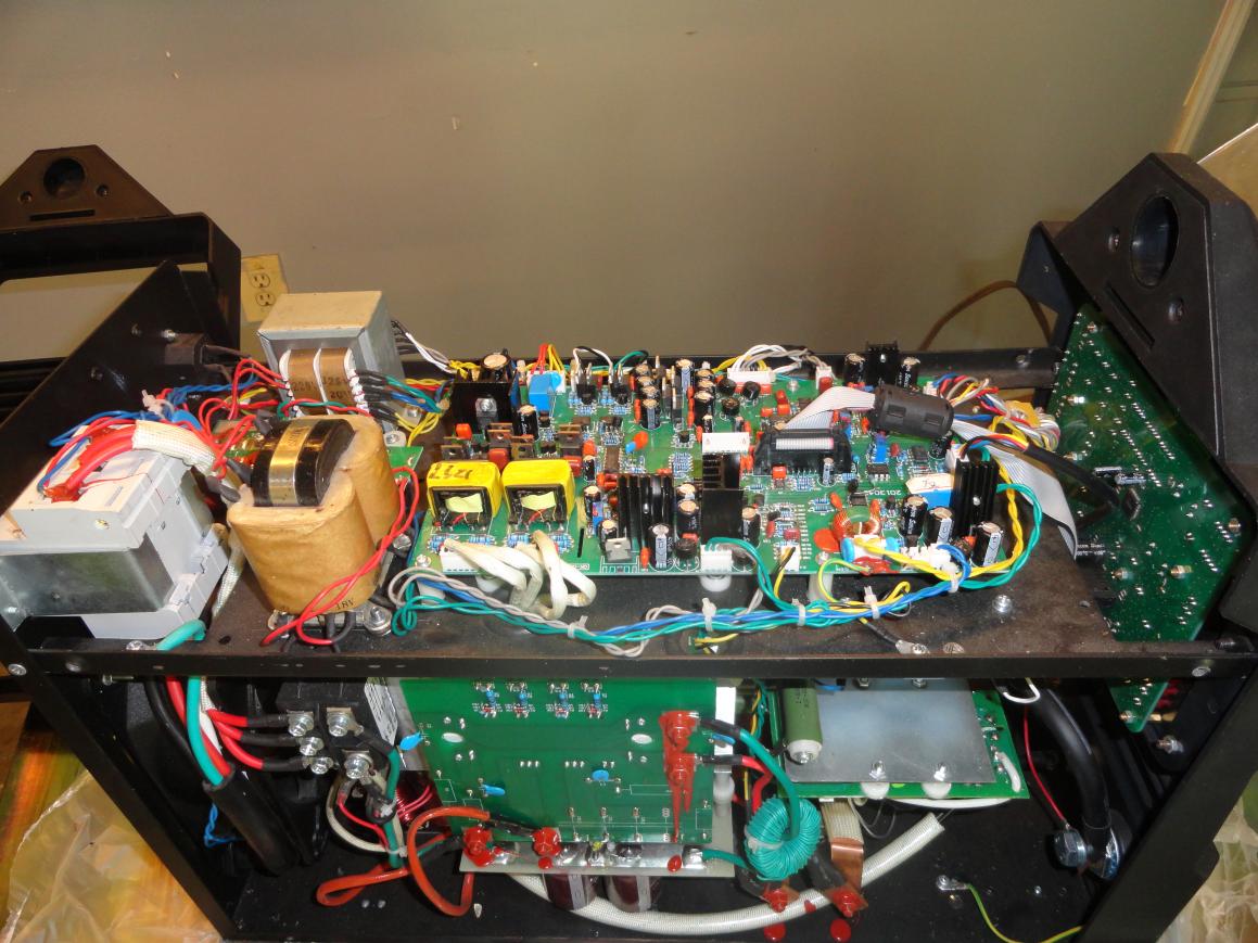

    Here are a couple of pictures

  7. #127
    Wow. That really is a nice, clean and simple layout. If fewer parts have any bearing on reliability, it looks like a winner.
