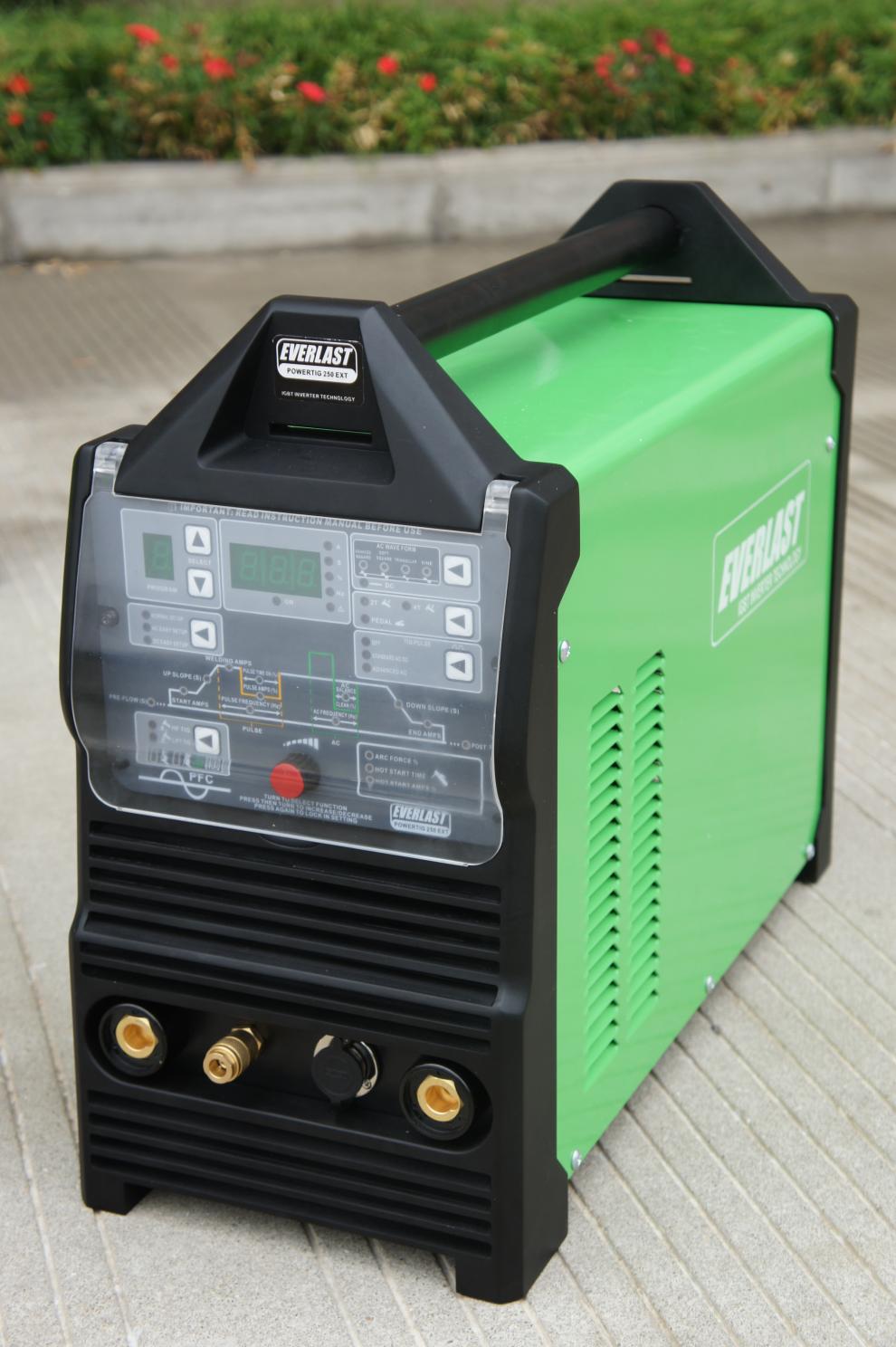

    Default NEW 2013 EVERLAST PowerTig 255 EXT AC/DC DIGITAL TIG WELDER
    The new Digital Microprocessor controlled 250 Amp PowerTIG 255 EXT will be here soon with some radical new design and improvements over the previous model. Expected delivery will be in March. The units feature wave form control for AC welding, Advanced AC pulse along with standard AC/DC pulse. It features memory function. It also has excellent starting, with low amp capability for AC and DC. The unit also is slated to have an "easy setup" function which features a good starting point for the user for both AC and DC without having to go through a complicated setup process or give the operator a "recenter" point if the customer needs it. The Stick features Hot start time/current control, along with arc force control. Simplified layout and design makes the unit easy to set up and assess the programmed parameters. One knob control keeps the adjustments simple and intuitive. This unit like the 210EXT feature PowerFactor Correction which improves generator operation and withstands "dirty" power better than ever before. If you have further questions give us a call. Some details are being finalized now and full specs will be available shortly after the first of the new year. This unit is compact and is projected to operate on single phase 240 or 3 phase 240 with a 480V 3 phase option available at customer request.

    A few more details...
    The 255 will have many of the basic performance specs of the 250EX as far as basic parameters, which is a good match for most people including a higher pulse rate. The 250EX still offers some of the best parameters in the business, so it is a good model to project in a digital form. Advanced pulse is still going to be around the pulse rate of the 210ext's for right now because nature of it. It will retain many of the features of the 250 ext except the amplitude which we have developed up to 4 wave forms for it. (See pic above) The easy setup feature is projected to be set up for fast setup with a good starting point that is workable for most people. Any direct questions about any parameter can be posted here, and I will try to answer it, or get an answer for you.

    Todd, to best answer your questions, take a look at the 250EX specs for most of the answers. It will use the EX pedal and so being it will use the ssc pedal as well. It should also be able to use a variety of other pedals provided you use the correct plug (auto sensing on the ohm value) and use the same number of wires.
    You will get a total 10 settings as of now, unless it can be made to be more, but that is the minimum we are shooting for.
    From my understanding, since the pedal can be plugged in and override the 2T/4T setting it will be a separate non programmable feature.
    Take a look at our video on the 210 EXT to see the AC advanced pulse explained. The advanced pulse will be limited to 10 hz. The AC regular pulse should be similar to the 250EX.
    We've already explained several of the features elsewhere but will be happy to reanswer them here.
    The easy setup: It will be preprogrammed into the machine basic settings that will work for most users, especially on AC, which will include a basic starting point on amps, balance, and hertz.
    Duty cycle is slated to be 60%. Standard setup will retain last features used on startup.
    Yes it will have the same basic fan as the 250EX so it will be as loud.
    The water flow circuit is gone.
    Dimensions will be similar to the 250EX, within an inch or two. It is smaller than the original 250ext.
    At this point the torch has not been decided, but probably for now will use the wp18 or wp20.
    Power Cord is included.
    Any trade is to be worked out directly with the office. It's going to depend on use and damage I suspect. Final price has not been set yet that I know of.
    There should be a socket for the water cooler, but not sure if it will be switched or not.
    All pedal issues are what you have with the EX. We're limited to what is available from the factories on that.
    Not sure on how the lift start/ HF will be saved or not, probably not though since this is a separate circuit not included in the programming circuit.
    Start settings are not adjustable or able to be programmed at this point. Low amp start for AC and DC will be around 5 amps and start similar to the 250EX in that respect.
    All this is tentative as we have stressed and MAY change, though we have given the list and know basically what can and can't be done technologically wise in the factory.

    The 20F will have a torch switch.
    Weight will probably be about 70-80 lbs.
    The balance will either be the 0 center point or negative % at this point. As I have said, I don't have a hands on visual yet, and some things are final so, I am projecting a few things at this point.
