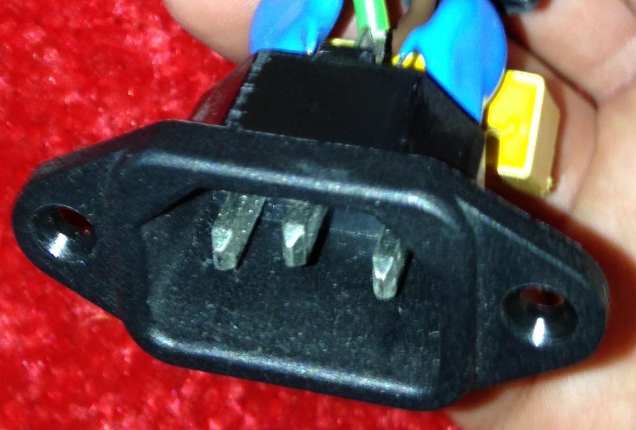

    There were a few minor tweaks/improvements I made to this machine before I fired it up - but I don't want to clutter this thread with too many of those details, unless a lot of people are interested in them. (Or, maybe I'll start my own thread so I don't clutter this one up too much. ) I do have a question, though: is this connector, which I salvaged from a PC power supply, the same style that Everlast uses on the back of the 250EX for the watercooler? (If it is, I'm thinking of adding it to my 250EXT)

    I'd love to hear about your tweaks but you are right, better for a separate thread.
    I think that connector is the same (from what I've read in another thread) but I'm not certain. I wish I had kept all of those PC power supplies I recycled ....

    Rambozo's right. That's not the right one.

    Thanks for the info on the proper cooler receptacle, guys - I'll try to source the proper female version.

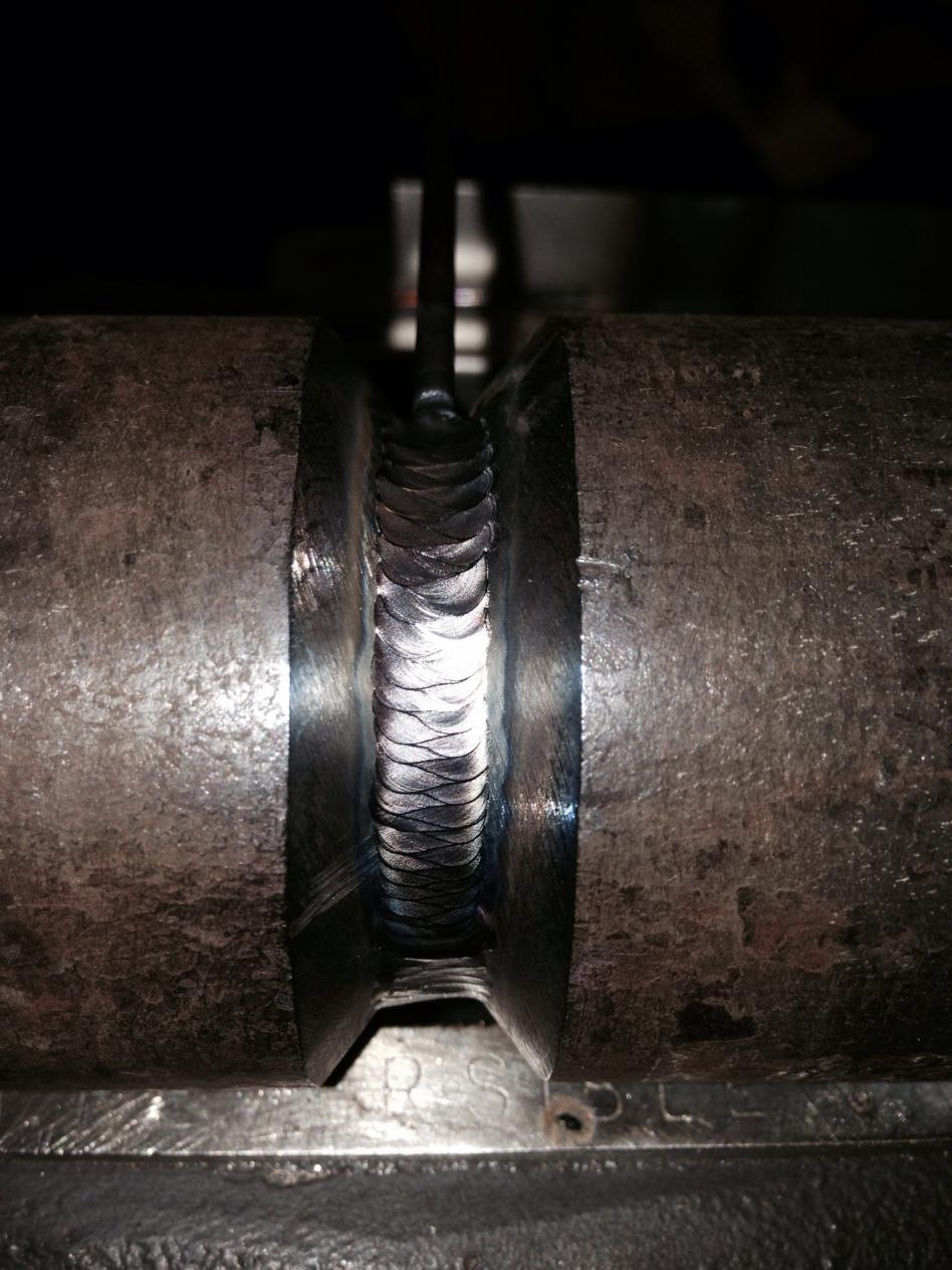

    Had a chance to do some more testing with the 255 EXT. Attached is a picture of a root pass and a hot pass on some 2 inch double extra strong pipe.

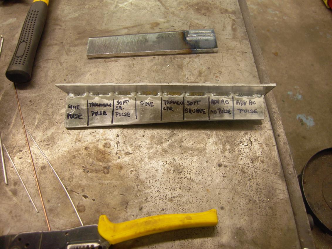

    PowerTig 255EXT, Got it all hookup and tested all the different AC waves pulse and no pulse. They all weld very similar but different sound for each one some faster startup and faster welding. DC welds very nicely down as low as 3 amps and stable.Click image for larger version.
Name:	Test 255EXT.jpg
    Setting are:
    Pulse time on 40%
    pulse amps 50%
    pulse frequency 1.5 Hz
    AC balance 38%
    AC frequency 250 Hz
    this was just the first test with AC. then turned on DC very ease to start and hold 3 amps. AC will light and hold at 5 amps steady once the tungsten is hot in a few seconds.

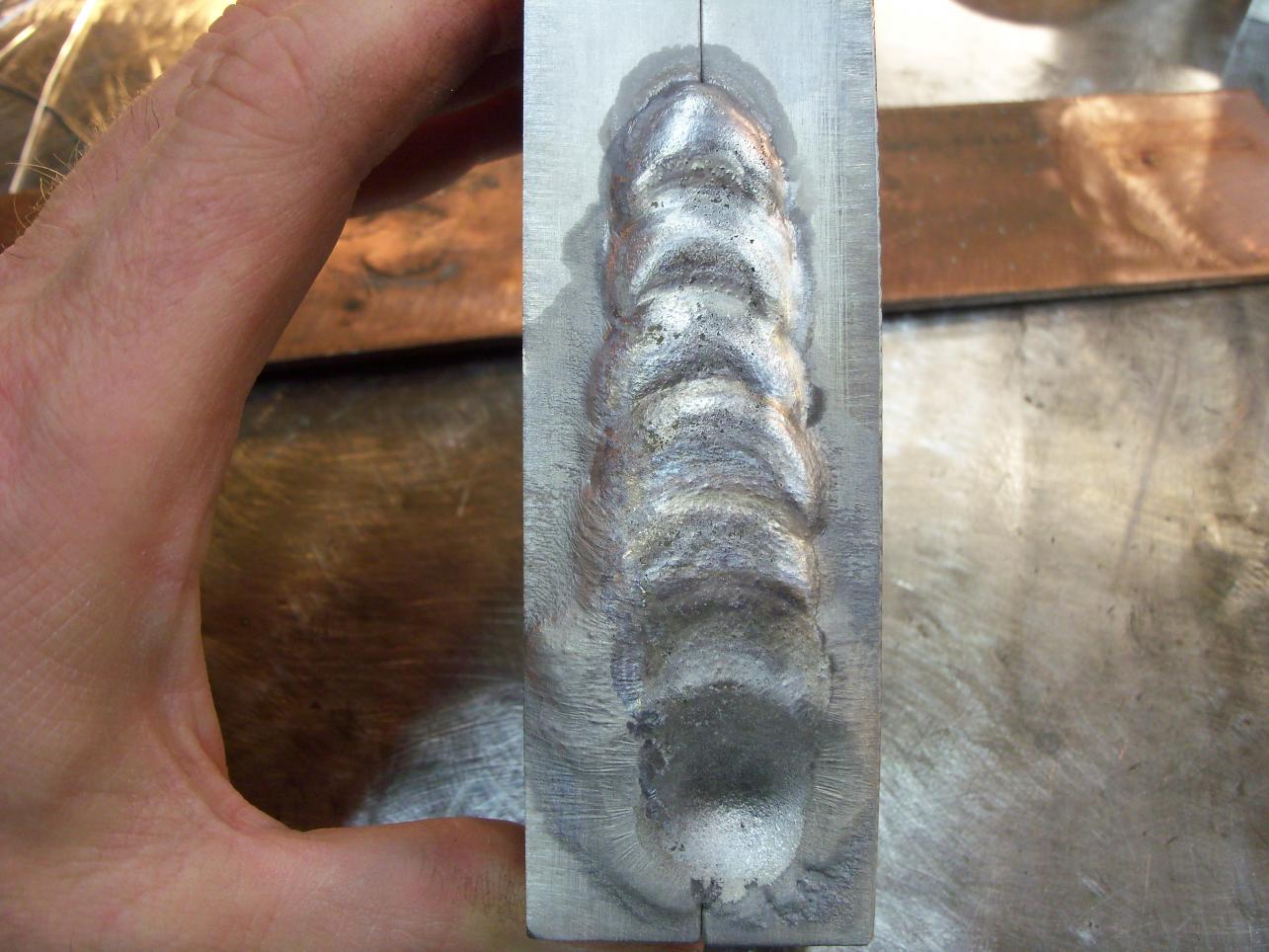

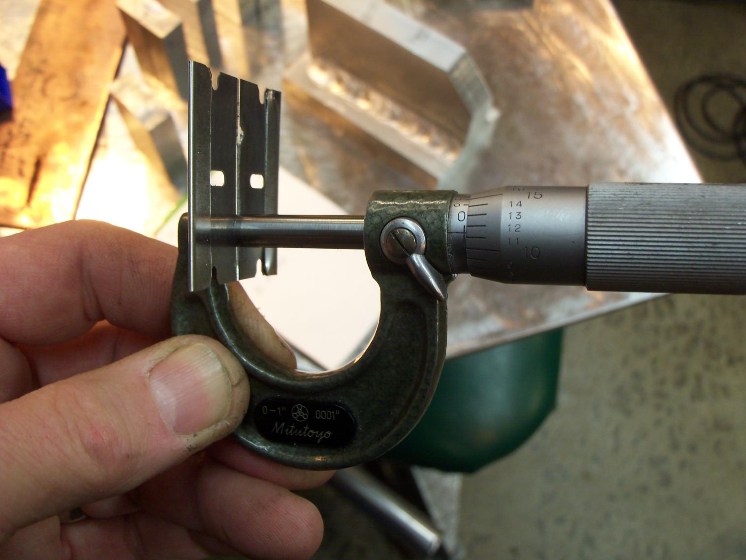

    Kempy, That's a Great start!, You have a season of wonderful new experiences ahead of you.
    From the really small to the Really Big!

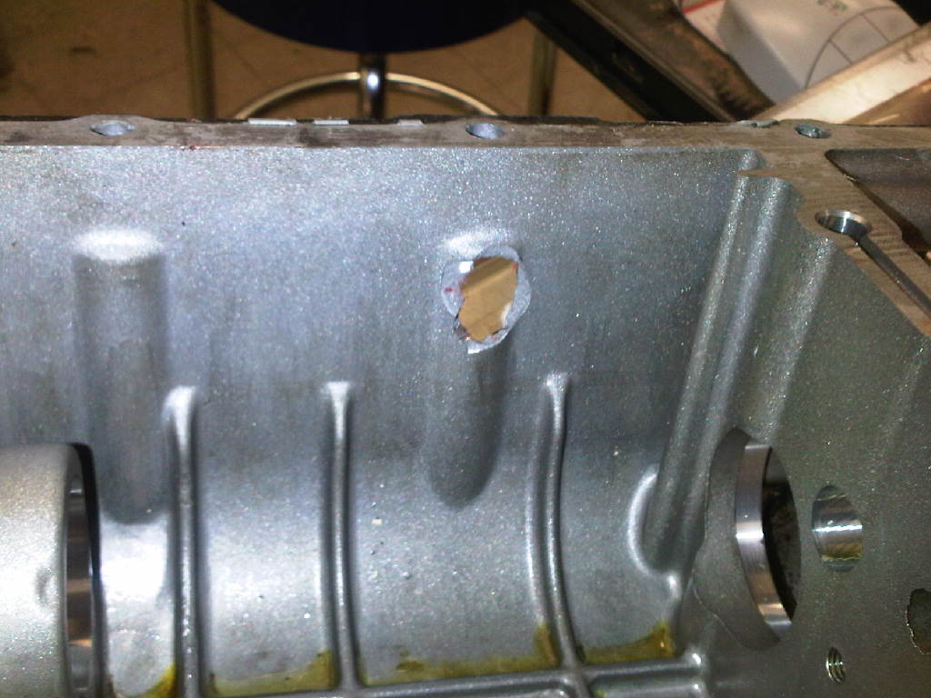

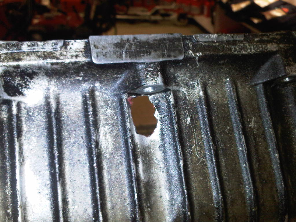

    I will be doing more welding tomorrow just weld up a motorcycle case that had a hole in it rush job, forgot to take a picture of it I will email the guy and get him to take some.
  16. #256
    First job for the PowerTig 255EXT did not clean just welded it. Removed some weld on outside to make sure the bolt fit.
    Settings: Advance Square wave no pulse, AC Balance 42%, AC frequency 250 Hz., 2% Lanthanated 100% Argon @ 30 SCFH
