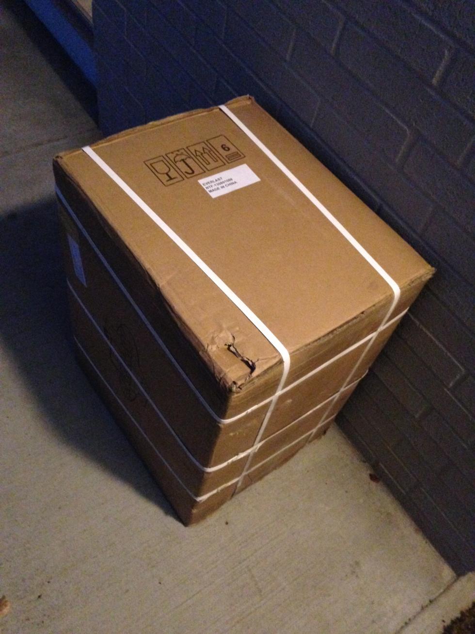

    It's a Great day! Mine arrived late this afternoon Here are some first impressions:
    UPS did fine, I was very anxious about it getting here intact, but it looked great! The box was nearly perfect and was banded with 4 white plastic straps.

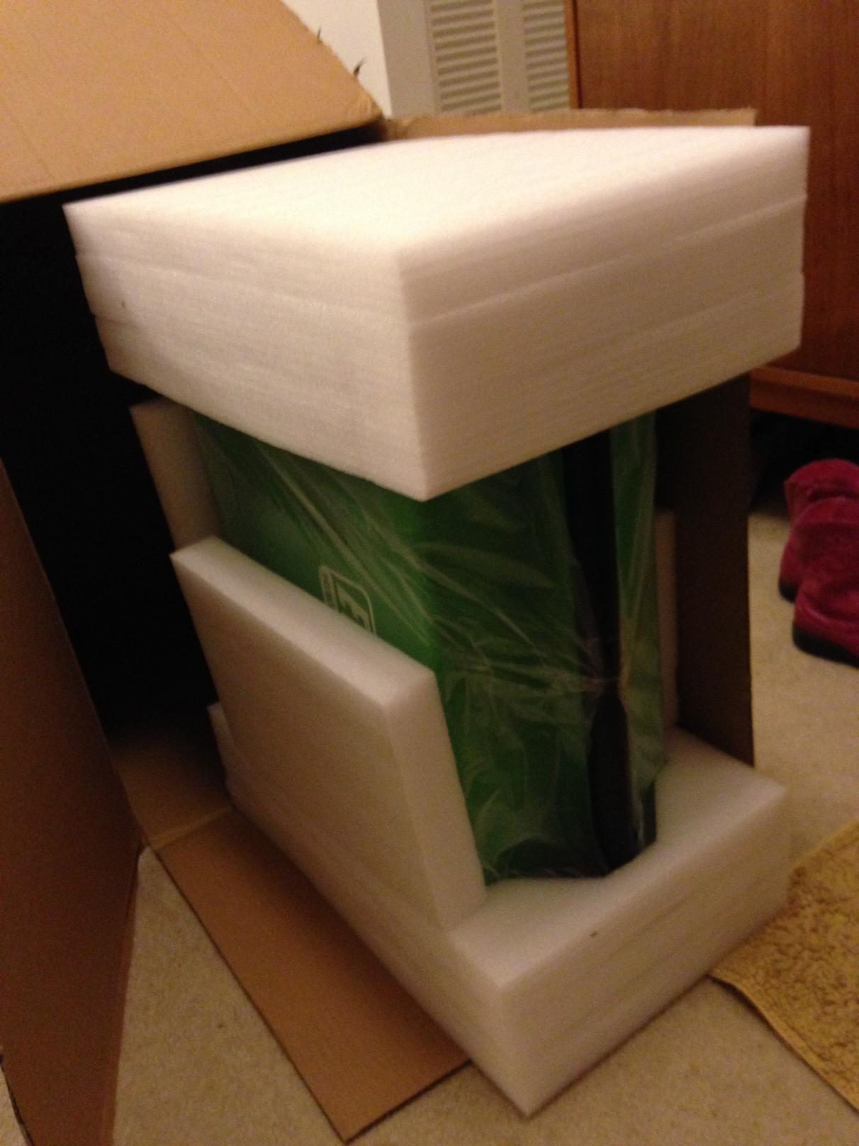

    * The Everlast machine packaging is really amazing now, compared to how it used to be. There was a gouge in the corner of the cardboard box from UPS, but it did not penetrate the very high quality and thick foam padding to make it to the machine.

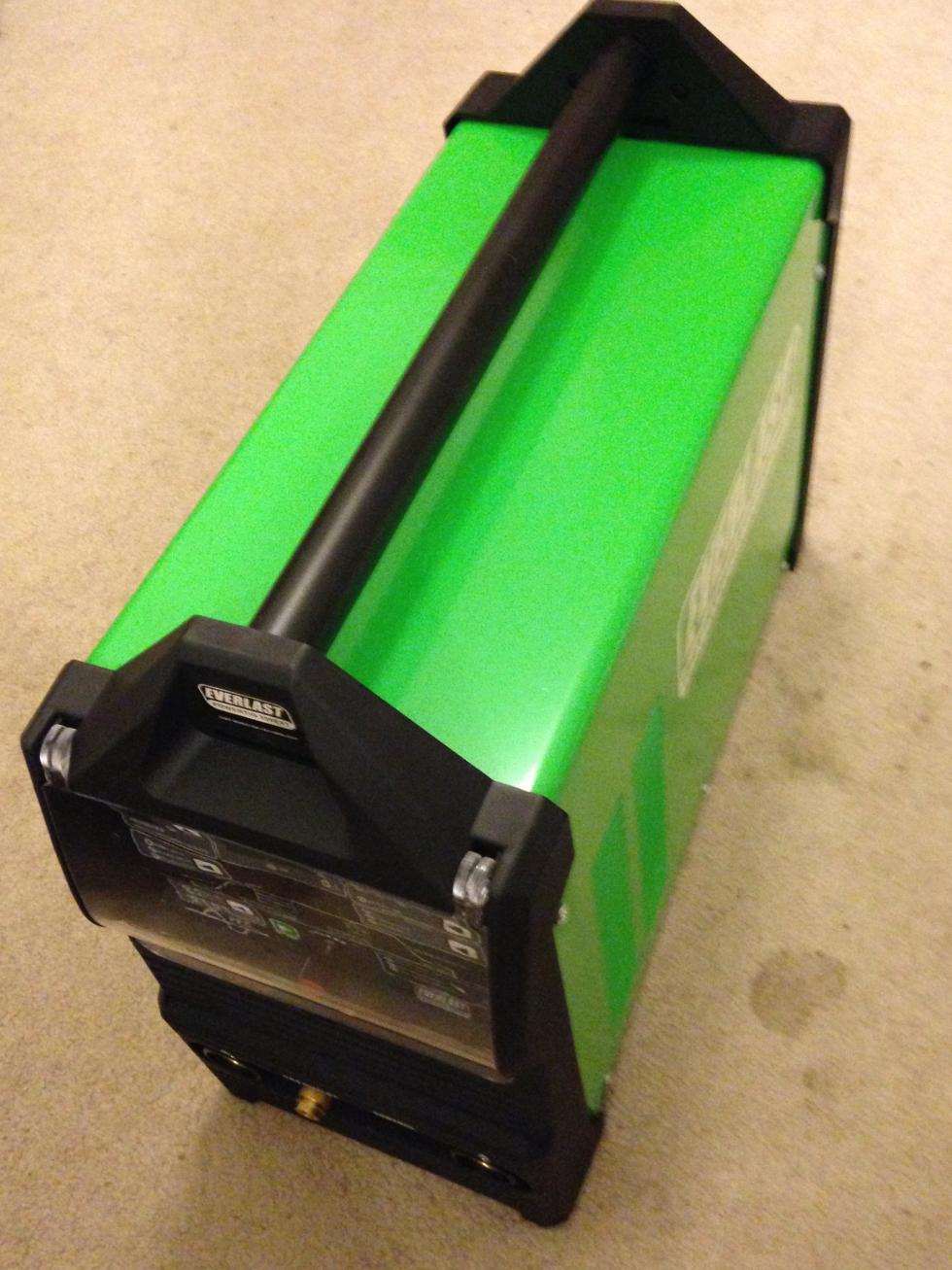

    * The machine is really great looking.

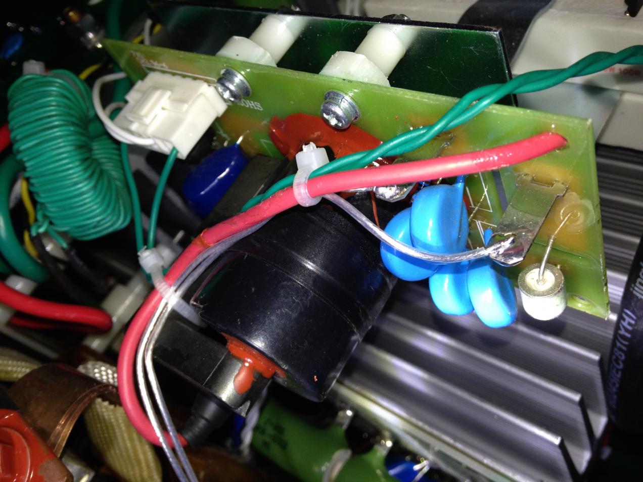

    * There is a 2-conductor "solid state device" of some sort where I expect the spark gap would usually be. (Aside from that the arc starting circuit looks typical tesla coil circuit - no transistor) See picture (white cylindrical thing at right with a lead coming out of each end):

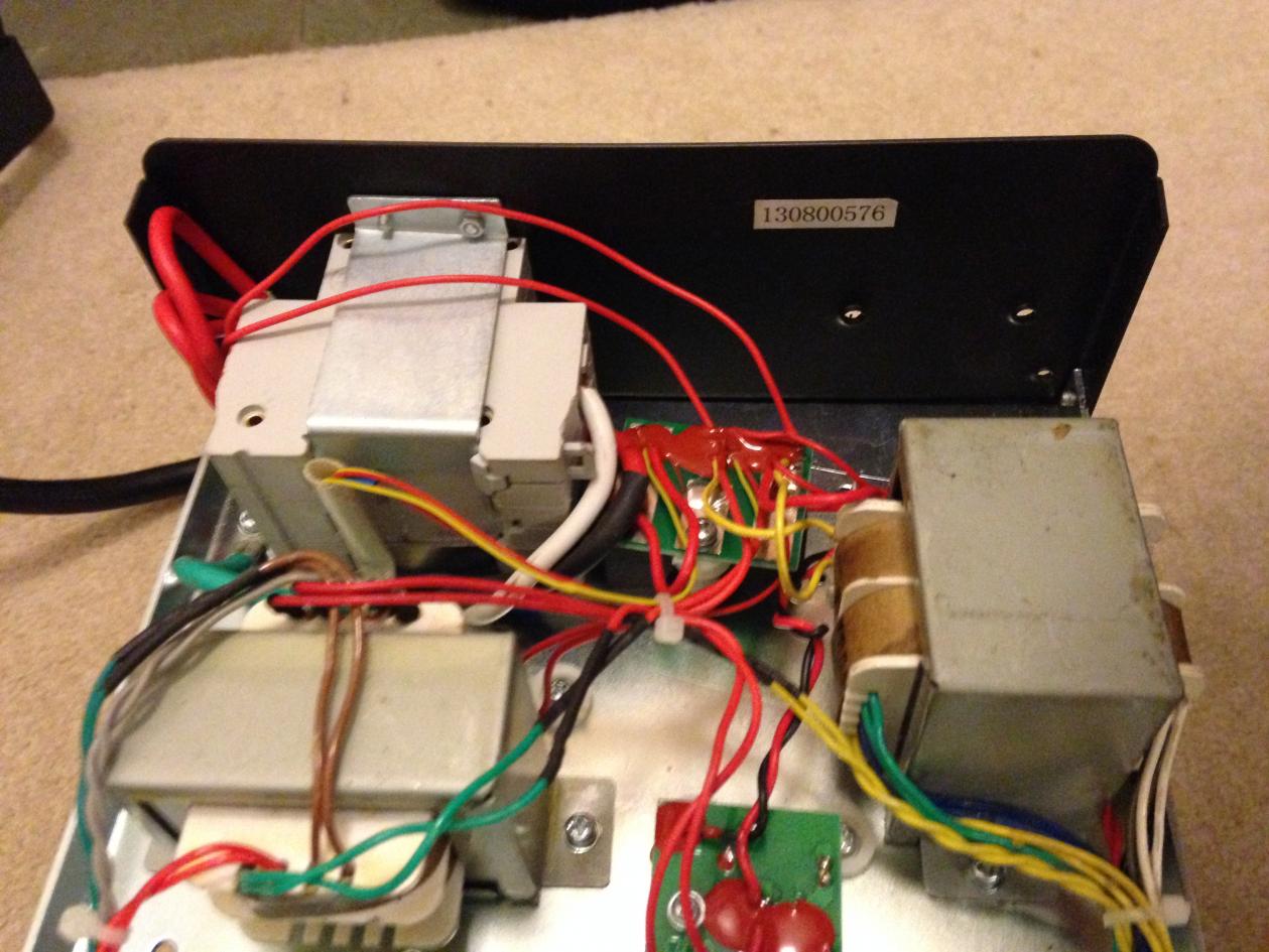

    * On the back, near the top on the side opposite of the on/off switch, there is an area where it looks like a cooler power plug could go. (Two pre-drilled holes with what looks like room for mounting a receptacle on the sheetmetal here, and easy taps to the power switch/circuit breaker on the inside of the machine nearby.)

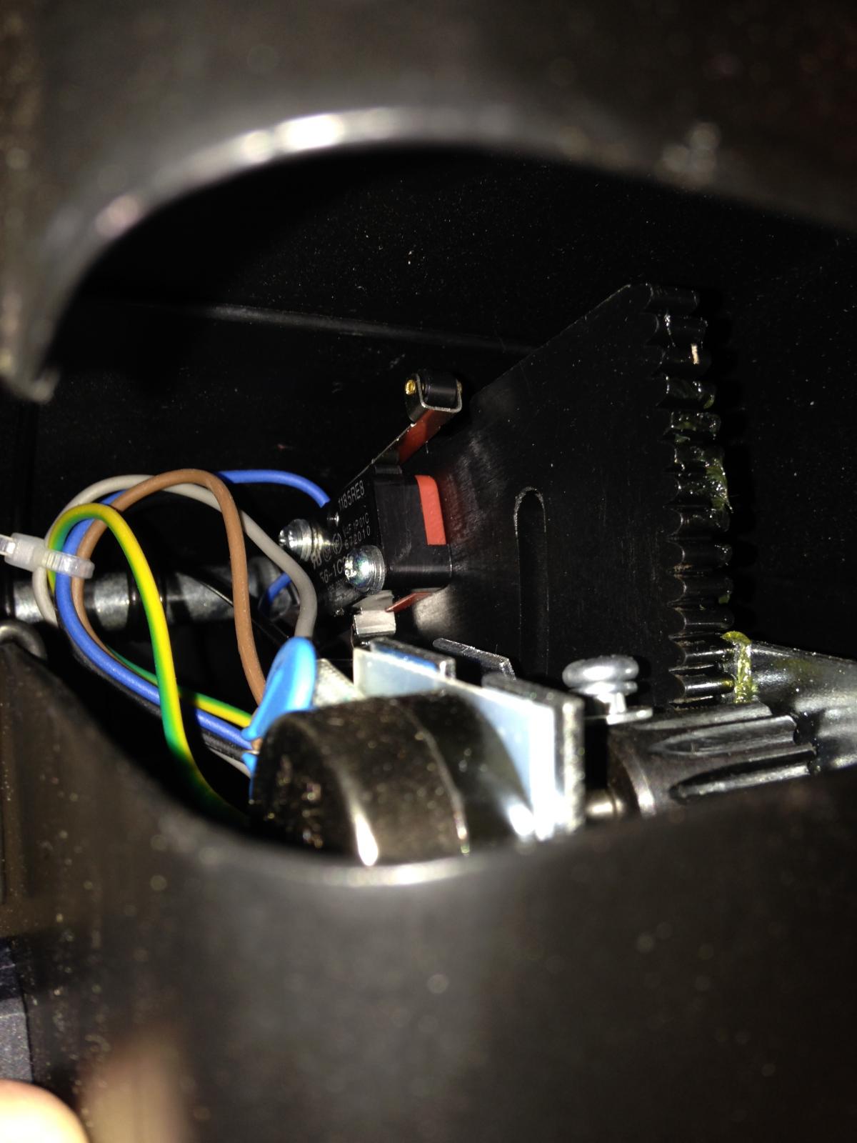

    * The new footpedal seems to have an improved (more sophisticated) linkage to the potentiometer by the way, that allows the pedal to move the first bit without moving the potentiometers so that the microswitch can initiate the arc before rotating the potentiometer. I imaging that this may allow "feathering down the throttle" to the minimum amps... (Assuming the pot is indexed/adjusted properly, of course, but that can likely be fixed if it's not.) I can't wait to try it!

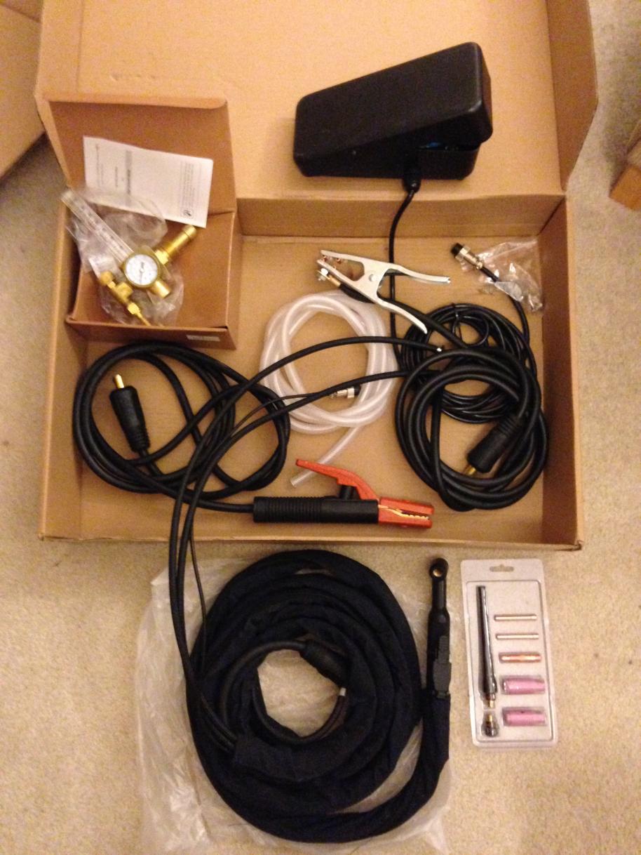

    The accessories mine arrived with were:
    * 14.5' long new-style footpedal (So far looks pretty sweet... can't wait to give it a try!)
    * WP-18 style rigid TIG torch (labeled "SR-18")with 13' long, outerbraided-style hoses inside. A nice, zippered denim-type cable cover. Handle diameter = 1-1/16". Includes a zip-tied on switch. Hose diameters inside were 5/16" (for the two smaller hoses) and 1/2" (for the single larger hose).
    * sheetmetal ground clamp with 9.5' long cable (not the brass tweco-style clamp, but the plated sheetmetal, albeit a bit better quality than I was expecting for this style!)
    * spring-clamp style stick electrode holder with 9.5' long cable
    * a very good looking, new-style brass argon regulator (I've had great results with this style from other sources)

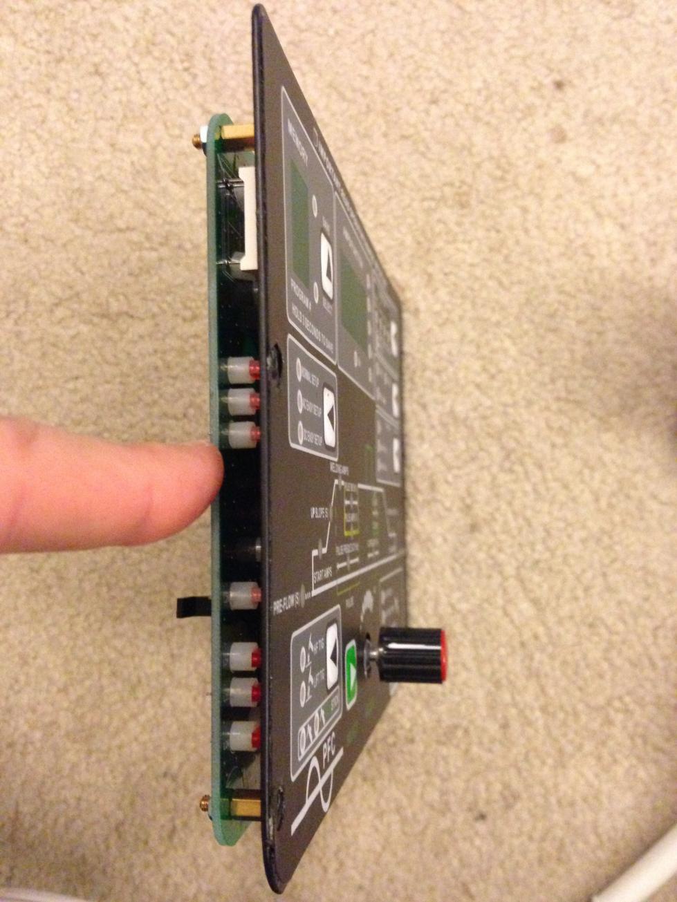

    I decided I'm going to go through mine and give it some TLC before I fired up, because I figure I have more incentive than the factory assembler/worker to make it all perfect. (This philosophy has worked well for my 2007 Super200P... still firing a reliable TIG arc today). I found and fixed some minor fixable problems so far when going through the machine already - including:
    * footpedal arrived with the top moving platform part off one of the pivots pins. It was fairly easy to just snap it back into position, although I don't know if it will be all ready to go after doing just that (may need adjusting to optimize its range... we'll see)

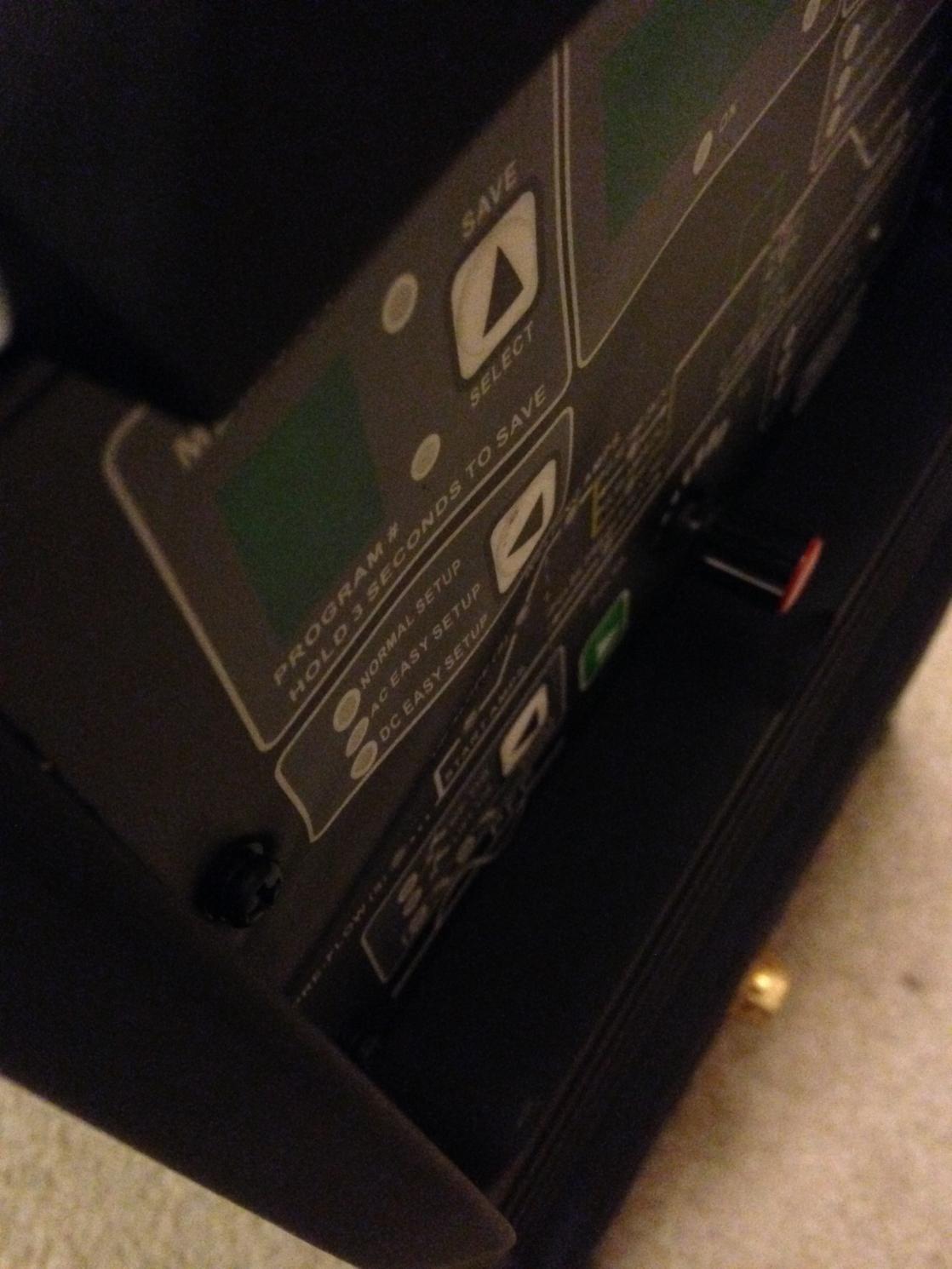

    * The adhesive-affixed laminate over the front control panel had a pretty annoying looking "wrinkle", right over the "Normal/AC Easy/DC Easy" button (and it seems like it may have made that button difficult to press):
    To fix that, I used a hairdryer to warm up the affected region, peeled the laminate away from the corner over the area, and applied it back on smoothly. I think the top two screws going through the control panel (which are also structural ones for supporting the welder components) seem to grab at the laminate and want to twist it when tightening, so I think I'll trim the laminate away around there to make clearance for the screw heads. I don't want to leave the screws loose here since they're structural for keeping the machine rigid. Unwrinkled:
    Thanks for the great first impression and all the photos. That looks like a gas discharge tube, (basically an enclosed spark gap) they are used for over voltage protection on many things. Can't wait for your performance review. Pretty short list of build quality issues, that's always a good sign.

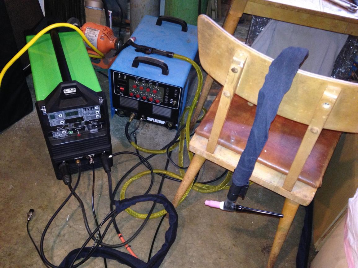

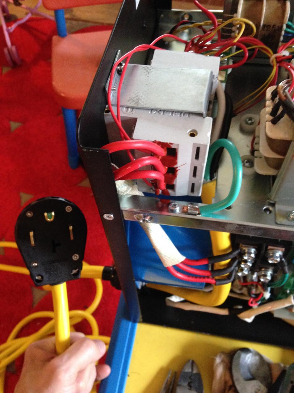

    I bought and used a 25' long 10-gauge power extension cord (http://www.harborfreight.com/25-ft-1...ord-66495.html) and a plug (http://www.lowes.com/pd_246879-1571-...amp&facetInfo=) to extend the 255EXT's power cord:
    Then I did a quickie argon connection to it to try a quick, low-temp arc (with the WP-18 that came with it) and the footpedal out. The good news is that it's alive! Here it is next to my 2007 Everlast Super200P ("old faithful" ):

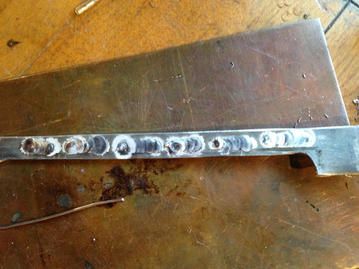

    It pretty much worked as expected for its first arcs, which were short and in 1/16" aluminum:
    I really need to get my higher power aircooled torch adapted to it (or get some watercooling solution figured out) before I can really explore anything more than a very small fraction of what this machine has to offer, though.
