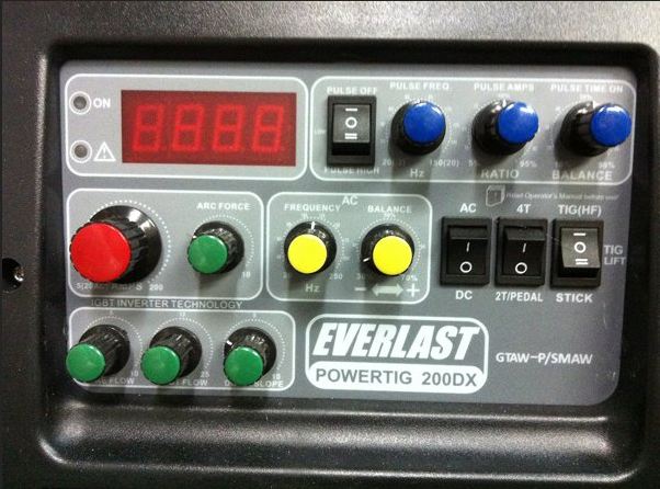

    We've been holding onto this pleasant surprise for a while and now are proud to introduce it.
    This PowerTIG 200DX has been updated late this year with the addition of preflow , panel control over max amps while using the foot pedal and offers increased pulse frequency up to 150 Hz. But most significant is the fact that the PowerTIG 200 DX is now available as DUAL-VOLTAGE! This will allow the unit to be used in almost any environment and increases portability . The output on 120V of course is reduced, but still gives adequate output to weld lighter gauge materials. And now, it has arc force control for serious stick welding with E 7018/6011.
    One thing about it, is that the new pulse frequency, and addition of preflow really targets the customer comments we have received. They have asked for it, and they have gotten it. This is one of the best packaged 200 amp welders you'll find for this price anywhere.
    PowerTig 200DX 220v - 1200.00
    PowerTig 200DX 220v/110v - 1350.00
Name:	200 DX 2013 panel.JPG

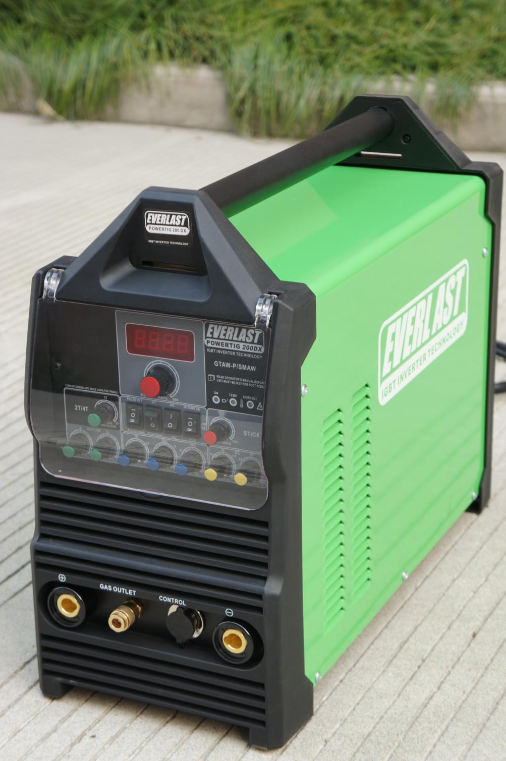

    NEw DX !
    Oleg Gladshteyn
    I like the new look of the 2013 it has a look of a more modern machines and user friendly also, some thought was put in to them, keep it up the good work Everlast.
