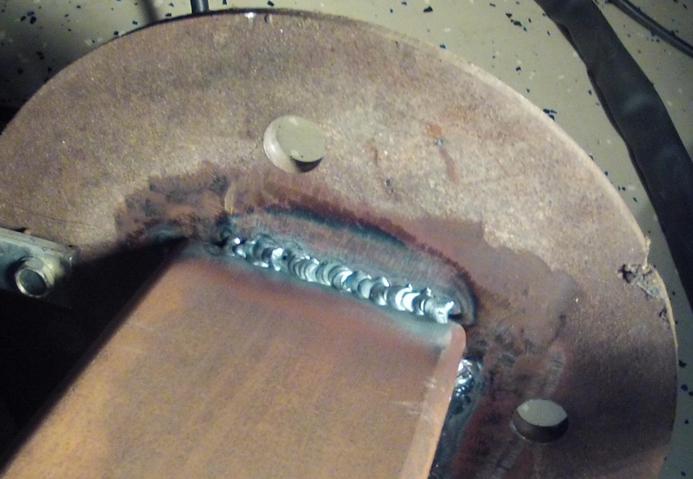

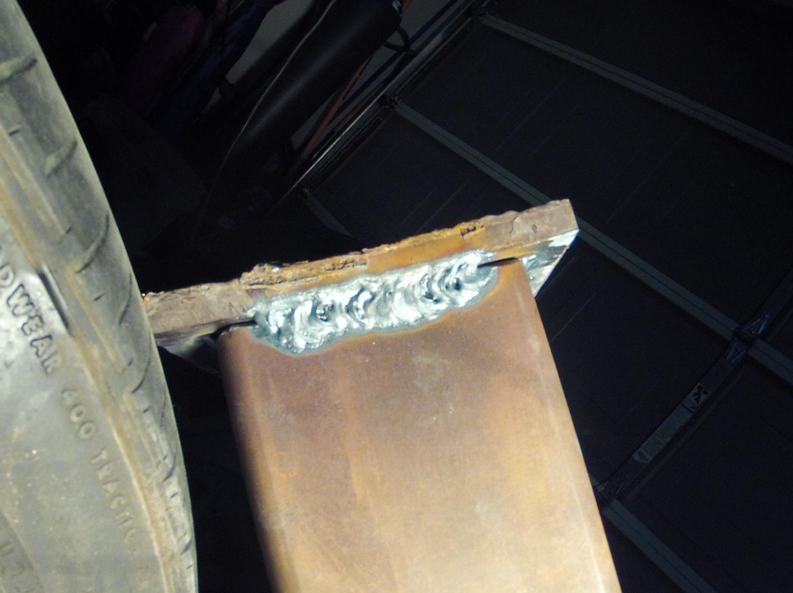

    Hey guys, sorry its been a while since my last update. Here are a few of the welded stand. I painted it up, but haven't had daylight to take finished pics yet. I'm going to try to install it in the back yard and get some pictures tomorrow with some daylight. The welds aren't great. They're 1/4" thick plate to 4 inch square 1/4" wall tubing. At 185 amps, its undersized but it stuck the two together so we'll see how they hold up. If it breaks I'll head over and borrow my friends 300 amp and really get some good penetration.
    A Bit of Preheat Work Wonders with a small Welder/Fire/Gas or Sun=use a candle as an indicator=if it melts its ready for welding
    Looks like your getting along OK with my old machine , Get some scrap material and try some different settings gas flow around 7 lpm ect. Purge the gun by holding the trigger or pushing the pedal when you are not close to the material to move the air out of the gas line. Then when you start an arc you have pure argon. That might be the porosity in the one weld or dirty steel.

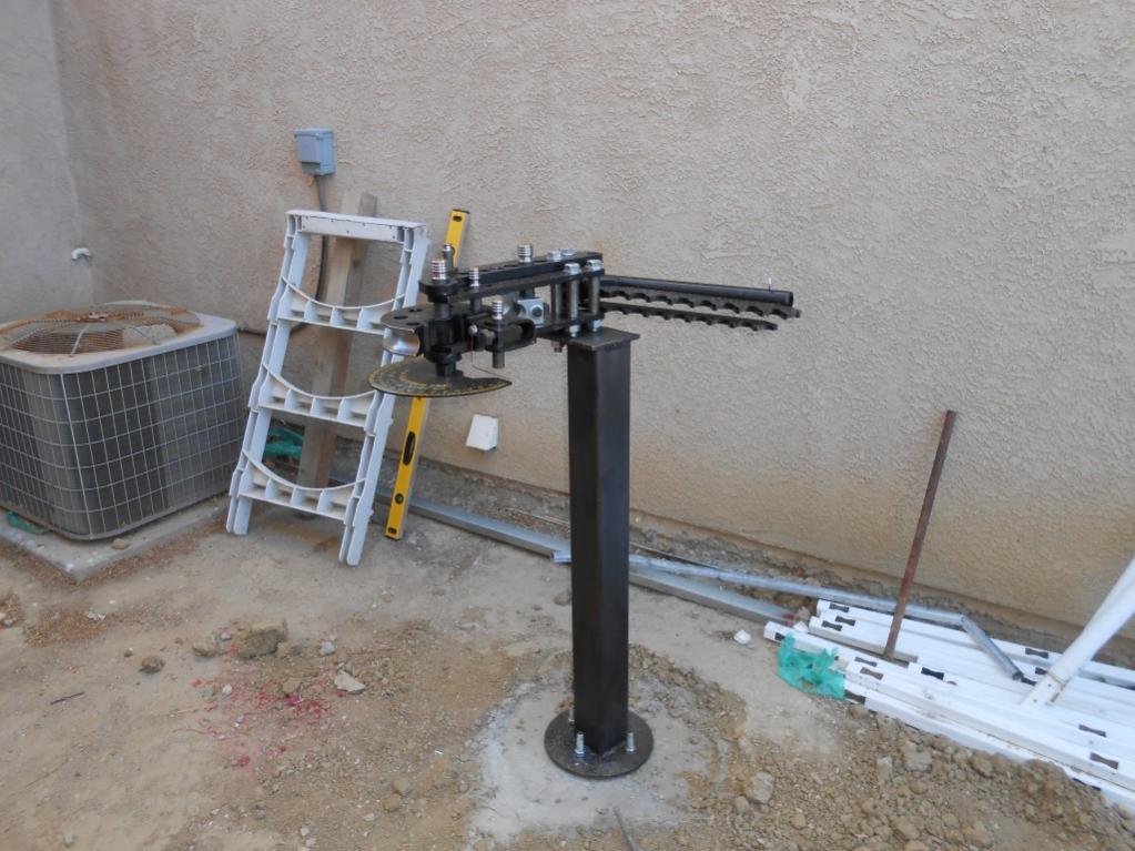

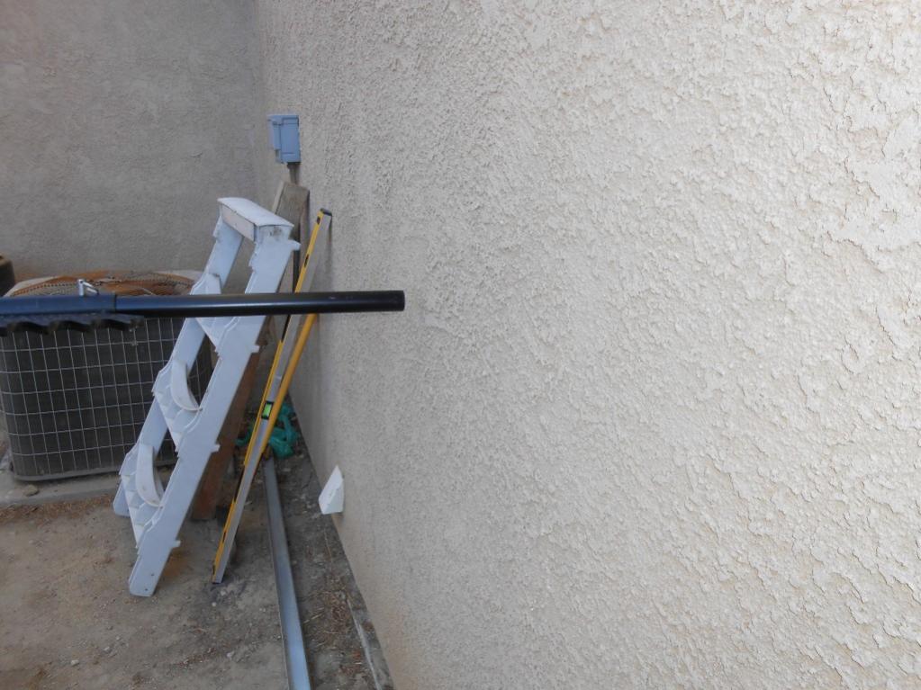

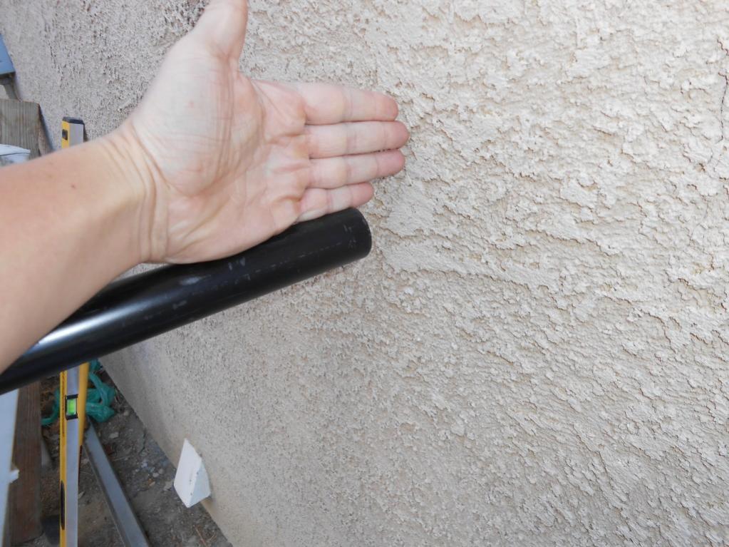

    Finally got some time off for the holidays so this is the final installed picture. Worked out perfect as the fully extended bar clears the house by about an inch or so.

    The JD2 is a great bender. I've built a few cages and loaned it out to several friends. Be careful with your mounting though, with 1-3/4, 095" tube, I use all of my 180lbs to make a bend. Your footing doesn't look very deep and may not have enough mass to resist your applied torque. You also need to look at your clearance to the wall when you have 10' hanging off one end and sweeping though the arc. I put four RedHead inserts in the middle of my garage floor and just unbolt the base between projects.
    Good luck!
