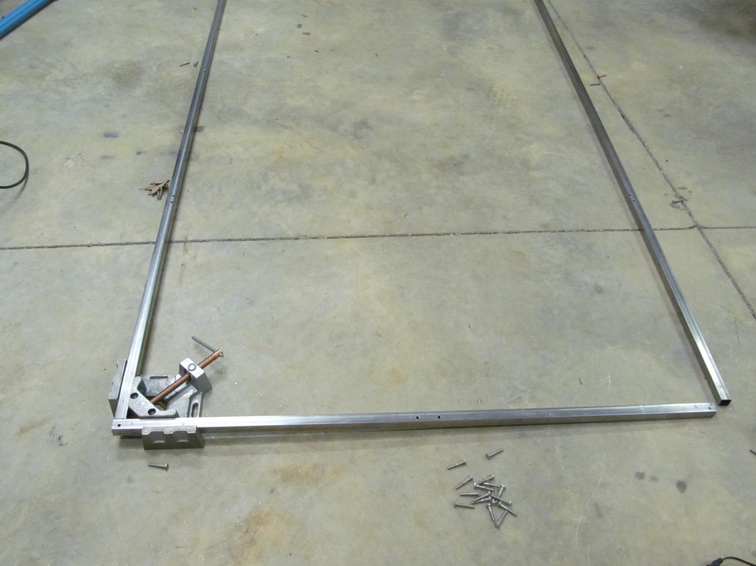

    This is a fun one. I am building a custom roof for a 6 seat NEV car..... AKA a limo golf cart.
    The original fiberglass roof will be removed and 8 - 60watt solar panels will be added. The plan is to add an inverter so the cart can be used as a solar generator in a power out situation. I may also add a small grid tied inverter so any excess power can be feed back to the grid.....
    The original roof was held on with 1" square tubing so I will be building another frame out of 1" square tubing to match.
    I picked up the metal at lunch today and will be cutting it this afternoon.... pic's coming soon.

    Nope steel 1x1x 16awg. Aluminum would have been better (lighter) but cost too much.
    The car(t) is a Star 48-6L

    Here are some pictures:

    Have you gotten a chance to take it out and about? Wondering how fast the solar panels charge the cart... Could it keep them charged all the time?

    I'm still working on the wiring.... but have took it for a spin with the panels on top. It drives the same as the fiberglass top (not much more weight with the panels). As for keeping the cart charged, no. The panels will provide a little over 7 amps. At cruise the cart draws around 60-70 amps if I remember correctly. I have a programmer coming tomorrow to speed the cart up and will take measurements.
    Increase in range was not the goal of this project. but should yield 10%+, That is if you just drove it as far as it would go. If you stopped along the way, you would get even more.
