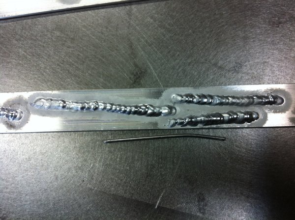

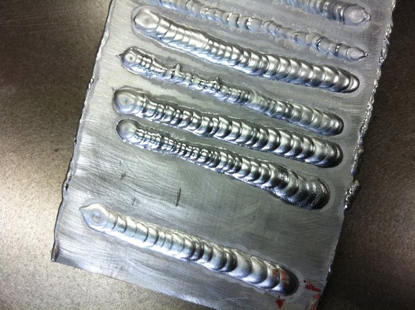

    Here is a practice piece on 1/8" aluminum plate around 150 amp using pedal to lower once I got it going, using 3/32 Lath Tungsten, #7 gas lens cup at 15cfh argon. 110hz at 30 balance. I am starting to get the hang of feeding rod into the puddle.
    The second one is 1/16" aluminum plate around 65 amp lowering as I go with the pedal. I have tried both 3/32 Tunsten and 1/16" with pretty much the same frequency and balance as with the 1/8". I also notice the sputter sounds more like it stops and go really quick.
    BTW the lower I decrease the amp with the pedal the more it would sputter?
    Well am out of argon now and I am hoping maybe a chance it will fix the problem with a tank swap at the LWS. It could be an argon issue as I did not have this the first week I had the machine. So I don't know if it is the machine just acting up or I have introduce a problem.

    I got a new tank of argon and my problem went away. Maybe I was at the bottom of end of the tank. How far do you guys actually tig untill you think its time to refill or exchange the tank?
    I still had 250lbs showing on the tank and getting constant 15 CFH when I was having the stutter.

    There have been a lot of calls that resulted in bad argon (moisture). You can add a desiccant filer on the output side of the regulator to help. Jody over and welding tip and tricks did a video on a DIY unit. Search the forum for desiccant or dryer and you will hit a lot of threads.
