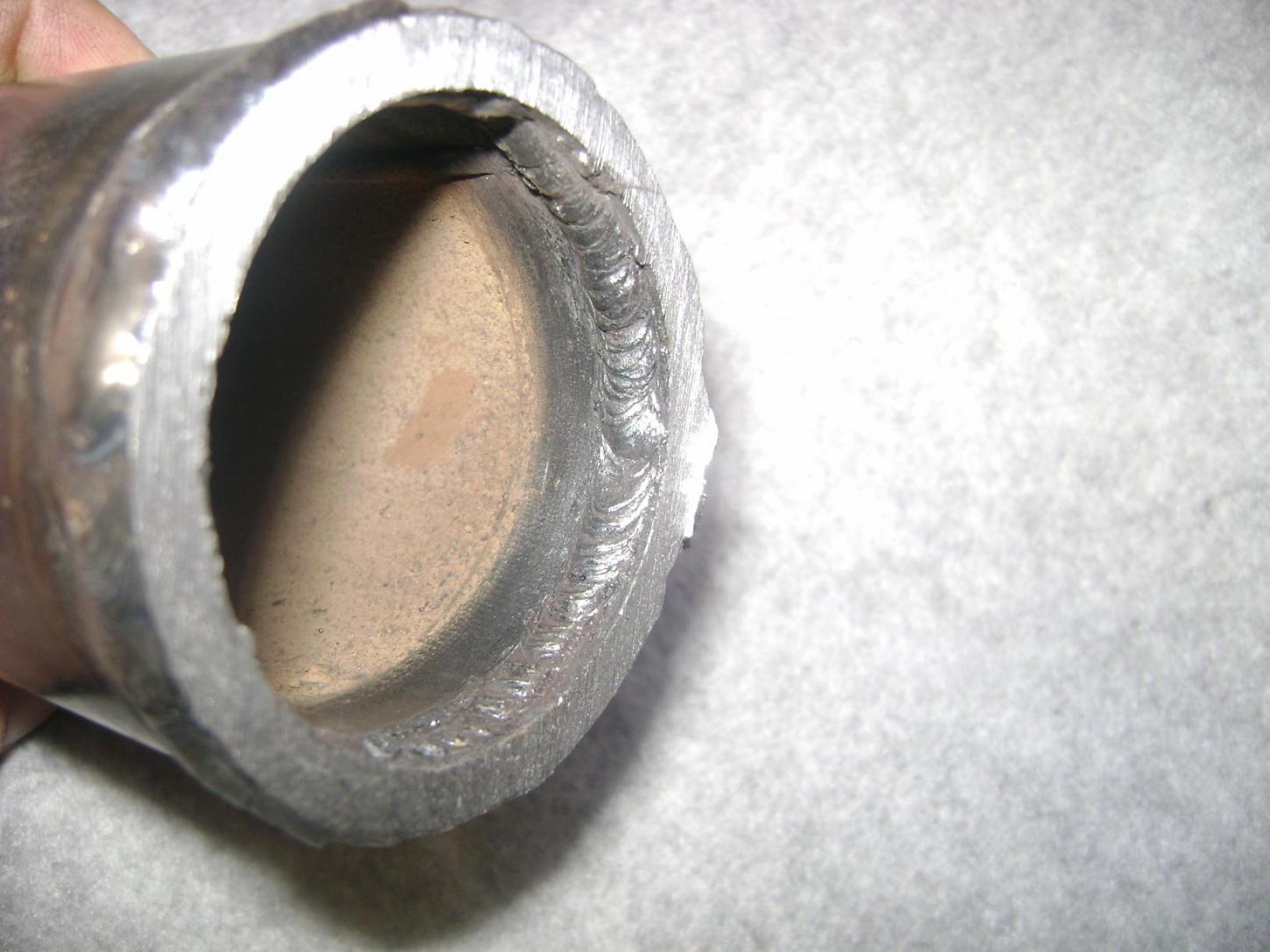

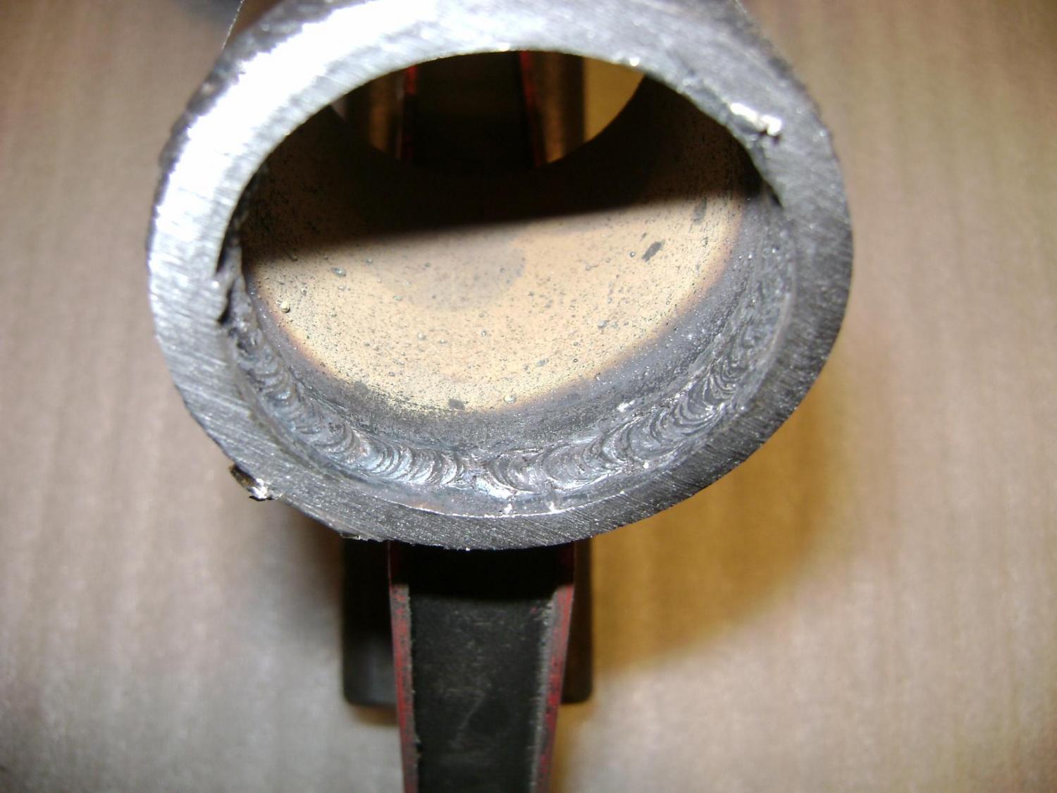

    Things I learned when I got my PA-200, it really loves ESAB rod! 7018 = Atom Arc, 6010 = 10-P, and 10P-Plus. When it comes to 6011 it really likes Hobart's 335A.
    Here some pictures of some pipe welds I did when I first got the PA-200.
ID:	8494   Click image for larger version.
ID:	8504   Click image for larger version.
ID:	8505   Click image for larger version.
