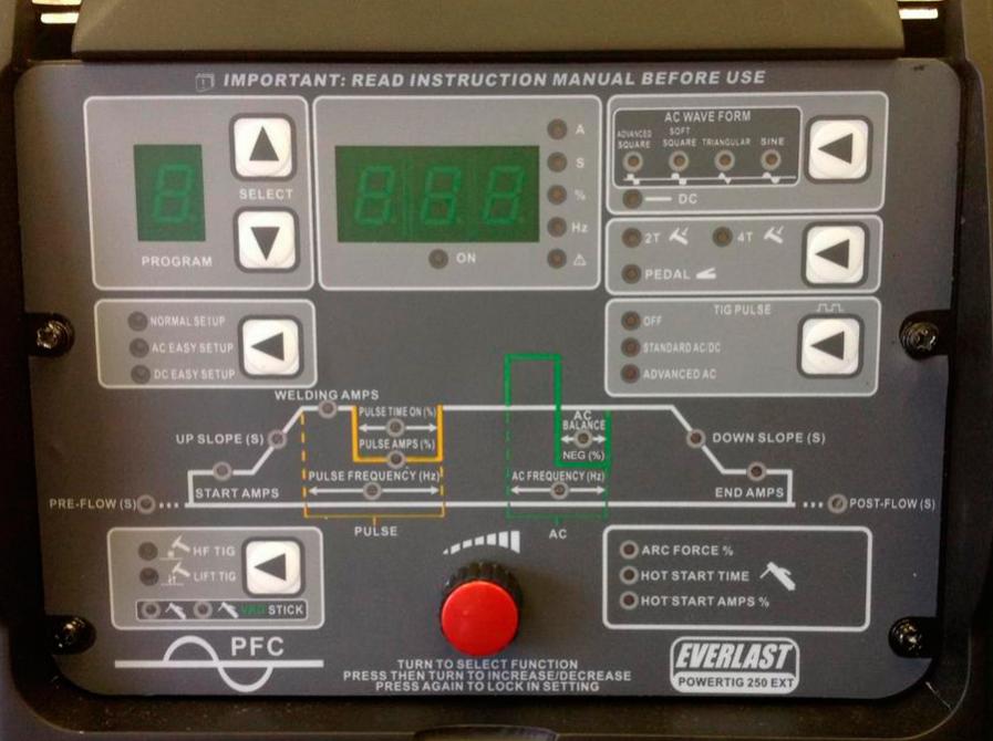

    What is the "VRG" (if my eyes are seeing that right) stick mode?
    Hate to shoot holes in the "intuitiveness" of the panel right off the bat, but regarding the AC balance, the panel graphic contradicts itself. Will the number displayed match the wording of "CLEAN(%)" i.e. EP% or will it be the EN% as depicted by the LED/arrow in the negative half of the wave?
    I do hope the testing includes a thorough check to make sure that the programming matches the user interface. That was one of the things on the original machine that caused me, as a TIG n00b especially, a great deal of confusion and frustration.
    VRD = Voltage Reduction Device, lowers voltage for open circuit when stick welding. A safety feature required in some places.
    Agreed the graphic and wording do not match that well for AC balance. Should be an easy fix with a different printing, or LED relocation.

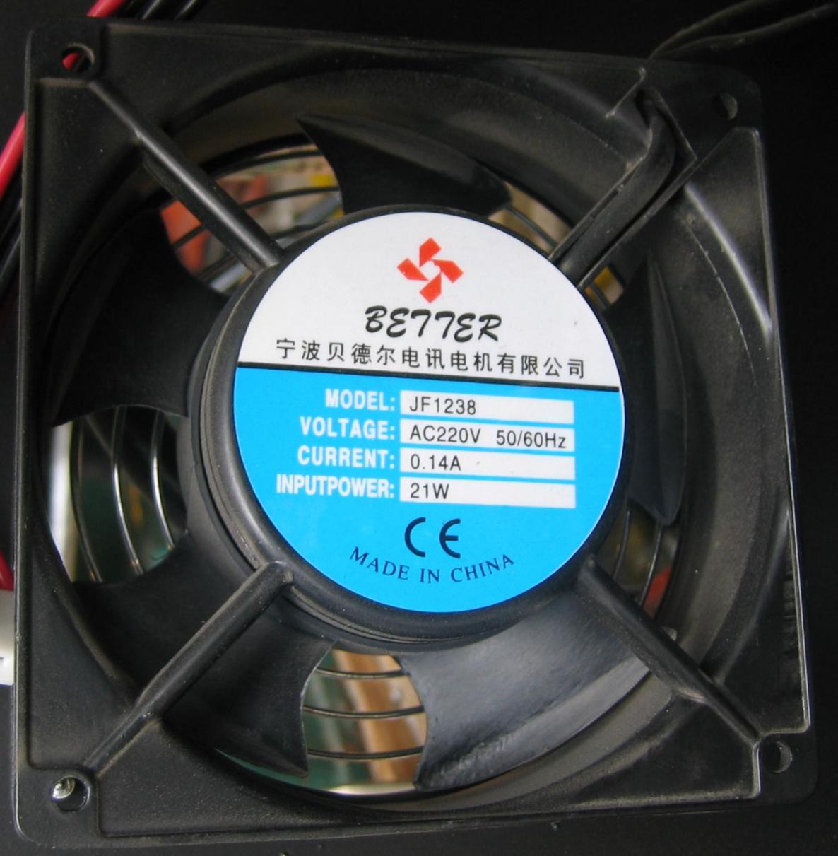

    Thanks for reading and considering my "wish list", Mark, and for some additional info on some of the specifics. Obviously, with the prototype already constructed, and a timeframe already set just a few months away, I wasn't expecting you to make any major changes. However, please at least file the wish list away for the next version of machine (if and when that happens) after the 255EXT.
    Regarding the cooling fans, you imply that noisy fans are necessary for high duty cycle, however this is not the case. Case in point: my 2007 Everlast Super200P achieves 200amps @ 60% duty cycle with two relatively small fans (about 4.5" diameter for the rotating assemblies) which are not that loud, yet (subjectively) seem to move a lot of airflow and pressure. I wonder if they do this by having better blade aerodynamics than the fan currently being used in your IGBT machines. In case you want to do further investigation, here is a picture with their manufacturer and part number listed:
    Also, a while ago, I picked up a surplus 240V "comair rotron" fan with very impressive airflow and pressure output, that I have used to bring my air compressor up from a rather pathetic performance up to a reliable, full 100% duty cycle. The diameter of the fan blades is about 5.75", and the overall dimensions are about 6"x6.25"x2". It also seem pretty efficient for how loud it is for how much air it moves. Let me know if more info about it would be useful.
